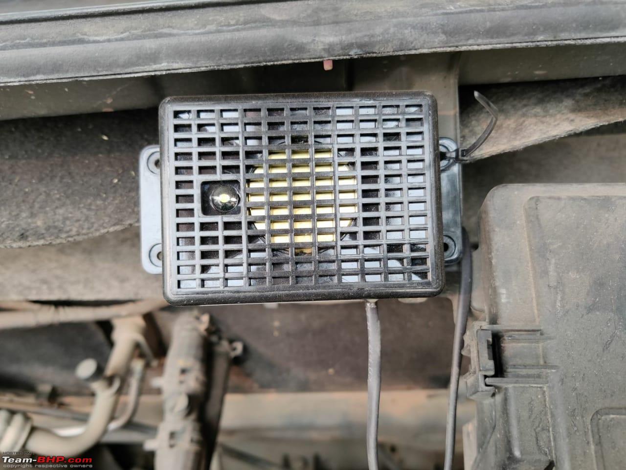

I don't know the technicalities of the matter but it shows what kind of a disaster rat damage could ignite. I had faced a similar wiring problem due to a rat attack in the past. Just to have peace of mind, I installed a rat repellent device called "Car Cat". From the day of installation, I haven't faced a single issue and neither any rats have sneaked into the car. It uses ultrasound waves to keep the rat away and gets connected directly to the battery. It demands a good investment, to begin with, but in the longer run, it pays off!Rat damage to cars | Protection, solutions & advice-img_20200913_181948.jpg
I am genuinely impressed with its efficiency. I have it installed in two of my cars - Renault Kwid and Toyota Glanza. Both have had some amount of damage because of rodents. The Glanza's floor mating was worn out due to rats. Since the installation, both cars haven't faced any rat attacks. Also, it doesn't consume a lot of battery. You can easily park your car for 10-15 days but it is recommended to start the car and take a short spin for better battery life. I am leaving a link of the Car Cat device, in case any one of you want to take a look.

How long have you had this in your car? Also for installation do someone from their staff comes in for setting it up or we have do it for ourselves. I have read online that after some time the rats get used to sound etc and tend to re-appear.

FYI the link isn't opening. Upon Googling, it says 4104 INR which I feel is a bit steep. I found another one named Rat Attack. Costs 2490 INR. I'll try that. My friend had used Varna Surakshaa, but he said it is not of great quality. He bought about 5 of them and 3 stopped working and had to do multiple follow ups to get a replacement units.

Do ultrasonic repellers work on rats?
The short answer is no, ultrasonic rodent repellents don't work. Some homeowners have noted an immediate effect at first, but over time the rodent problem will continue to persist.

Please do not invest in ultrasonic rodent repellent devices, they don't work.
Do not waste your hard earned money on scams, companies selling ultrasonic rat repellents have been sued in the US as there was no proof to support their tall claims.
Quote from a blog :
As early as 1995 a study was completed at the University of Lincoln, Nebraska which concluded that in all devices tested they were insufficient in repelling rats and other rodents. [“Electronic Rodent Repellent Devices: A Review of Efflcacy Test Protocols and Regulatory Actions”. DigitalCommons@University of Nebraska – Lincoln.]. Consumer Reports has also put out a warning against such devices. [https://www.consumerreports.org/inse...cts-to-avoid/]
