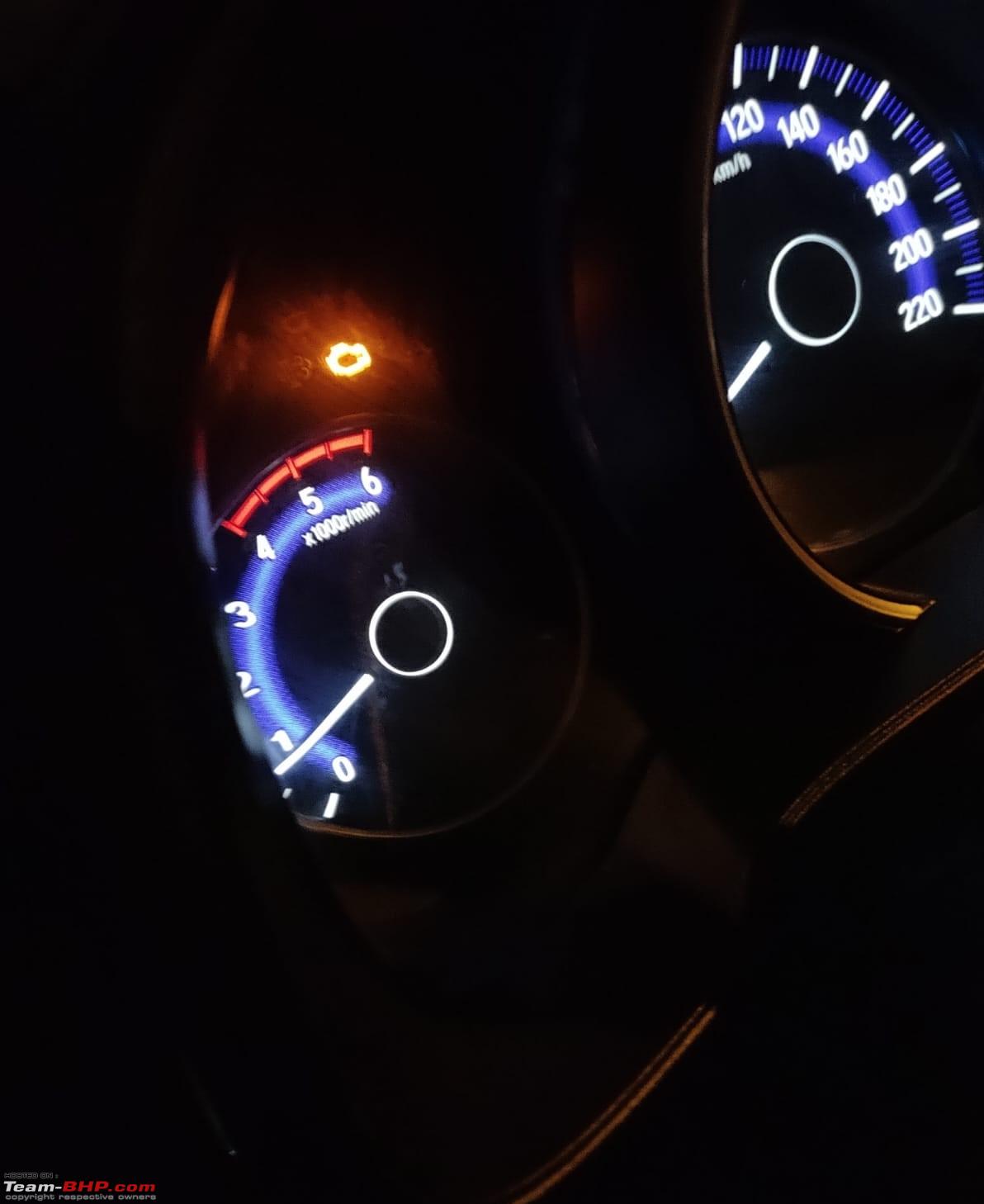

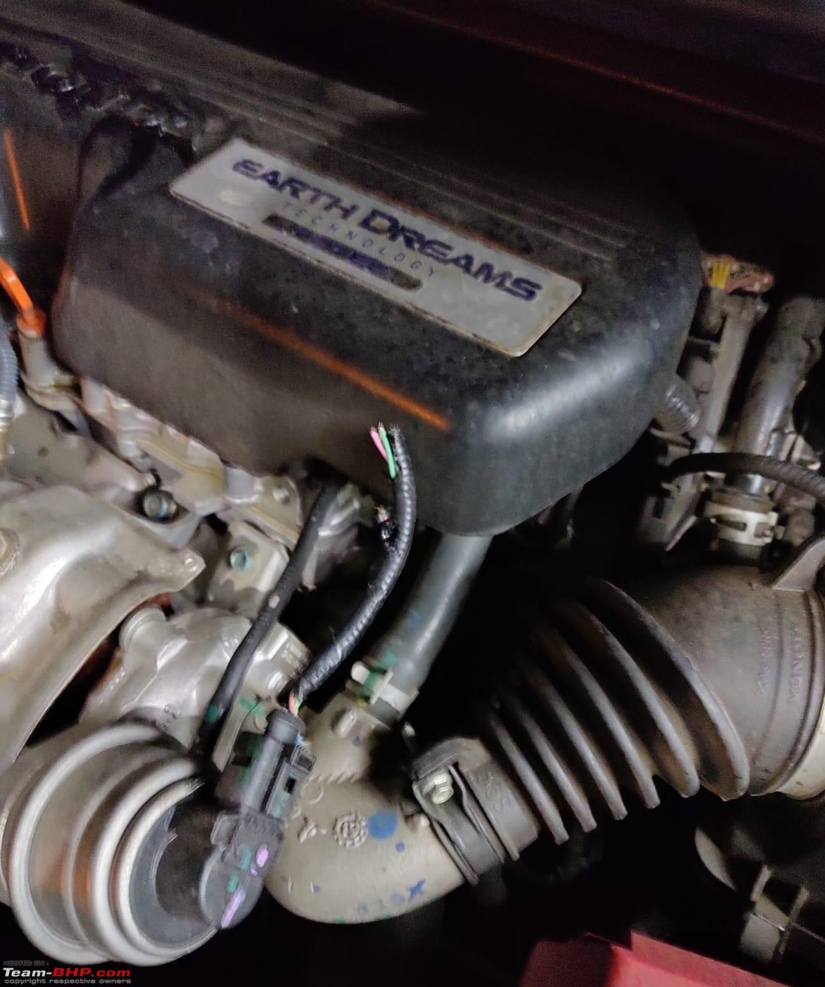

Hey guys,
Posting this on behalf of a friend who owns a Honda WR-V. It is the facelift model of the WR-V bought in 2021 with a Diesel Engine. Now the story goes as follows.
They were coming back from a function and were driving near the Sompura exit (Bangalore) when the vehicle speed suddenly dropped and it refused to go on further. Minutes before this, the check engine light had also come on.
Rat damage to cars | Protection, solutions & advice-whatsapp-image-20230303-7.06.09-pm.jpeg
Upon opening the hood, they found that the wire that links the turbocharger to the ECU has been bitten apart by Rats.
Rat damage to cars | Protection, solutions & advice-whatsapp-image-20230304-9.50.01-am.jpeg
Due to this reason The Turbocharger was not able to connect to the engine and it did not know when to kick in. After this they faced a series of problems, including :
1) ABS stopped working.
2) Dual tone horn reduced to only 1.
3) Vehicle went into Limp Mode (Won't cross 60km/h)
Upon sending the details and pictures to Dakshin Honda Bengaluru, they quoted 20k for all the repairs. Is this a fair price for a problem like this?
Please do give your valuable suggestions.
Thanks in Advance.
An ASC will always recommend replacing the affected harness to ensure fool proof operation in the long term.
Depeending on how the wires have been cut you could buy some wires of the same colour and gauge (of say 9-12" lengths) and if you're comfortable using a soldering iron just solder the new wire ends to the harness and the connector following the colour code at all times. Use a shrink wrap to insulate the assembly at the new soldered joints and then wrap it with insulation tape or a black flexible conduit to make it look like the factory harness. An auto electrician could do this. This is a cheap method and does not offer guarantees of normal behavior or performance. But you can take a chance.
There's a thread on here where a Toyota owner did a DIY to an engine harness chewed by rats.
R2D2 is offline   (4) Thanks
