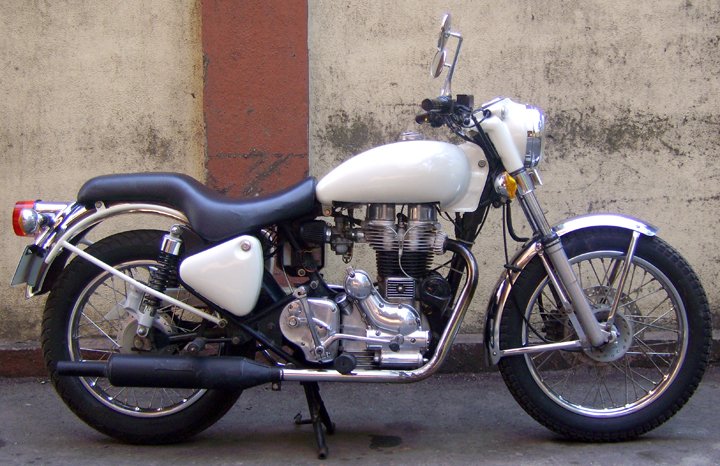

Join Date: Mar 2007
Posts: 36
[quote=Gordon;383531]Hey Dimali,
Could you post some pics of your bike. Do Automech make free flow exhausts for bikes too? Where and for how much did you get the Dunlop tyres for? Are they available in 3.5x19.
Gordon,
Some pictures...
The Dunlop was sourced from Metro Tyres, next to Alibhai Premji on Lamington Road for about Rs 1500. I'm sure they will have a 3.5X19 matching rear tyre in case you want to fit it up front.
I'm also in the process of doing up a 1997 RE Citybike 500cc as a tourer. Will post pics and progress soon
Dimali is offline

Originally Posted by Gordon View Post
Some pics of the BSA light :
The chrome would be painted black + black screws would be used.
Nice! I found an interesting tail light set-up that you may find useful
What bracket are you going to use?
