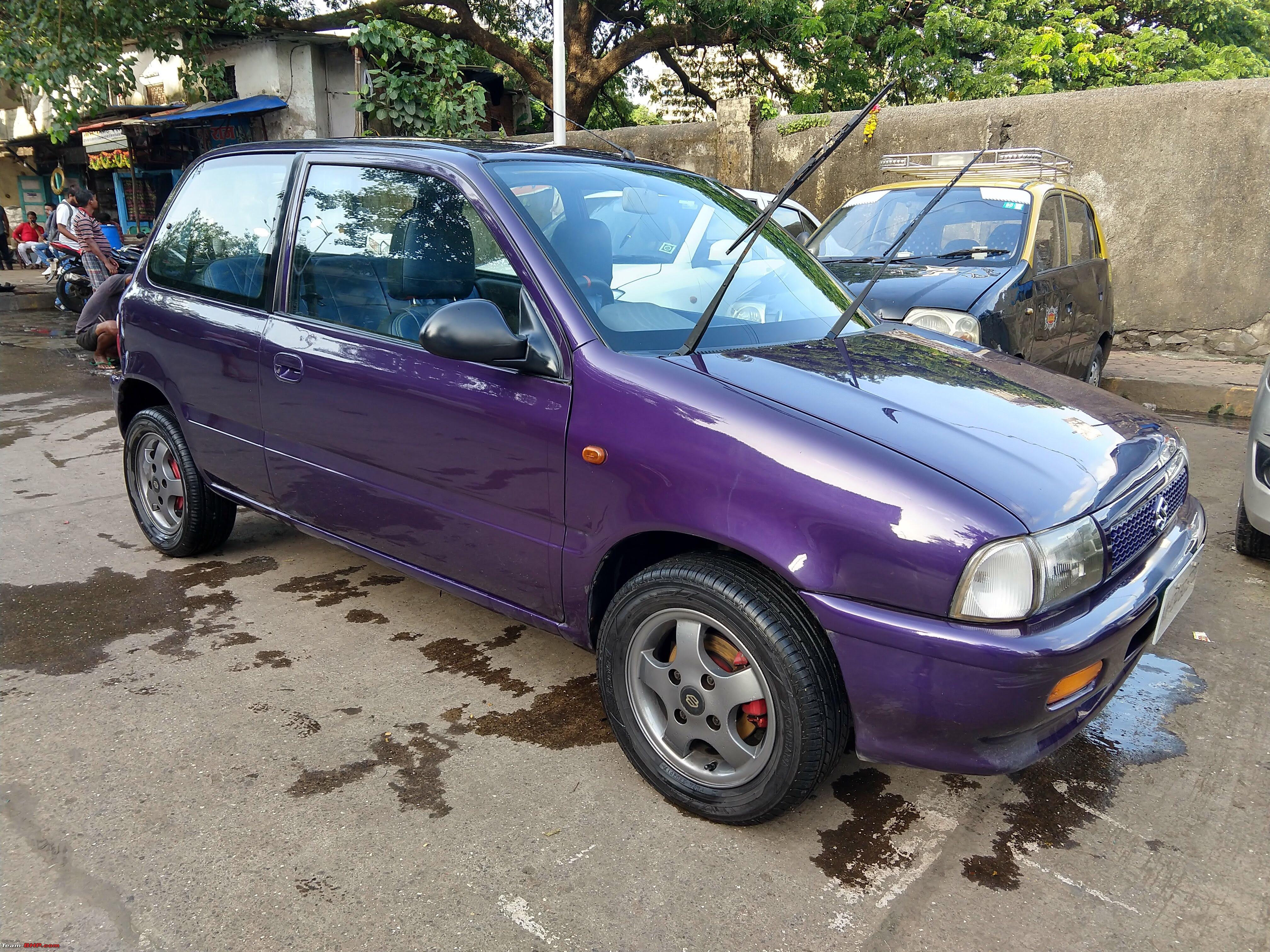

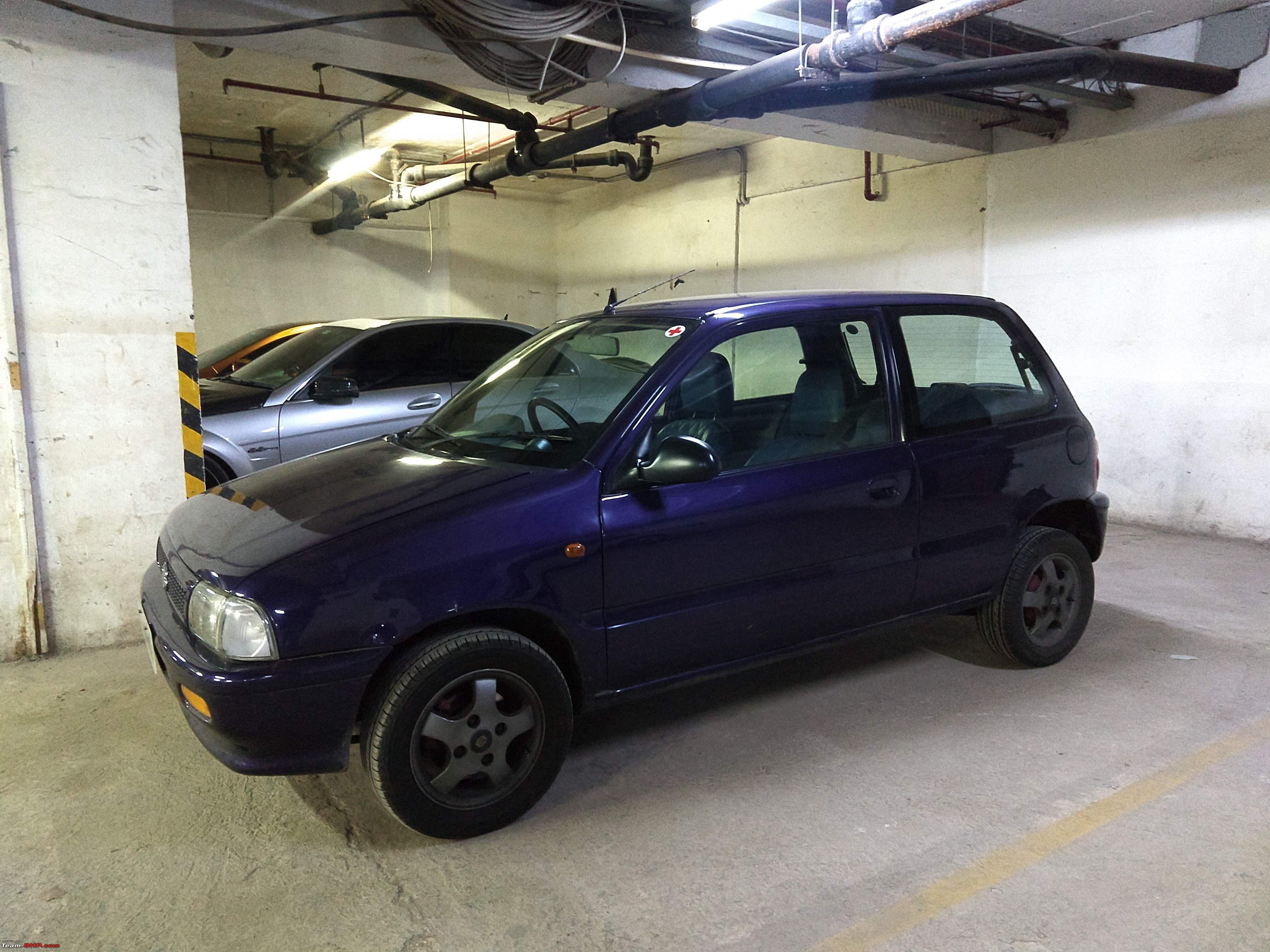

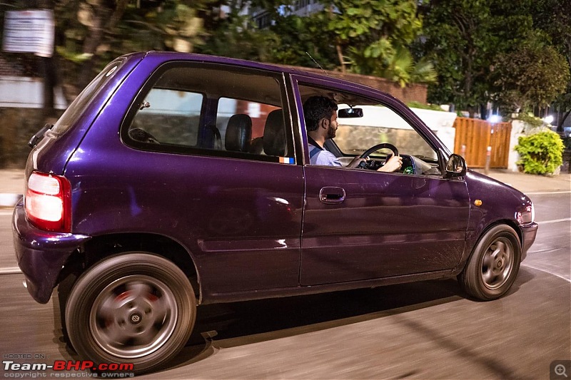

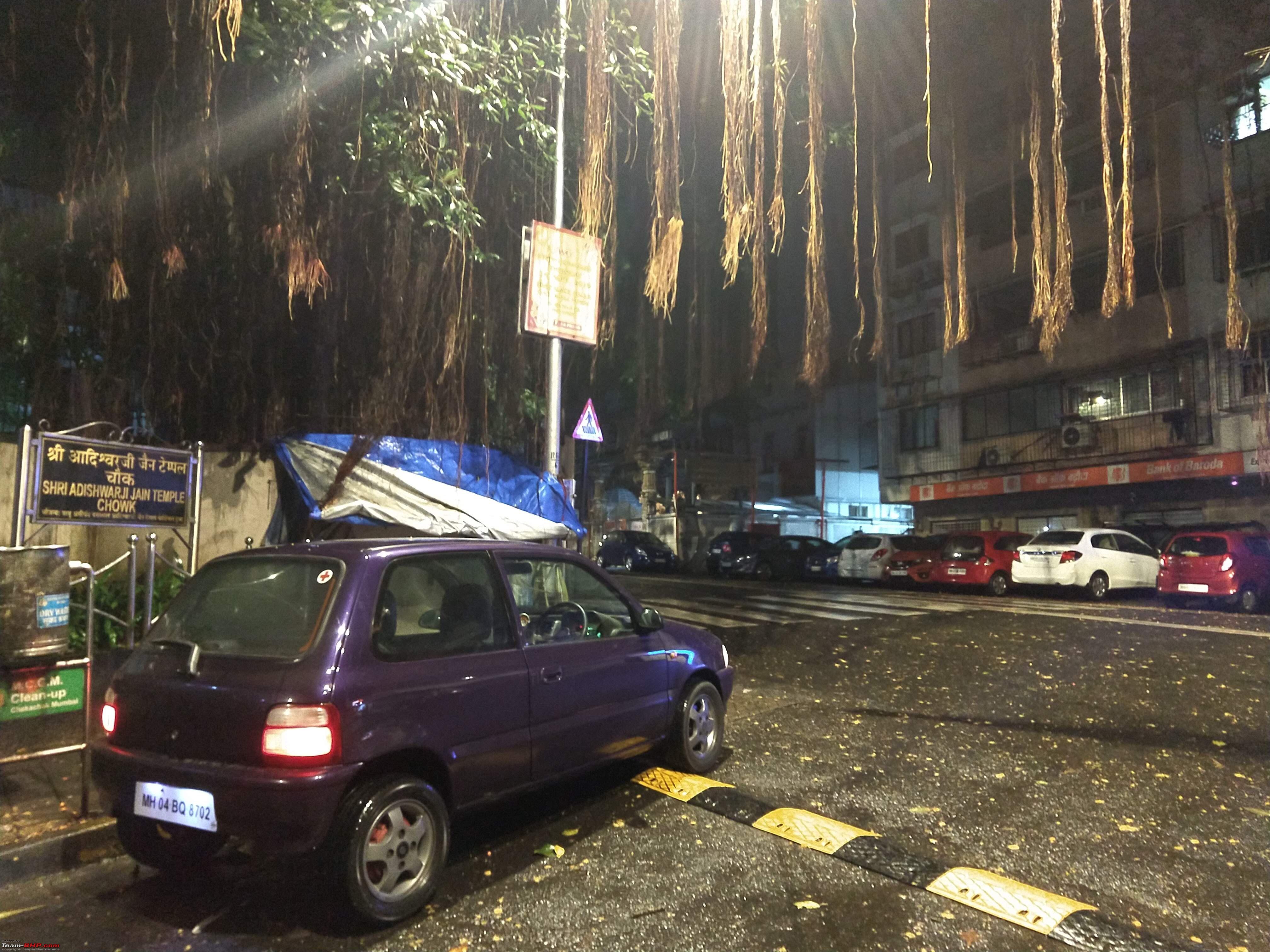

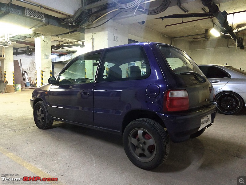

I happen to be one of those people who simply does not care about features or creature comforts in a car. To me everything comes 2nd to the experience one gets while driving a certain car.
Zen Carbon. B-Zen
G16 Baleno engine, ecu + gearbox swap
Highlift Camshaft upgrade
0 Slip Clutch
Automech Full system exhaust
K&N intake
Interiors wrapped in Kahn Design leather
Zen D Shocks
Re-Inforced chassis
Automech Strut bars

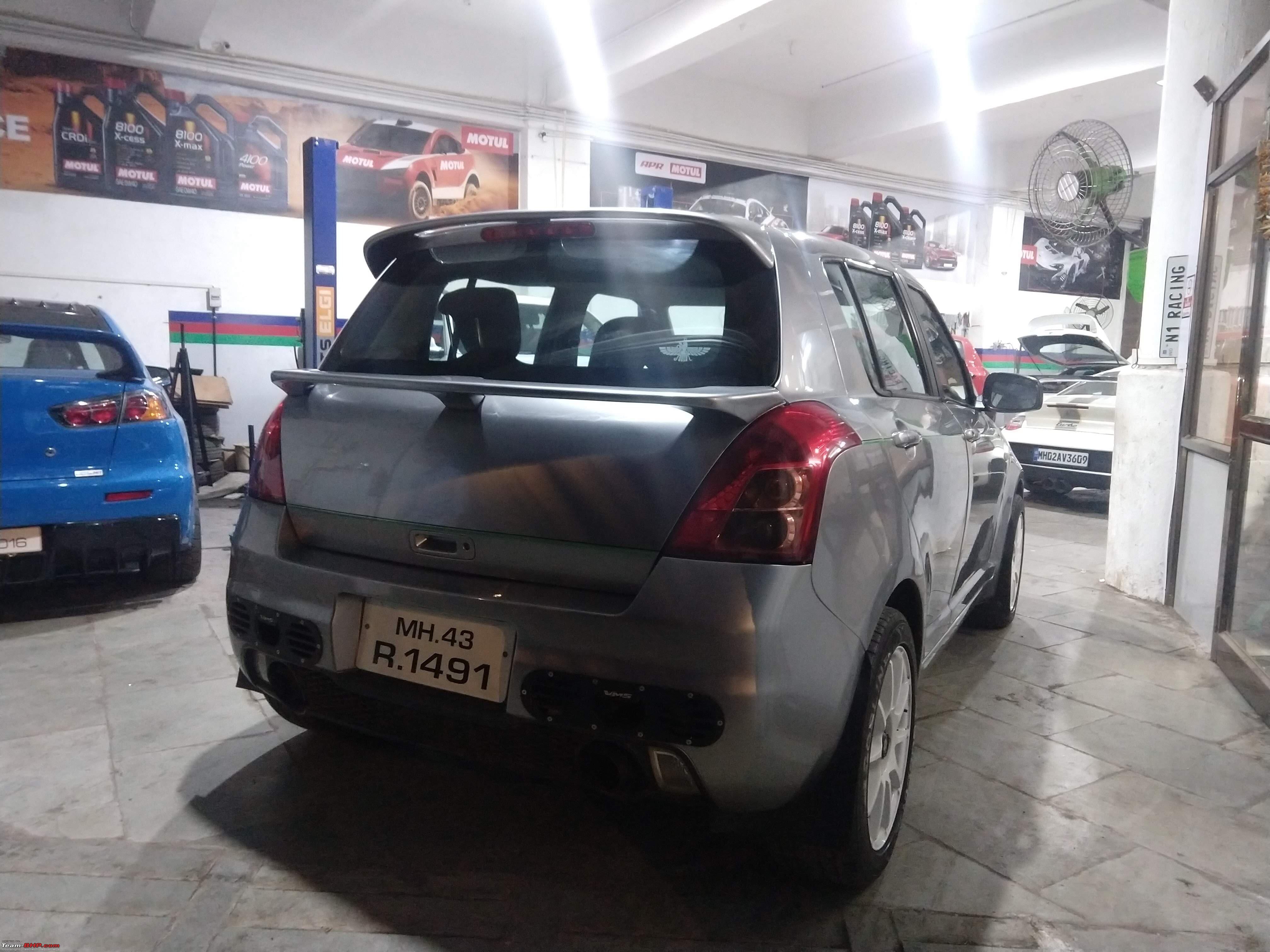

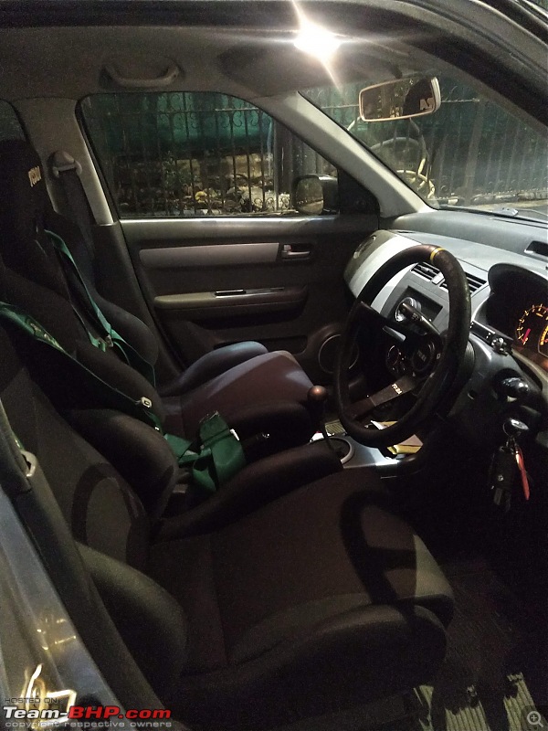

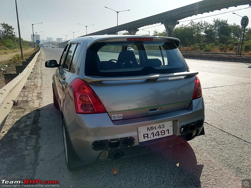

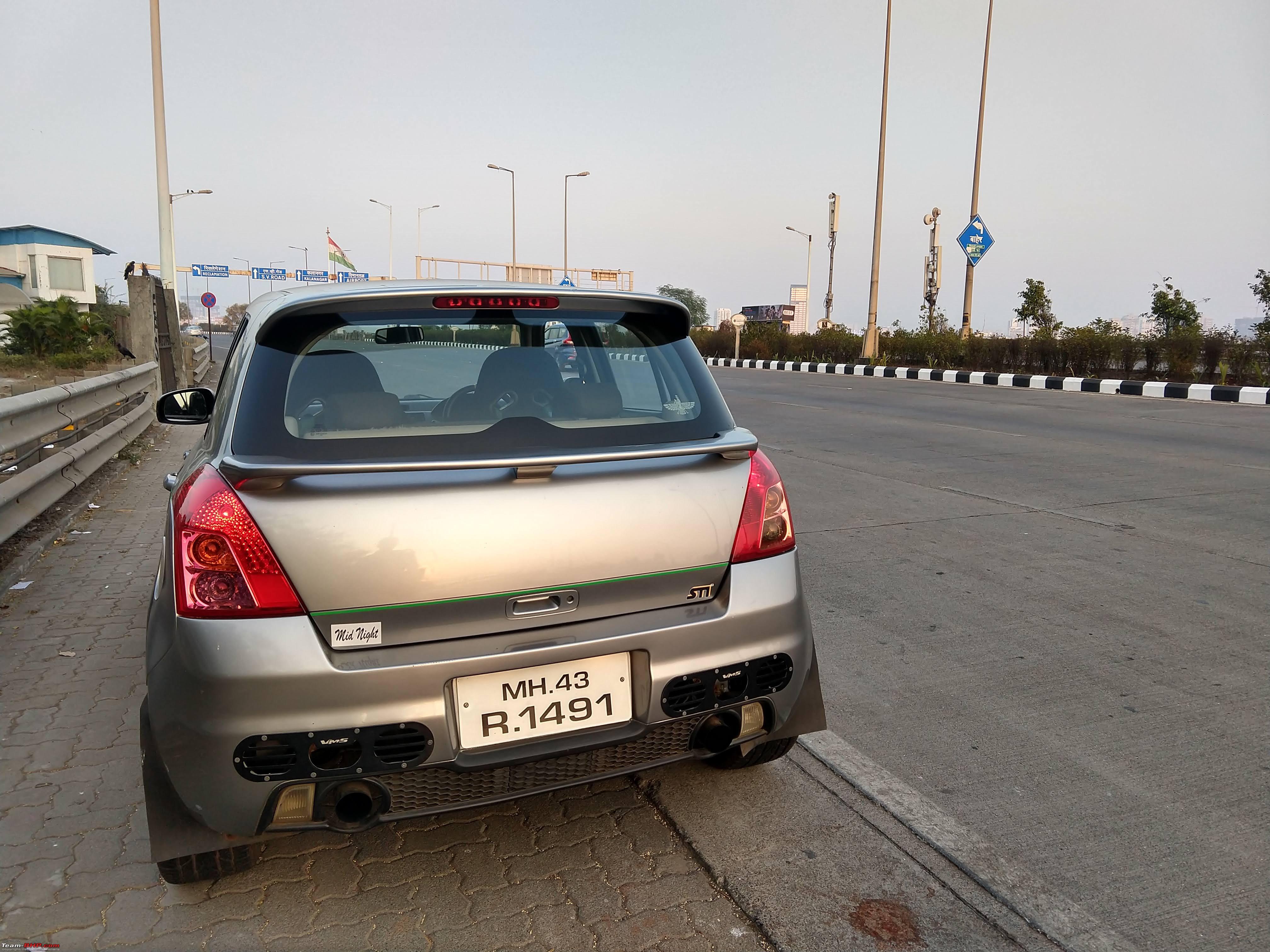

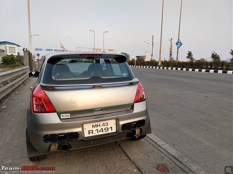

A small city cruiser/bruiser. If I were to describe this car in one word that would be effortless. It's very simple to drive so much so even my mum often takes it to work and back. At part throttle it feels no different from a stock Zen carbon to drive and thanks to the nice seats is very comfortable as well. In any gear at any speed press the loud pedal a little more and an absolute hooligan is unleashed. Anything more than half throttle this car is an absolute beast, you feel the front end lift up on every upshift accompanied by an occasional pop from the exhaust system. Floor it at a stop light and you'll just stand there for a good second surrounded by smoke from the endlessly spinning tyres. Launch it right though and the speedometer barely manages to keep up and after a certain speed becomes very inaccurate and then just gives up completely. Having one of these cars had been a long time dream and this is exactly how I imagined it to be, can't think @salilpawar1 for giving me the it's now or never pep talk . This car is very bi-polar one can usually find me driving well past midnight on the empty streets of south Bombay and this is one car that is equally fast as is it comfortable at 3AM as it is at 3PM.
Turbo Swift/Goblin
Haltch Sprint ECU
Forged Pistons
Garrett GT20 Turbo
Turbo Intercooler with full Silicone Plumbing
Custom Twin Exhaust
Exedy Stage 1 Clutch
Fidanza Performance Flywheel
Tien Superstreet adjustable Suspension with Electronic Damping Force Control (16 settings for front and rear independently)
Original Suzuki Swift Sport front and rear bumpers
16" Sparco Assetto Garra Wheels
D1Spec 6 pot Big Brake Kit up front (320mm slotted rotors)
Toora adjustable Race Seats
Takata 5 Point Race Harness
Toora Deep Dish Race Steering Wheel
Defi Boost Gauge

Some people might recognise this car as the Goblin swift, the infamous acid green swift that was built close to a decade ago. This car on the other hand is out and out thoroughbred race car. One has to be strapped in the clutch is grabby and takes some getting used to there is no radio there is no ABS, this is one car that demands your full attention while driving. This car takes some getting used to and can't be driven by just about anyone like B-Zen. One must get to know the car to get best results. You have to be very gradual with this car you can only floor it at the right time in the right gear. Not doing so only leads to something breaking as I learnt on only the 3rd day of having this car. (She completely shredded 2nd gear going up walkeshwar slope). All in all this car is very very quick and supremely well balanced. 6 piston brakes stop this car on a dime along with the trick suspension that is very very comfortable yet keeps the car stable one can take corners at mind numbing speeds with ease. Although this car unlike the Zen is very annoying to live with on a day to day basis, one can barely move once strapped in the clutch is very grabby and in traffic she tends to run very rich. This car is purely a point A to point A car.
