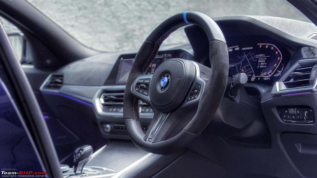

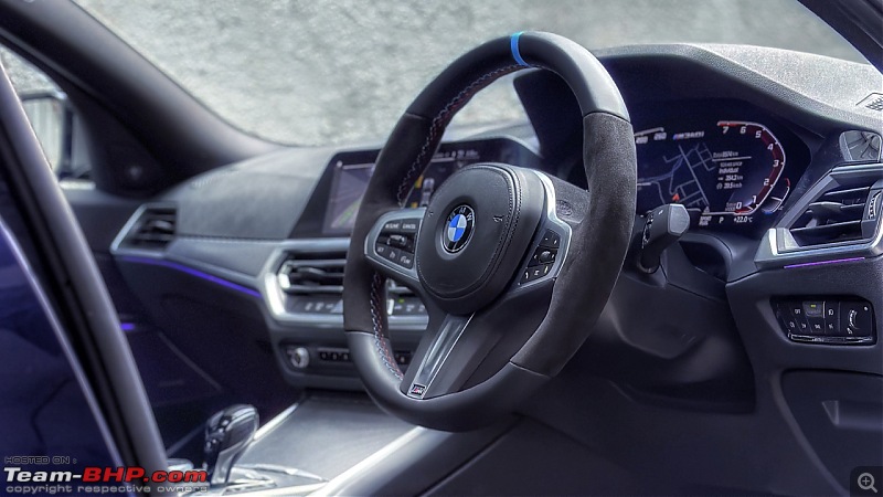

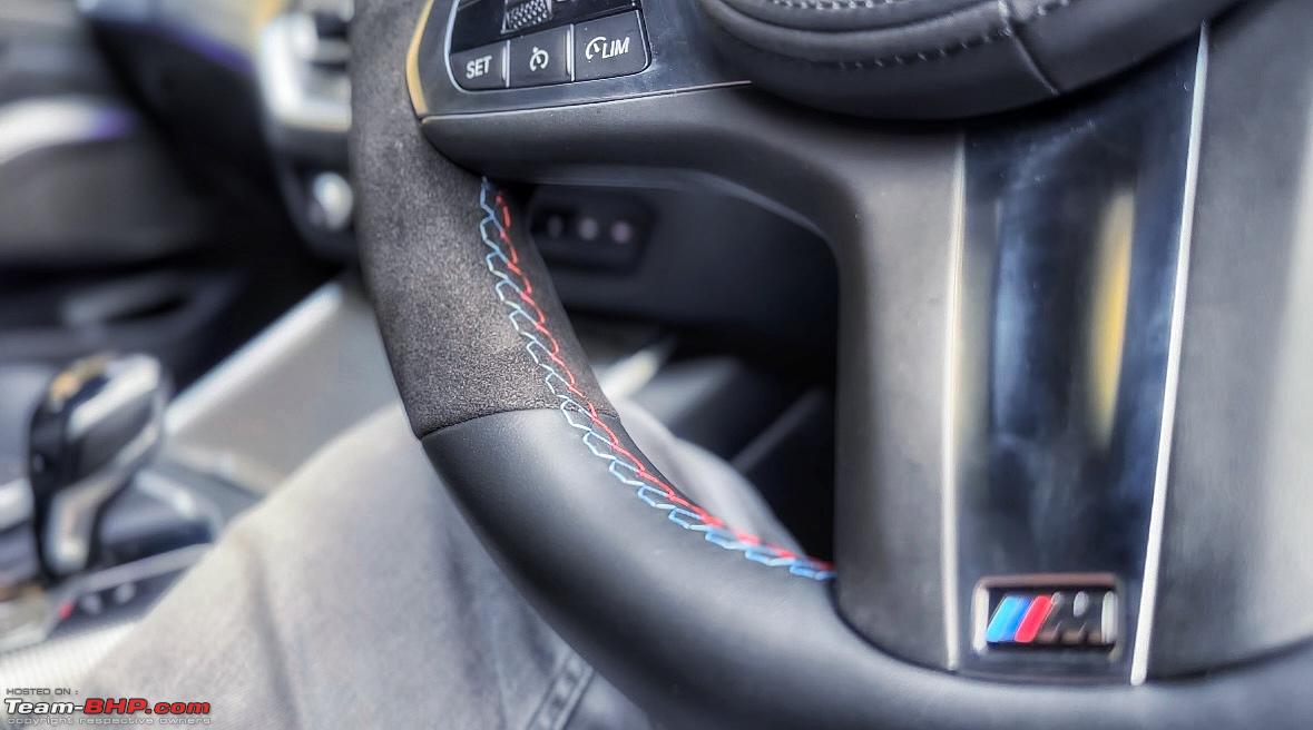

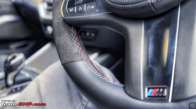

Installation;
When I was ordering the part i.e. M3/4's M Performance Steering for my M340i this part no. (32 30 2 462 910) did not show its compatibility for M340i, but with the shape being same I did not understand why it couldn't fit. Hence before ordering I cross checked the Airbag part no. & found out both the M3/4 & M340i use the same airbag (Same part no.) hence that gave me confidence to go ahead ordering this part. However, BMW Navnit Motors wasn't confident about attempting this retrofit hence the installation was done at BMW Infinity's, Turbhe workshop so special thanks to BHPian & friend Maverick5490 for his support & assistance because this is the 1st such install in India
Some close up shots of the new steering wheel before going in;
Installing the BMW M3/4 (G8x) M Performance Steering Wheel on my M340i-screenshot-20230312-2.36.36-pm.png
Installing the BMW M3/4 (G8x) M Performance Steering Wheel on my M340i-screenshot-20230312-2.36.26-pm.png
The Airbag / Horn pad coming off;
Installing the BMW M3/4 (G8x) M Performance Steering Wheel on my M340i-screenshot-20230312-2.36.59-pm.png
Both the steering wheels side by side before the child parts from the old steering go onto the new one;
Installing the BMW M3/4 (G8x) M Performance Steering Wheel on my M340i-screenshot-20230312-2.37.20-pm.png
Installing the BMW M3/4 (G8x) M Performance Steering Wheel on my M340i-screenshot-20230312-2.37.38-pm.png
Installing the BMW M3/4 (G8x) M Performance Steering Wheel on my M340i-screenshot-20230312-2.38.09-pm.png
Transfer complete;
Installing the BMW M3/4 (G8x) M Performance Steering Wheel on my M340i-screenshot-20230312-2.38.17-pm.png
^ As I already explained in the video as there is no Carbon Fibre interior trim in my car hence i did not order those CF child parts. The previous steerings Aluminium finish child parts were refit to maintain continuity to match the Aluminium Tetragonal trim, dashboard, door trims etc. of my car's interior.
Installing the BMW M3/4 (G8x) M Performance Steering Wheel on my M340i-screenshot-20230312-2.38.29-pm.png
Done;
Installing the BMW M3/4 (G8x) M Performance Steering Wheel on my M340i-screenshot-20230312-2.38.39-pm.png
Final Look;
Installing the BMW M3/4 (G8x) M Performance Steering Wheel on my M340i-m-steering-thumbnail.001.jpeg
Alcantara on the seats & M tri-colour Seatbelts;
Installing the BMW M3/4 (G8x) M Performance Steering Wheel on my M340i-img_0022.jpg
The Interior is now in harmony with this M Performance Steering Upgrade;
Installing the BMW M3/4 (G8x) M Performance Steering Wheel on my M340i-jpeg-imageb64db3efb6a91.jpeg
Job Well Done
