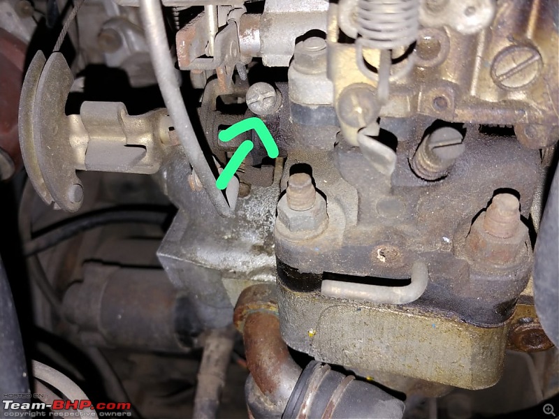

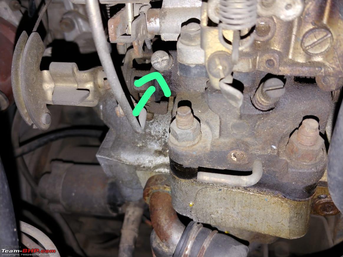

Edit: I finally got the car idling by adjusting the throttle screw, which I assume is the one I marked here. Once the car stopped stalling I adjusted the idle again till it was smooth but chose the smooth setting that was quite rich because the exhaust had more carbon soot and the throttle response was boggy in the higher revs. Now I realise I should tune it to be smooth at the most lean setting is it not? From what I tried, turning the idle screw clockwise tightens the spring and makes it leaner.

Dear Joshtronic, please lock the idle mixture screw clockwise till it seats fully , the engine will stammer and try to loose control as you near the fully seating position . Then you will need to open the screw by 3.5 turns (one turn is 360 degrees) provided you use the original Idle mixture screw . You have to use an RPM meter to set the RPM to 700 ( idle speed screw ) as specified by the factory instruction .
Then you have to open the idle mixture screw by a few degrees ( may be 1/4 to 1/6 of a turn ) to obtain maximum RPM . For example , your previous set RPM at 700 may increase to 800 and that will be your peak setting , now you have to reset your RPM back to 700. Please note , turning Idle mixture screw clockwise weakens the mixture where as turning it anti-clockwise enriches the fuel mixture .
Vintagesoul is offline   (1) Thanks

Hi Joshtronic , please observe the following points ,
1) There are two screws to adjust , one is the idle speed screw and the other one is Idle mixture screw ( commonly called as Air screw ) .
2) The idle speed screw is adjusted to set the engine speed ( RPM )
3) The Idle mixture screw defines the air - Fuel proportion (1:14.7) fuel to air ratio ,you can set this more precisely using a vacuum gauge connected to the inlet manifold . The 3.5 turns from fully seated position is just the base reading for Contessa Nikki carburettor.
4) All these adjustments should be done in engine running in optimum temperature .
5) Please check your ignition timing to 6 +/- 1 degree with distributor advance hoses disconnected and plugged .
Supposing all these are checked , you may get a clean drive .
Vintagesoul is offline   (3) Thanks
Dear Joshtronic , as shown in the picture above ( that you have pointed) is the idle speed screw.
The vacuum hose seems not to be connected , it’s called the ported vacuum which is found near to the idle mixture screw .
This vacuum line needs to be connected to the top of the distributor. It provides necessary vacuum advance so that the distributor advances the timing .
We will take this as a separate chapter once your idle mixture and idle speed is set .
The intention of me mentioning about the missing vacuum hose it may leak engine vacuum when your throttle is open and hence you will not get proper AFR at high speeds and it will not give necessary advance in timing hence loosing power.
