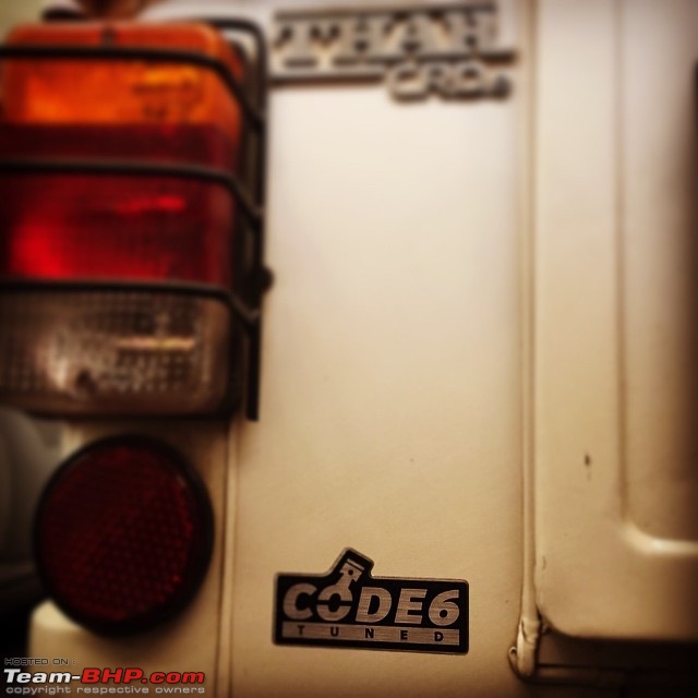

Code 6 Tuning
Some of you are aware that i have picked up a Thar, after coming from the silky DDiS Swift, Thar's Crde engine felt... well.. LIKE A TRACTOR! I was ok with the power, for the weight of the vehicle it moves pretty well, BUT it was like those Volvo buses. No not the handling, my vehicle has Tein shocks all around, which makes it predictable in handling department, but the Rev range. It was pathetic! Usable from say 1800 to about 3000 beyond which it is absolute waste to use the right foot. So one keeps shifting up and down in that narrow rev band. Second issue, it feels very restricted and rough (tractor reference), does not like the idea of revving.
I was in dilemma on what to do. Then came info that Code 6 tuning has done a map for Thar and is a riot. The said vehicle is running on 31" offroad tyres and belongs to a good friend, test drove and i was mighty impressed the way in which the vehicle was moving.
Fixed up appointment for today morning with Code 6 and met up with Sajan at their outfit Bay 6. Ecu came off the vehicle in about 5 minutes and was handed over to Sajan, who had to struggle a bit to open it up (being holiday no helping hands). The parts inside are delicate and one minor slip is all that is enough to mess up the ECU, so Sajan patiently goes around the ECU mm by mm to open it.
My original plan was to go for a stage 1 and get the rev issue sorted, but then Sajan insisted that i try his latest brew (let us call it Stage 2). He went on with his job of carefully loading the new map after taking backup of the OE code.
Put the ECU back, a test crank and engine fired up as usual. Since its stage 2 he insisted that we get the EGR cancelled and remove the cat con can. So the mech took another 30 mts to get this done and we (Sajan in front and Vidyut in back) again started the vehicle and took it out for a test drive.
First gear and wooooaaahhh vehicle just leaps forward and unlike earlier just keeps revving, it was already 4000+ rpm and with a blink of an eye. I see a huge burst of black smoke hmmm. Sajan assured me just keep driving, so we went on and every time i give gas i see a plume of smoke and vehicle just keeps climbing revs like a rabid locomotive. ECU needs to learn parameters since such advanced stage means all the historical data is also wiped clean. Pulled over to restart the engine, yes that is also needed. And drove back..
That is when i noticed, the smoke has disappeared and the acceleration is still ON!
Was in a hurry so said bye to Sajan and hit the Sarjapur to Indira Nagar via IRR, and i was grinnning from ear to ear every time i gave gas. Apart from EGR and Catcon this is stock, no air filter or exhaust mod. But the way in which the vehicle now revs and puts on power is just awesome. Mind you i have driven Thar's with tuning box and Scorpios. But Trust me, the ECU remap and a Piggy back SHOULD NOT be compared! Unlike feeding more fuel, a proper remap just creates a whole new possibility with even a not so modern diesel engine. And as i said this is just a moderate tune, considering the vehicle dynamics of Thar, it is better to be safe than sorry.
Yes more is possible! to Code 6 Tuning.
EDIT: My Thar runs on 28.5" tyres so acceleration is also much more brutal compared to the previous vehicle i drove.
