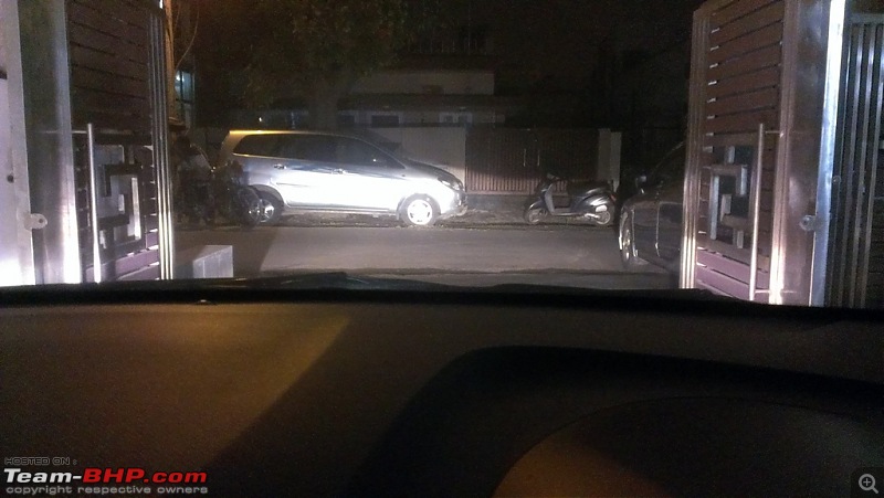

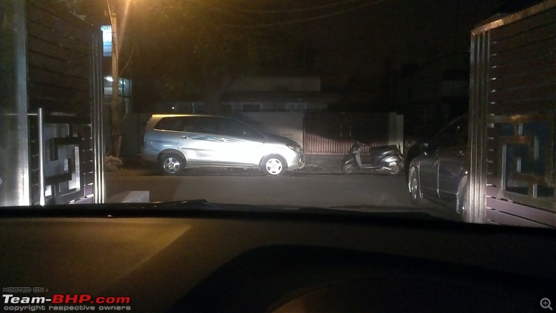

The packaging claims 100% more light, which i feel is a little too optimistic. I can feel some difference and the light is a tinge whiter too. I will let the pictures do the talking now.
Stock Low Beam:
Auto Lighting thread : Post all queries about automobile lighting here-imag0348.jpg
Stock High Beam:
Auto Lighting thread : Post all queries about automobile lighting here-imag0349.jpg

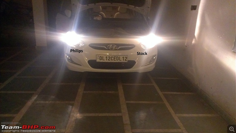

After the right bulb changed, you can notice the changed one is a tinge whiter:
Auto Lighting thread : Post all queries about automobile lighting here-imag0358.jpg

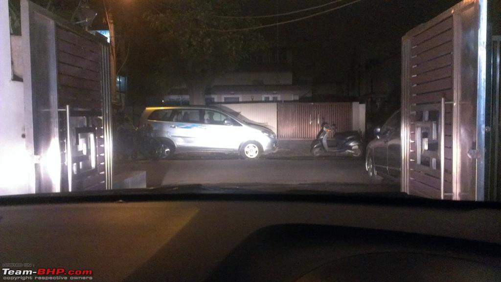

Philips Low Beam:
Auto Lighting thread : Post all queries about automobile lighting here-imag0361.jpg

Not much of a difference apart from i think 5% increase considering the Civic OVRM which is slightly more visible with Philips. But I must say that your cars headlights have been focused really well.

I have used the older Philips X-treme Power and now the X-treme Vision bulbs; though the increase in brightness/throw is not as much as what they claim (80%/100%), it definitely is about 30-40% better than the stock Halonix/Hella halogen bulbs.

May not be a good idea to judge the improvement in brightness, by looking at photos :).

Well, tonight was the first drive i did after the change. I also feel that the +100% thing is waaaay over optimistic.
Originally Posted by motomaverick (Post 2969698)
But I must say that your cars headlights have been focused really well..
Maybe because it is a 4 month old car?
