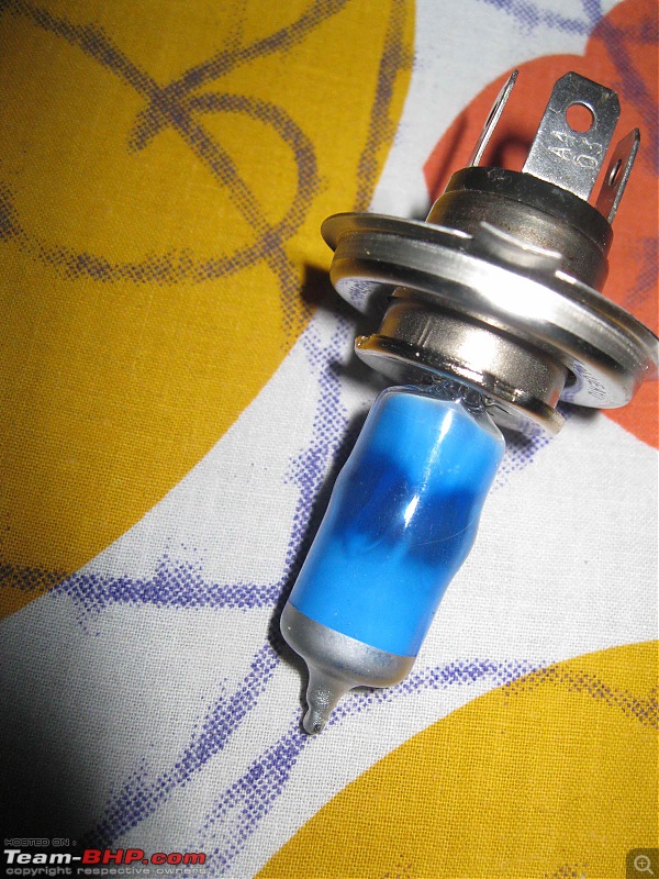

Not even a month & RHS 100/90 are gone ! :Frustrati
Got a replacement. One more & i'll go back to the stock ones. Had a chat with the friendly neighborhood spare parts retailer. "No matter whether they are Halonix or Philips, excessive heat always takes it's toll" . Any suggestions ? Should i revert back to stock ones, or any other 60/55 w ones? Is there any solution to excessive heat generated ?
Auto Lighting thread : Post all queries about automobile lighting here-img_1900.jpg
Auto Lighting thread : Post all queries about automobile lighting here-img_1901.jpg
