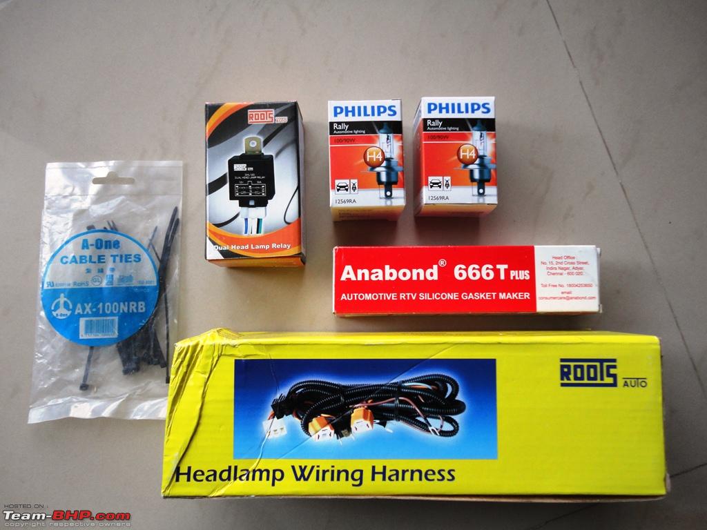

Here's what I used to upgrade the lamps on my car -
It was a one hour DIY and turned out perfect. The engine bay looks absolutely stock. One of these days I will put up a DIY guide.
Some tips which may help you:
- Get genuine bulbs from a reputed seller. Avoid filtered types.
- Use a proper wiring harness with fuses. Again, good brand from a good seller.
- Turn off the headlights when the car is stationary. Even if just for 15 secs.
- Try not to flash the highs too much. Especially if your car is wired to leave the low beam turned on when flashing. Most cars automatially switch off the low beam when flashing. Else it will overheat. But some cars dont.

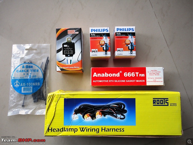

Here's what I used to upgrade the lamps on my car - Attachment 1020833
Some tips which may help you: |
Is this for the new verna or old? would love to see the DIY guide and set myself on light upgrades!
