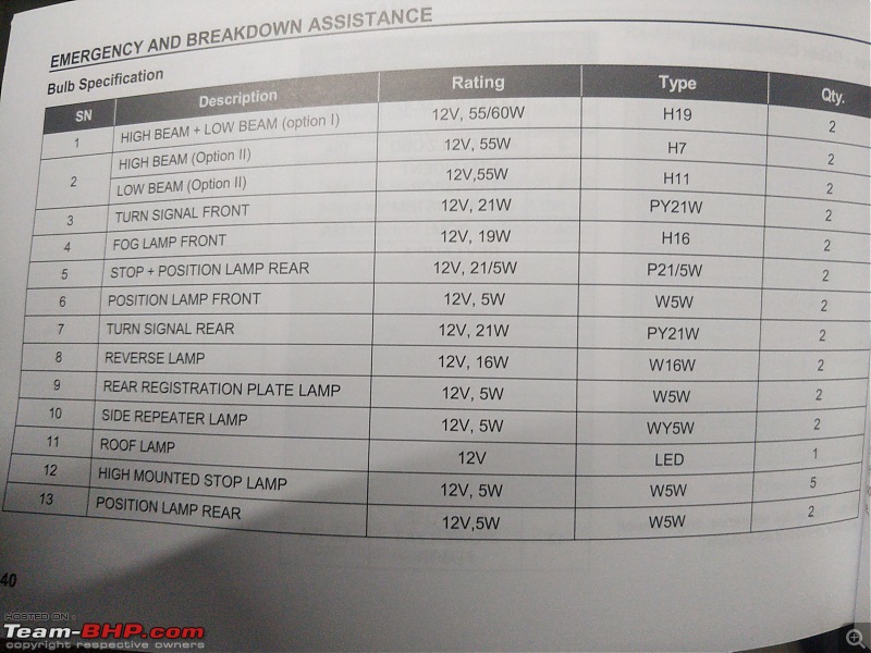

I wanted to upgrade my halogens to 100/90W. But Tiago 2021 XZ+ comes with H19 halogens. Does anyone know where can I buy H19 100/90W halogens?

I think that is pre-facelift. Tiago 2021 comes with standard reflector headlamps with H19 halogens.
Auto Lighting thread : Post all queries about automobile lighting here-img_20210618_0041512.jpg
One question though,
The owner's manual mentions two headlight configurations,
Option 1: H19 for high beam + low beam
Option 2: H7 for high and H11 for low
Can someone shed light on how a H19 bulb be replaced by H7 and H11 bulbs?
