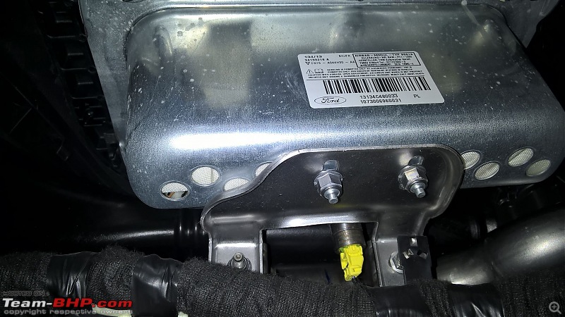

Passenger Airbag Module
- Sits beneath the dashboard.
- Airbag module code 90016.
- Propellant used has the code BAM-PT1-1250.
