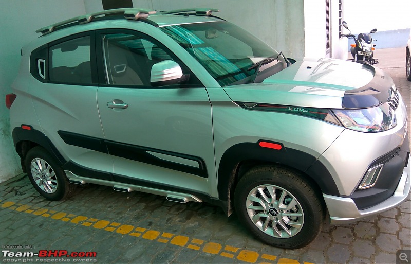

Saw this souped up version of KUV 100 today. There were no changes on the inside.
The point of interest for me was that thing placed on the roof rails, I don't even know the word I should use for that thing to search more about it on Google.
Are they like ski racks on roof rails?
