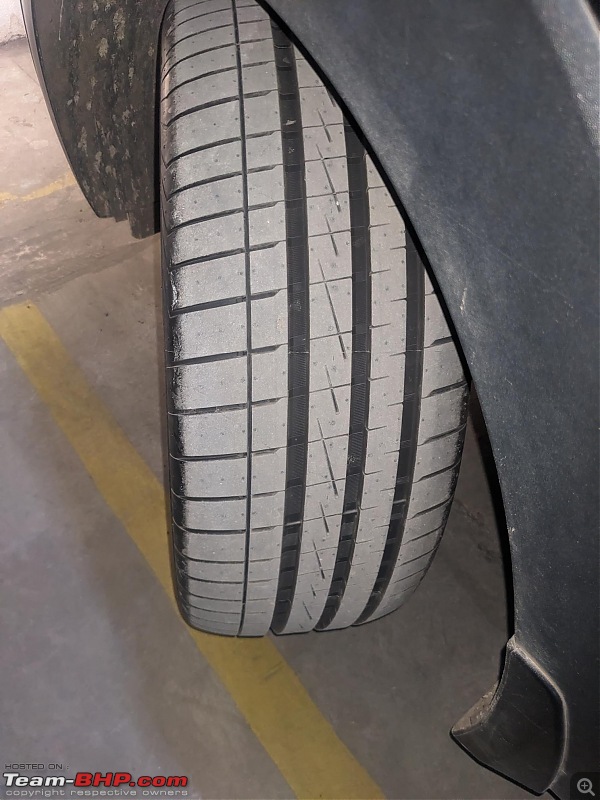

I was about to post the chipping issue in my Nexen tyres when I realized it is a known issue. At 32K, all the tyres have some level of chipping and I decided to change them.
Nexen tyres come in odd size 225/55/R18. There aren't many options in this size. Only sensible choice in this size was from Vredestein Ultrac Vorti. Other option is to upsize to 235/55/R18 and you have plenty of options.
I decided to stick to the stock size and go with Vredestein. Called up Madhus and they had it in stock. Price was around 15K a piece and I changed only 4 of them.
Vredesteins are soft and sticky. It has a speed of Y, meaning they are good for 300kmph. The brakes feel much better and car stops quickly. This has also improved the handling/cornering. Tyre noise has greatly reduced. The car feels supple going over broken roads/smaller speed breakers. Overall happy with the purchase.
Hyundai Tucson : Official Review-shared-image-1.jpegHyundai Tucson : Official Review-shared-image.jpeg
