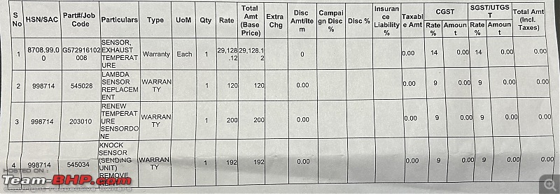

Yesterday I dropped off my Harrier at the service centre for warranty claim replacement of NOX sensor.
Got an update today that the part will be arriving tomorrow. I was told they will need the vehicle to be there yesterday itself since they need to run diagnostics, take pictures and provide all necessary documentation when filing the warranty claim with the Tata Motors Helpdesk.
Hope to get the vehicle back by Saturday. Also, it seems like part number is different in the current (2023 facelift) model Vs my 2023 Pre facelift model.
NPV is offline
Old 23rd September 2024, 11:59   #2063
NPV
NPV's Avatar
Location: Namma Bengaluru
Posts: 7,527
Thanked: 11,204 Times
Re: 2020 Tata Harrier Automatic : Official Review
There was a day's delay in receiving the part and I took delivery of the vehicle on Saturday, haven’t driven much after that though.
NOX Sensor was replaced under warranty and I wasn’t charged for anything including labour. Quite an expensive part at almost Rs.30,000, no wonder the reluctance to change it without proper diagnosis, which is a good thing.
I was told that the Vehicle was taken on a slightly long test drive after replacement of the part. They were kind enough to let me pick the vehicle up from the service centre beyond their closing time based on my request. The paperwork was done and car key with gate pass was left with the security for me to collect after hours.
I’m very happy with the service experience at Cauvery motors, Avalahalli and appreciate their approachability and transparency.
