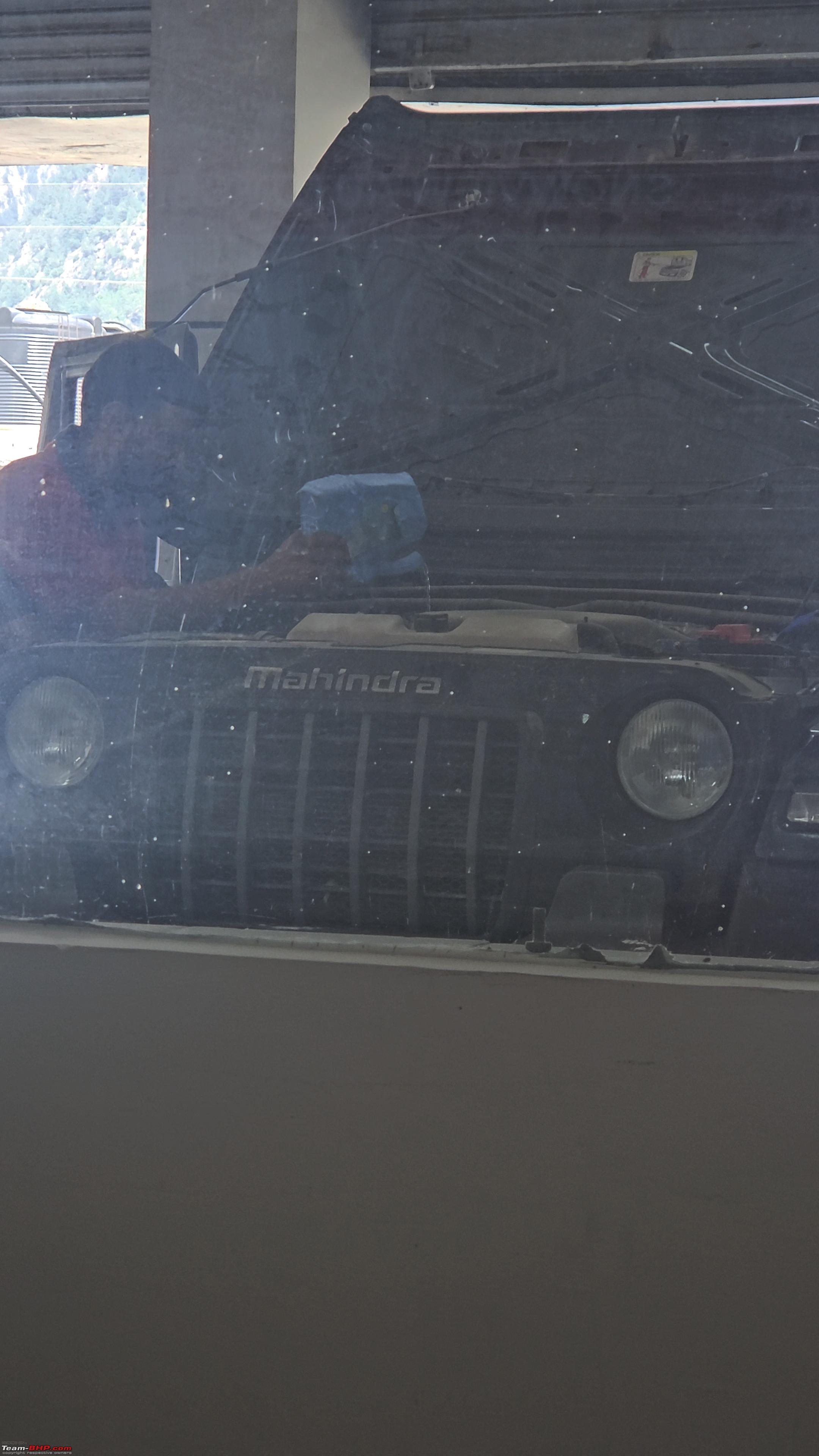

I'm not sure what's happening in here but today received E21 error again at 11000 feet then just after 50 kms received infamous E22 DEF Dosing Malfunction error at 12500 feet which has limited the engine to just 800 kms.
Attachment 2628963
Update on this one: This progressed quite early. Had to take a detour and drive to MASS. Nearest one was at Reckong Peo. Took an appointment with them in the morning itself, and they told me to bring it in.
They poured in some water on the housing to cool it down so that it can be opened.
Mahindra Thar : Official Review-cooling-down-sensor.jpg
The temperature can be seen after connecting their laptop. Took them around an hour to fix it. These are the DTCs which their laptop reflected.
Mahindra Thar : Official Review-dtc.jpg
After completing it they took it for a test drive for around 5-6 kms at higher RPMs. Then only the E21 error light went away which made me realise that they can reset E22 from their laptop but for E21 the system itself diagnoses it and the solution to it is driving at higher RPMs before it turns to E22, which even the MASS validated.
