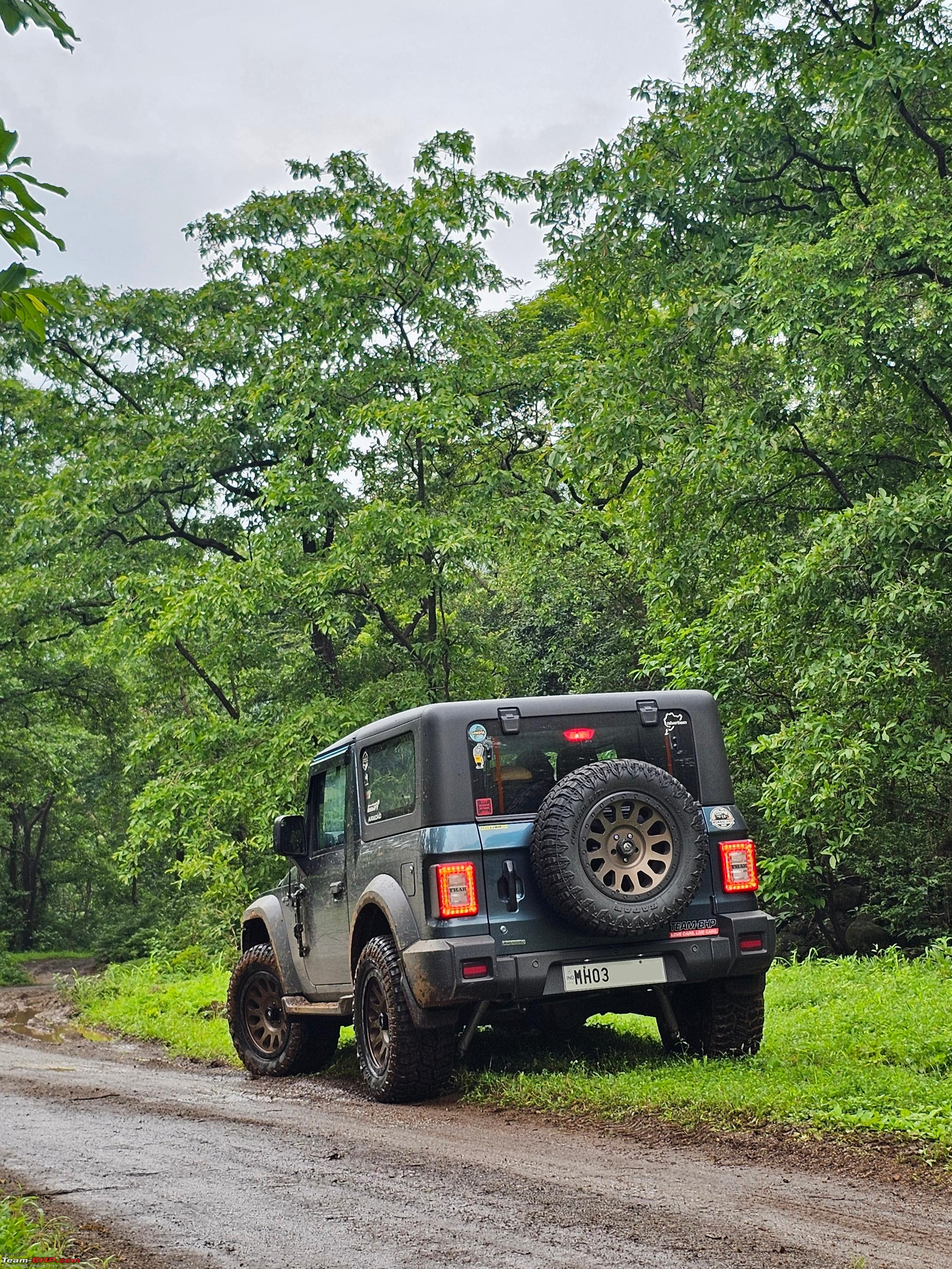

Amidst all the hype of 5-door Roxx, my beloved Roxy (yes this has been her name ever since i got her in Jan 2023!) receives a slew of upgrades to make the most of this monsoon off-road season:
Radar Renegade R/T+ (285/60/R18)
The stock Ceat Crossdrive tyres have been replaced (after 21,000kms) with a juicy set of Radar Renegade R/T’s (size: 285/60 R18); these beefy tyres compliment the Fuel rims rather nicely & have uplifted the overall stance to a whole new level. I’ve been using them for over 2,000 kms now & I’ve found the Renegade R/T’s to be rather good. There is no extra weight felt on the steering wheel, grip levels on highways are great, they inspire more confidence in wet conditions than the stock tyres & they superior grip & traction in off-road conditions. The Renegades were purchased from Saifee Tyres Dadar, they gave me a decent buy-back for my old tyres as well.
Mahindra Thar : Official Review-20240711_162432.jpg
Mahindra Thar : Official Review-picsart_240910_144815037.jpg
