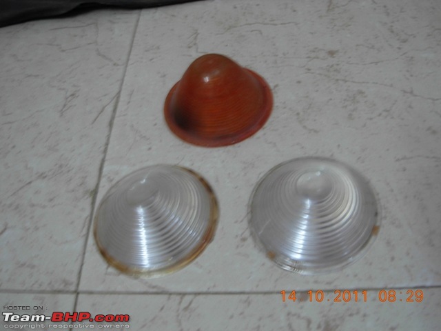

The Headlight Trim was Chrome Plated and put back on the Car along with New Higher Power Bulbs ie 60 amps along with a Cutout. Earlier they were 35/35 and the Light was not enough for the Night.
New Indicator Glasses were sourced ealier but they are White in colour. The Old ones were orange and are not Cracked or anything but have just Faded.
A Rare Find - My Bajaj PTV (Peoples / Private Transport Vehicle)-16.jpg
So Here are the Pics Before and After for The Headlamps and Indicators.
A Rare Find - My Bajaj PTV (Peoples / Private Transport Vehicle)-1.jpg
A Rare Find - My Bajaj PTV (Peoples / Private Transport Vehicle)-2.jpg
A Rare Find - My Bajaj PTV (Peoples / Private Transport Vehicle)-3.jpg
A Rare Find - My Bajaj PTV (Peoples / Private Transport Vehicle)-4.jpg
A Rare Find - My Bajaj PTV (Peoples / Private Transport Vehicle)-5.jpg
