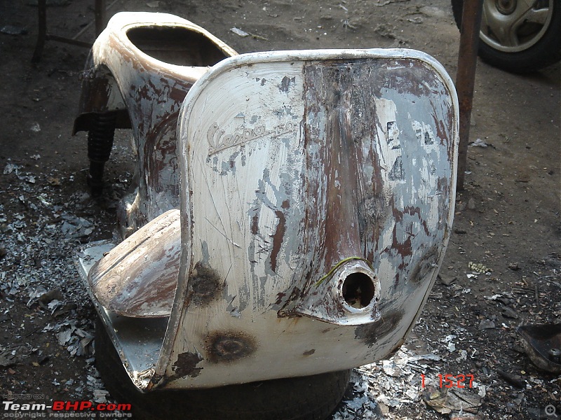

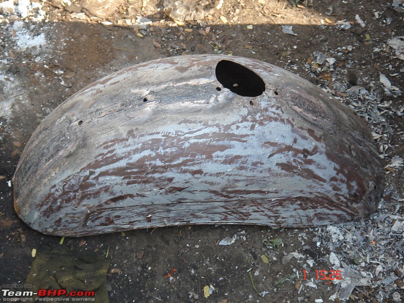

Update Time:
1. Body Color Scraping, almost completed. Work halted due to the Painter having slight fever.
2. The Handle will also be scraped today itself, pic attached.
Next Step: Probably tomorrow
1. Spraying of Zinc Oxide.
2. Putty Work & Scraping
Hope to complete the above tasks in this week & from next week onwards the painting and refitting of the scooter will start. Keeping fingers crossed
Uploading some of the Pictures, i clicked today:

Nice going Sanjeev. Its good that you are doing a thorough job of scrapping off old paint. Just a suggestion. Get that Vespa 150 monogram removed and kept safely with you to prevent any damage to that..

Yes, i will ask the Painter to remove the Badge. Decided to Scrape off the old paint on the suggestion from Pavan Anna.
I hope the Final finish will be good after this. Lets hope for the best..!!
