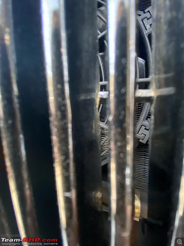

While all fluids had to be changed, small niggles too had to be fixed. I also wanted an electric fan fitted as an upgrade, after being stuck in quite a few traffic jams in Bangalore.

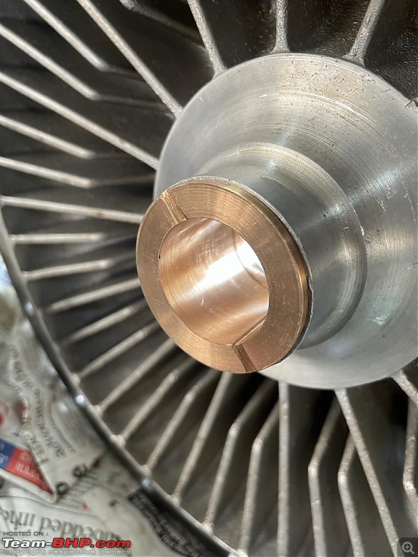

One niggle from the recent past was that oil was leaking from the Fluid Flywheel. As the oil level falls in the fluid flywheel, there is loss of power.
As a short term measure, we used to top up the fluid flywheel oil and continue to use the car. Since the gear box had to be removed, wanted postponed as much as possible, till Chris could make space for the car in his packed garage.
Since a major road trip is planned, we could not postpone this work. The culprit was higher oil clearance in the bushing on the fluid flywheel. We had to machine a new one and fix the same

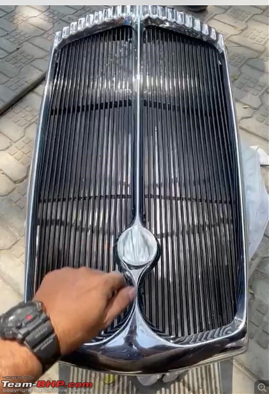

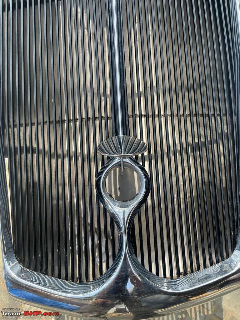

Another thing which was was in my pending list for such a long time, was the crank hole cover. This piece is just not available any where. Fitted in a unique way, the grill had to be removed to get this done.
BHPian Srinand was kind enough to get his tinker to build one from scratch. Chris modified and refined this same, to fit is just like it should look!
Seen with the cover closed
You can see it is hinged on top and has to be opened upwards

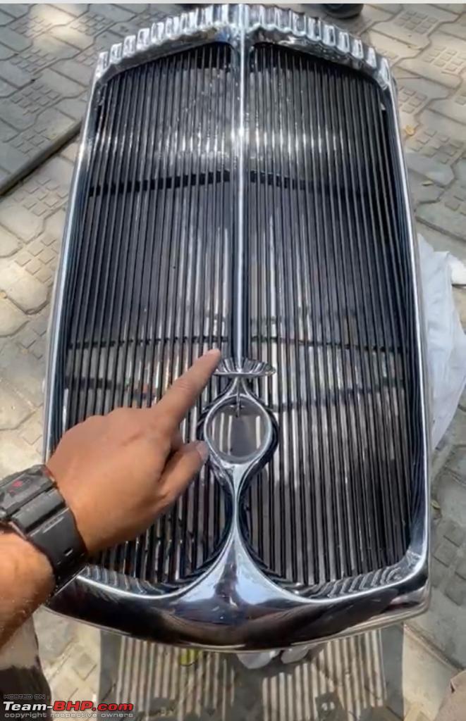

Demonstrating the closing
This has come out far better than I expected

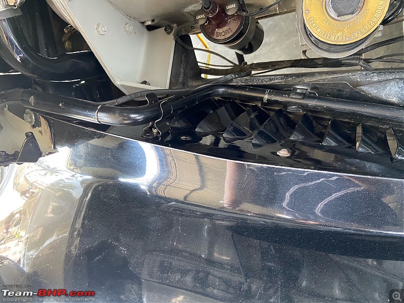

Fitted a fan to the radiator, to take care of the heating issues, we experience being stuck in one of those notorious traffic jams at Bangalore.
Secondly, the Starting Handle has been fixed back at its original position, under the bonnet. With a fluid flywheel, you cannot push start this car! Hence the Starting Handle is very important

Gearbox removed for change of fluid flywheel seal. Fluid flywheel center PB bushing replaced. Fluid flywheel calibration for optimum clearance.Bell housing cleaned and detailed as original.

Front grill assembly fitted and realigned. Radiator mounting assembly fitted. Radiator electric 10” fan fitted with brackets. Electric fan relay fitted. Electric fan switch and bracket installed.

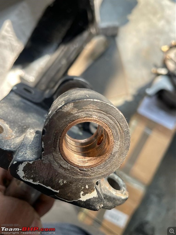

Steering link arm bushes refabricated and fitted. Tie rod ends replaced all. LH king pin bushes fabricated and replaced.

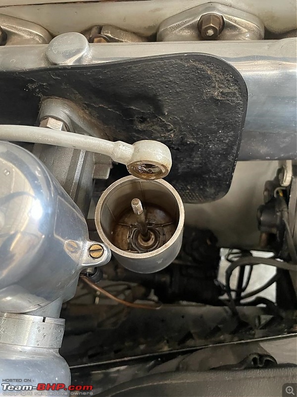

Carburettor banjo bolt fabricated and chrome plated. Carburettor banjo adaptor fitted. Brass mesh fuel filter added to carburettor.

Mr. KPS, I feel like - installing a dual inline radiator fan (which covers whole radiator) could have increased the cooling capacity and performance of your masterpiece. :thumbs up
I am still running with the Dynamo. Had I installed a Alternator, probably the load would have been manageable. The fan is used mostly in heavy traffic. On the highway, it is not required. The radiator is not pressurized.
Everything is tight fit in this car.
Appreciate your suggestions. Thanks for following the work done
