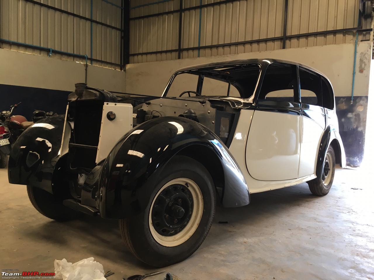

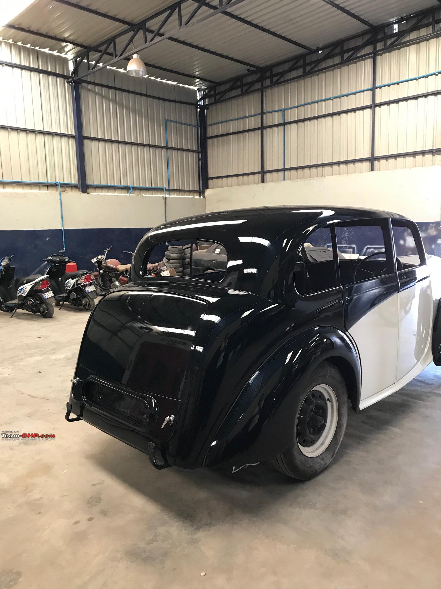

I am very excited when Pankaj sent me the pictures, post assembly of the bonnet and grill. You will now get a sense of the car.clap:
The cleaning and rubbing is happening. The final polish will happen after the complete car is ready.

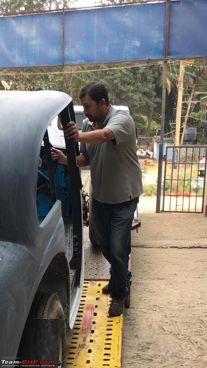

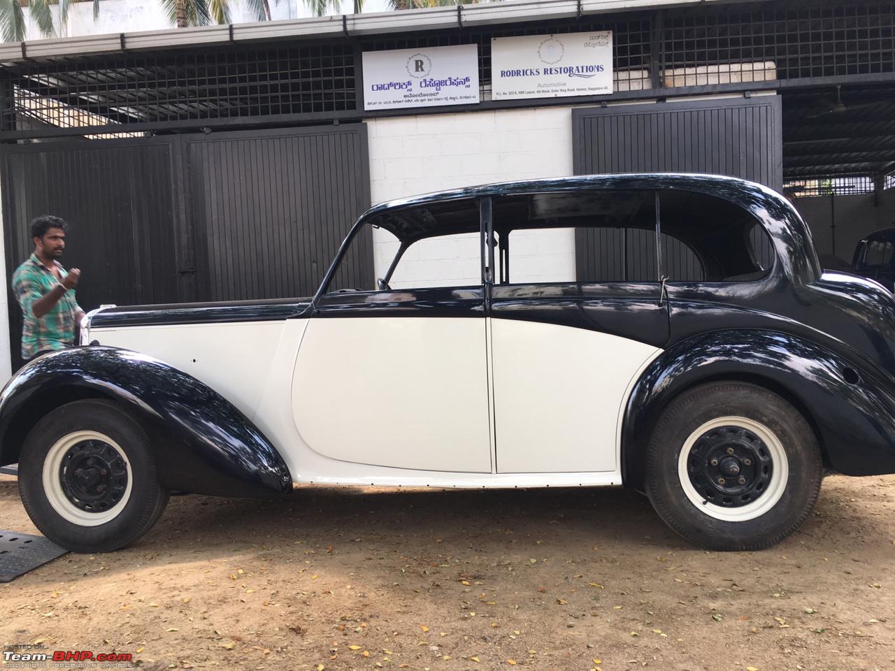

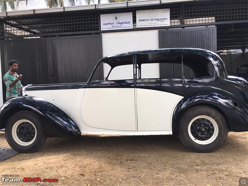

Visited to paint shop to check out the car with Dad and Pankaj.
Here is my father inspecting the car
You can see the fantastic paint booth infrastructure behind the car
The slow hardener and baking in the Paint booth has given very good results
This is the finish before the final polish!

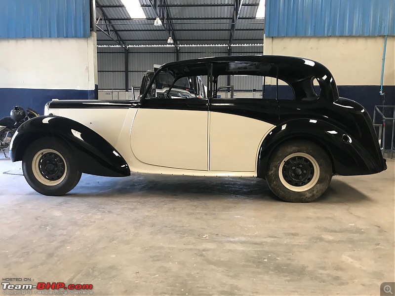

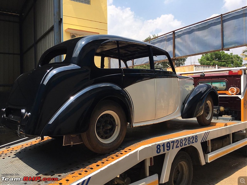

When my wife chose the colour scheme, she had impressed upon us as to how the white and black contrast would make the car appear longer than what she actually is.
I am very happy with the outcome.

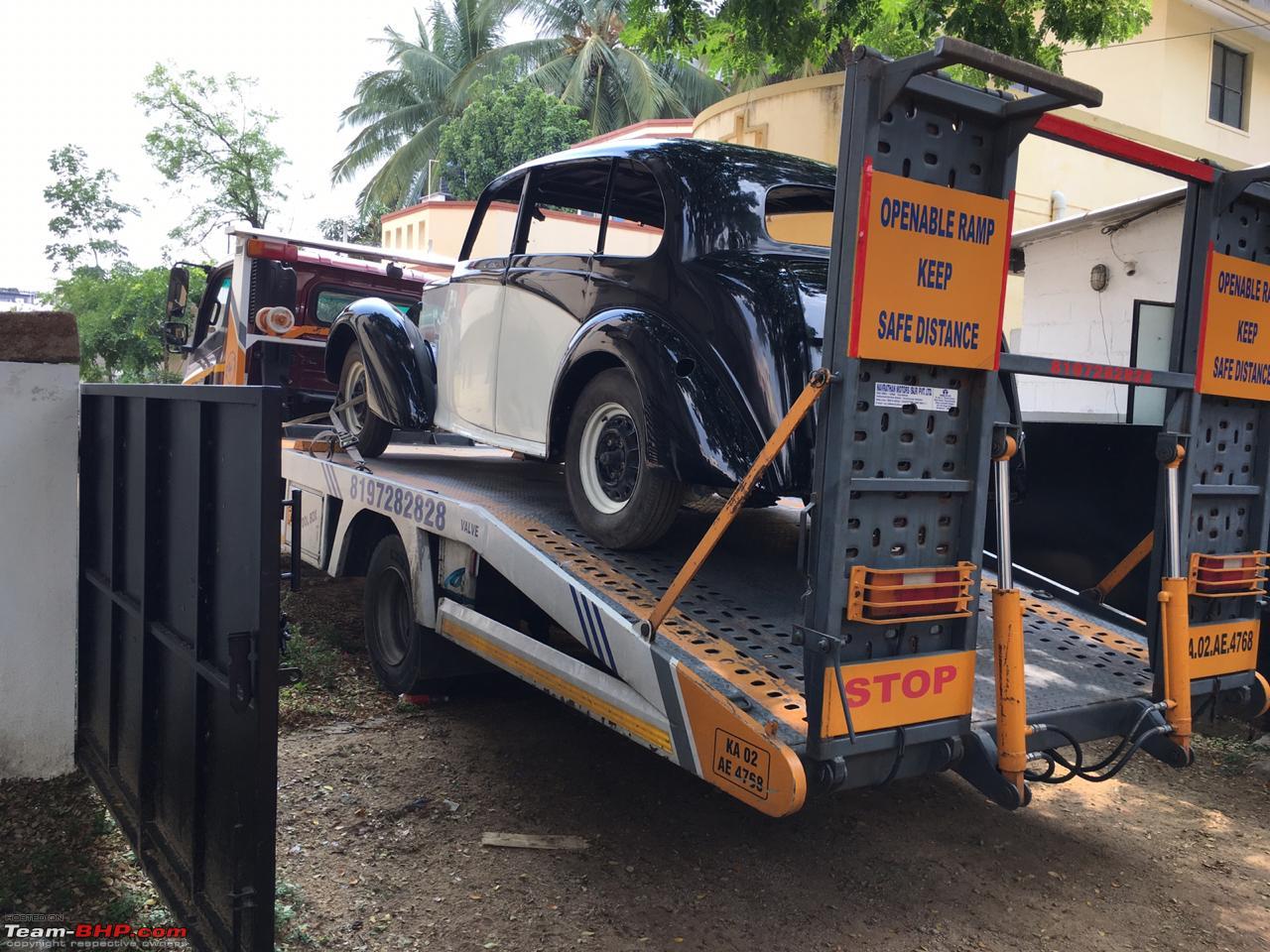

Thanks shashanka for following my restoration. I am waiting to complete this project. The car would come into Christopher's garage by late next week and it is expected to be ready in the next 2 months.

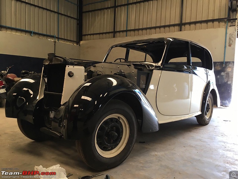

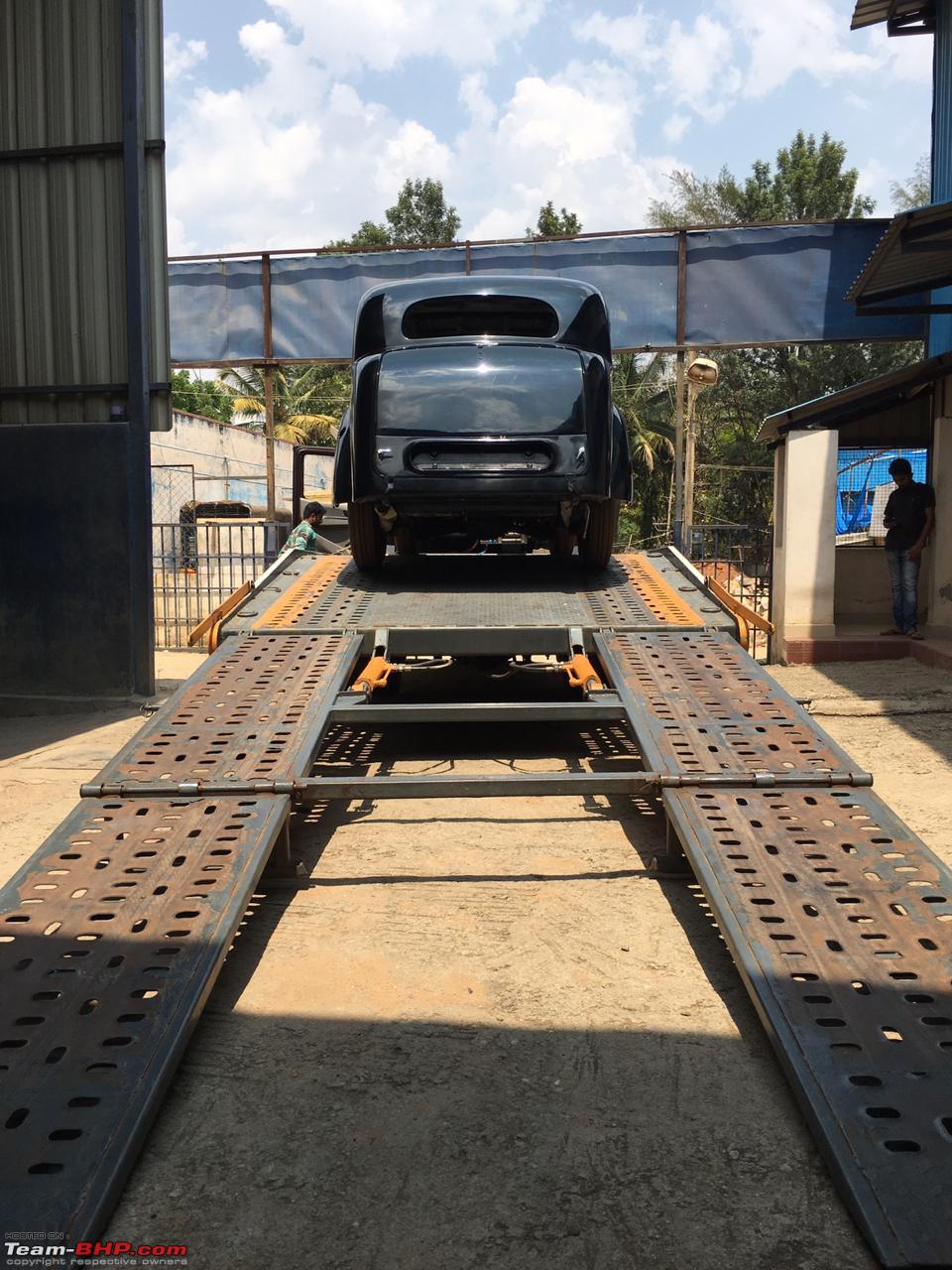

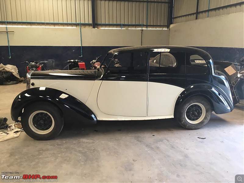

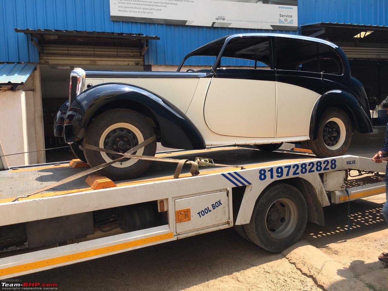

The car finally made its way back to Rodrick Restorations. We will need another 2 months to complete the car from here.

Having been born and brought up in Mysore, the cars of the Mysore Royal family have always piqued my interest. An opportunity to restore a Royal Mysore car is definitely a dream come true. This car has the added distinction of having been Raman's pride and joy, and is now in the custody of KPS & family, and that makes it all the more special.
It has been an absolute pleasure to work on this car. I have thoroughly enjoyed the discussions with Prithvi Uncle on how paint systems have evolved, the discussions with KPS on the history of the car, and the pin point precision with which KPS' wife asked for the formulation of the paint shade and modified it by suggesting percentage changes of base colours !
Firstly, I must thank KPS and his family for the opportunity of being a part of their journey with this car.
I thank Chris for all the co-operation and support these past few months.
I must also thank the good folk at Hindustan Paints, Bangalore for their tireless efforts on the paint material for this car.
I will miss seeing the Daimler at my workshop :), and look forward expectantly to see her on the road soon.

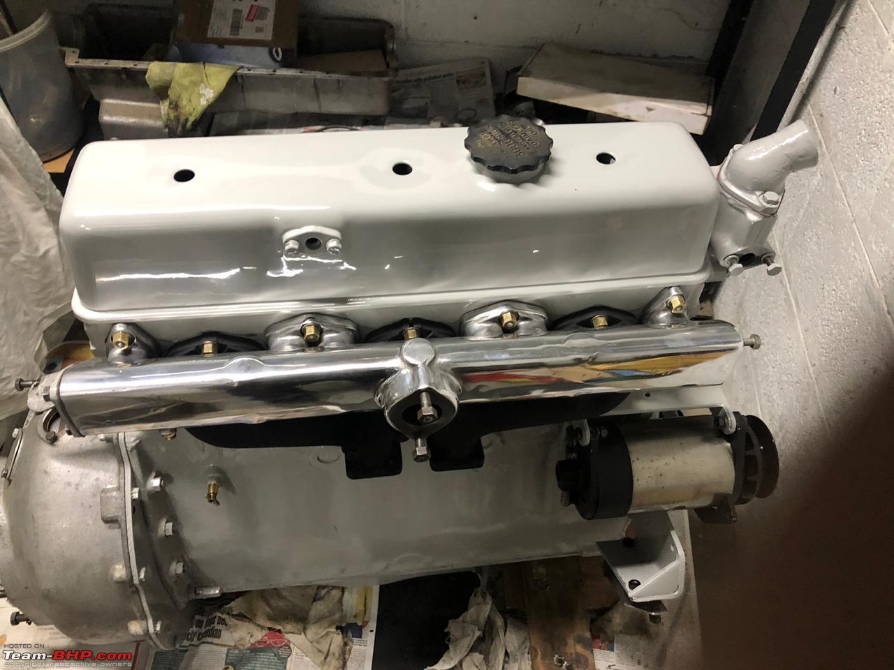

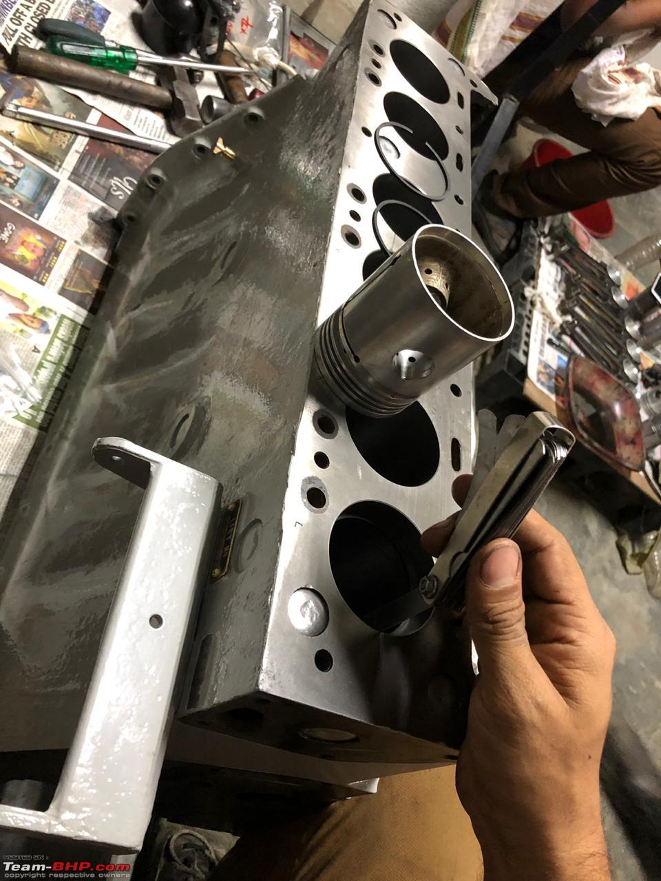

The engine work is in progress at Rodricks Restoration.
Just in awe at the systematic way Chris goes about his work. There is a dedicated engine room and one engine at a time, means that everything is done the way it should be!

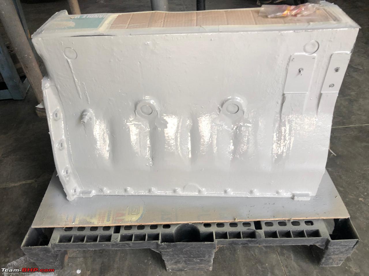

The block in its original grey colour

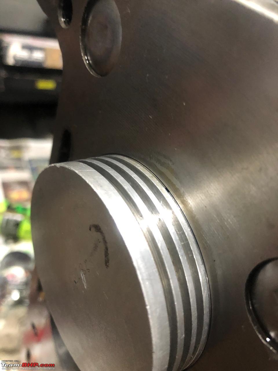

Piston & Oil rings came from England
Piston remains standard as came in the car
Bearings for the big end came from England
Though not is the picture the Main Bearings also came from UK
With the Connecting Rod installed

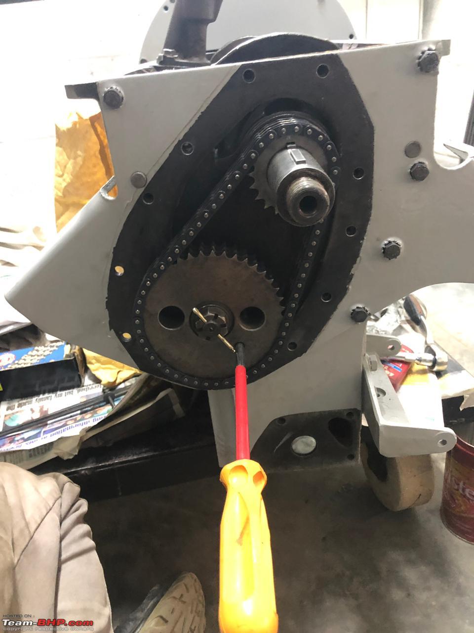

Timing Chain is also new
Prior to installation of the sump. The fly wheel is in great shape

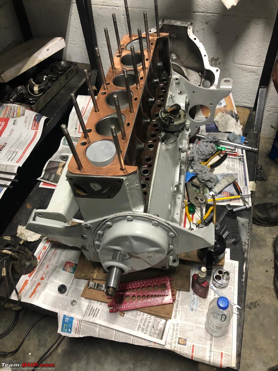

Head Gasket which came from England is in place

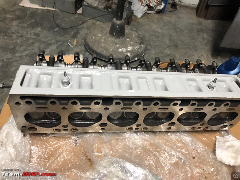

The Head is ready with the valves in place

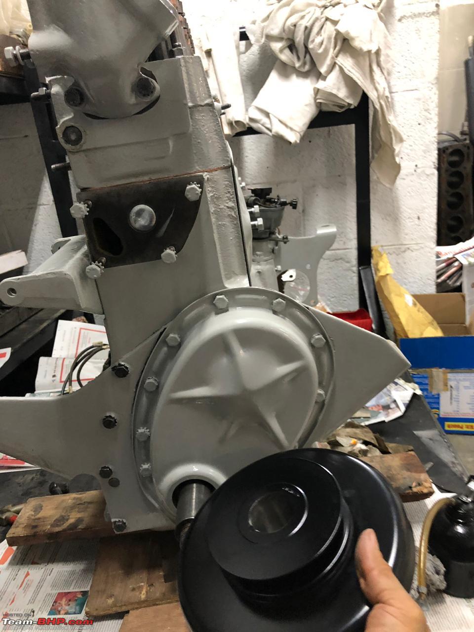

Harmonic Balancer which came from England, on an exchange basis to my old one. This dampens the engine vibration
With the fully assembled Head in place

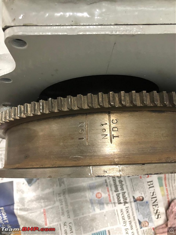

Top Dead Centre for the ignition of the No.1 Cylinder. How beautifully it is inscribe

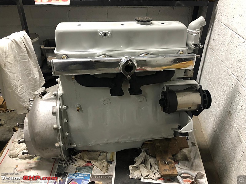

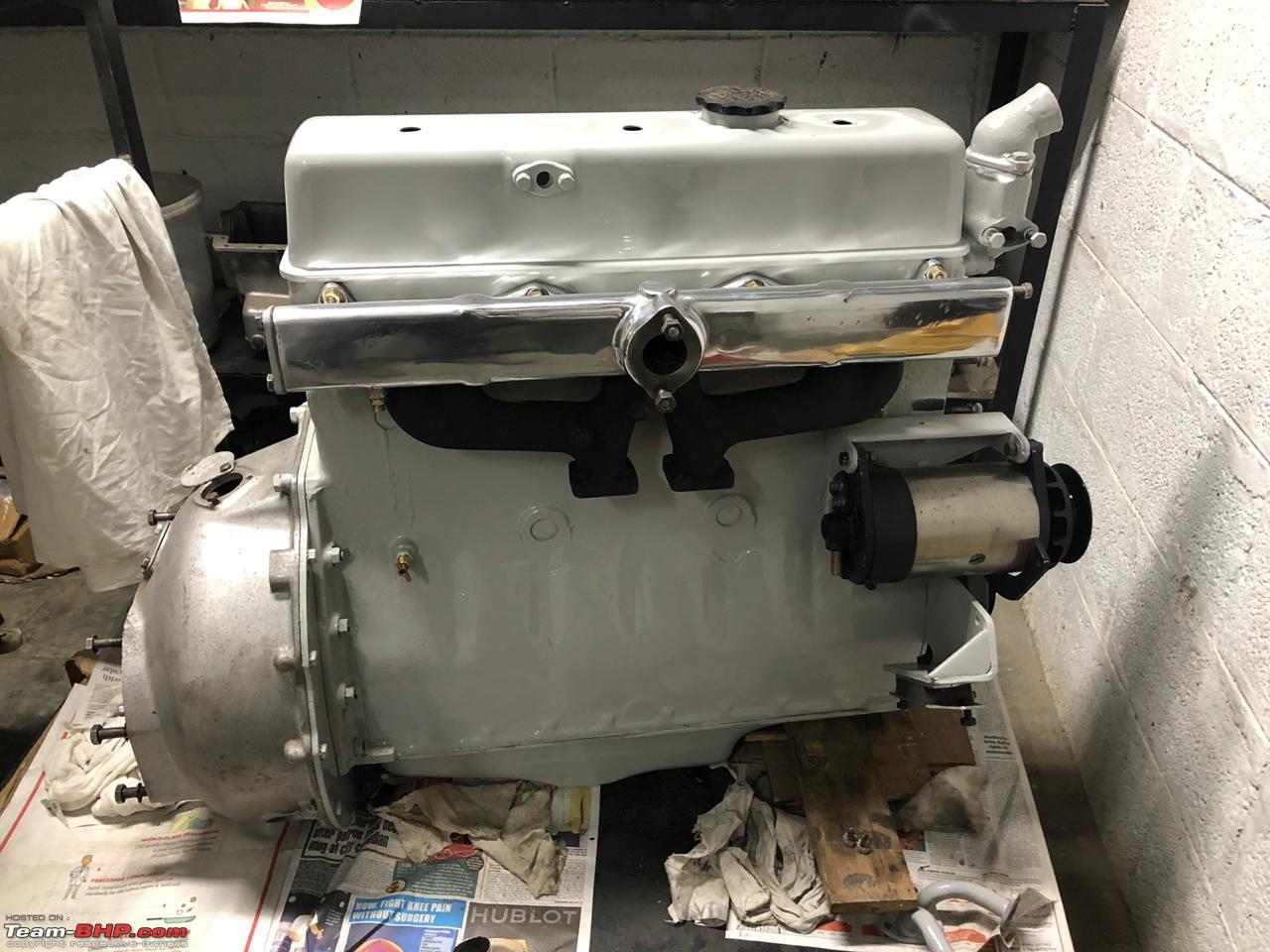

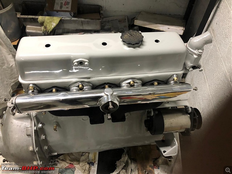

The engine is heading towards completion

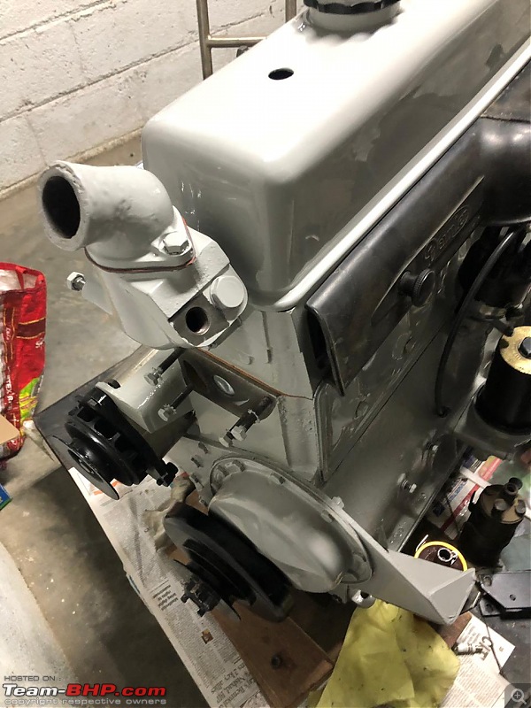

RHS of the engine
LHS of the engine

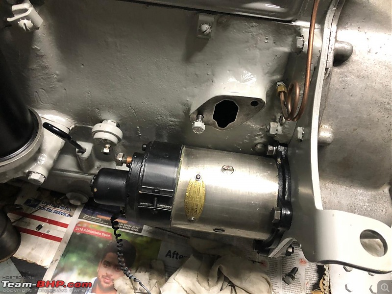

Starter

Hope you enjoyed this pictorial representation as much as I did.
