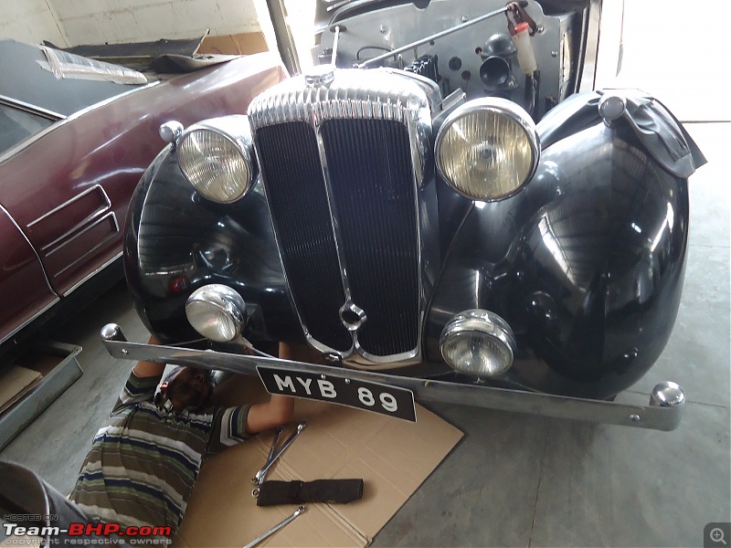

Originally Posted by KartikeyaL (Post 4237858)
Very interesting, but how would you tend to the underside of the body, where it meets the chassis, or is the body bolted off and lifted/tilted up slightly ?
Checked with Chris, they use their hands and try and reach all points of the chassis. In the Daimler, the floor board is all wood, hence the chassis is easily exposed. However the points where the body is mated with the chassis will remain as is. Should we go for full tinker and remove the body, then those points too would be attended.

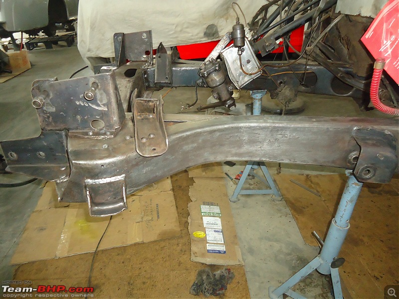

Currently only the front end is being worked upon. Since they strip the chassis to bare metal, they do it in stages.

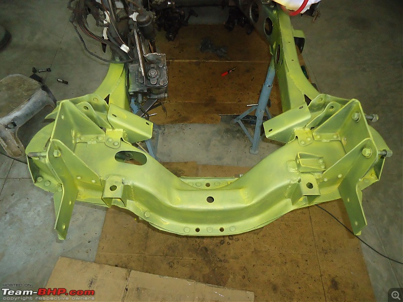

Portion of the chassis stripped to bare metal and cleaned of any signs of rust
The etch primer coat is done within hours stripping and cleaning the chassis

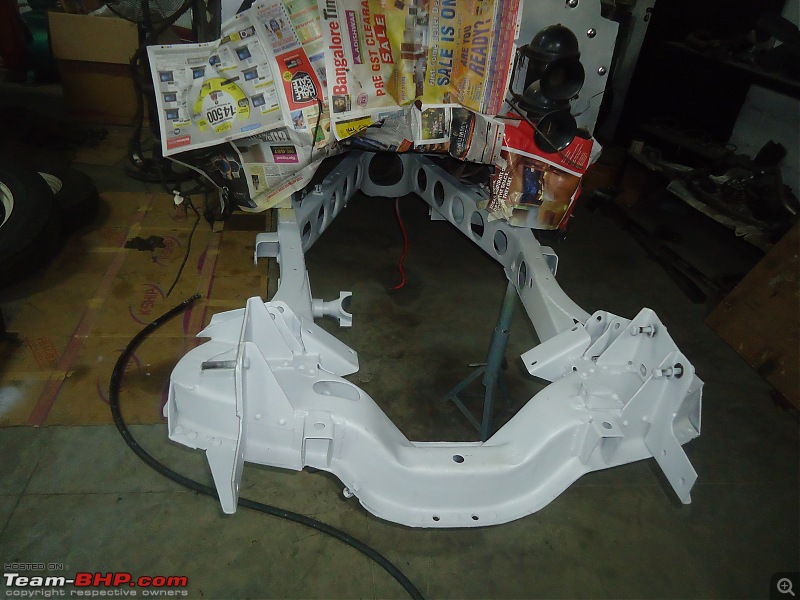

Two coats of primer
Chris is seen applying the stone guard. The painting is done at a high 90 PSI, hence it penetrates all the nooks and corners in the chassis.

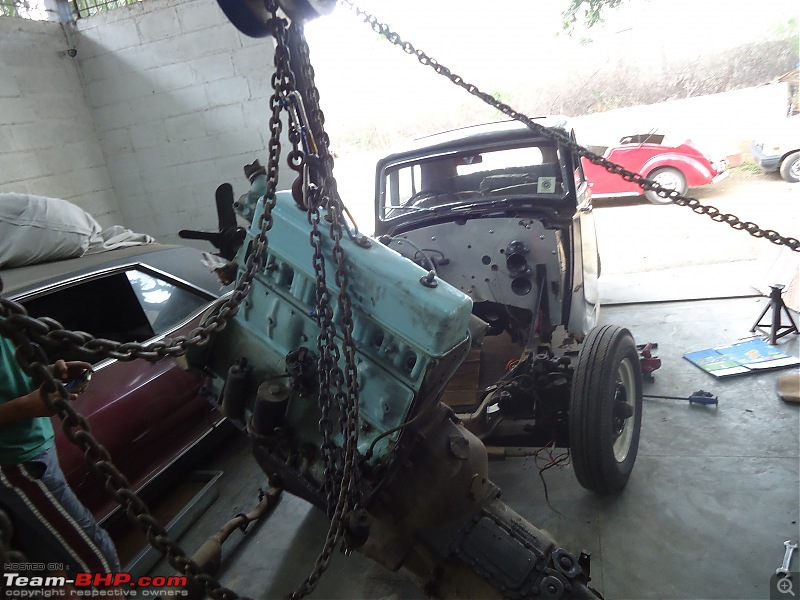

Engine removal in progress
The engine, the gear box and the massive fluid fly wheel hub is seen

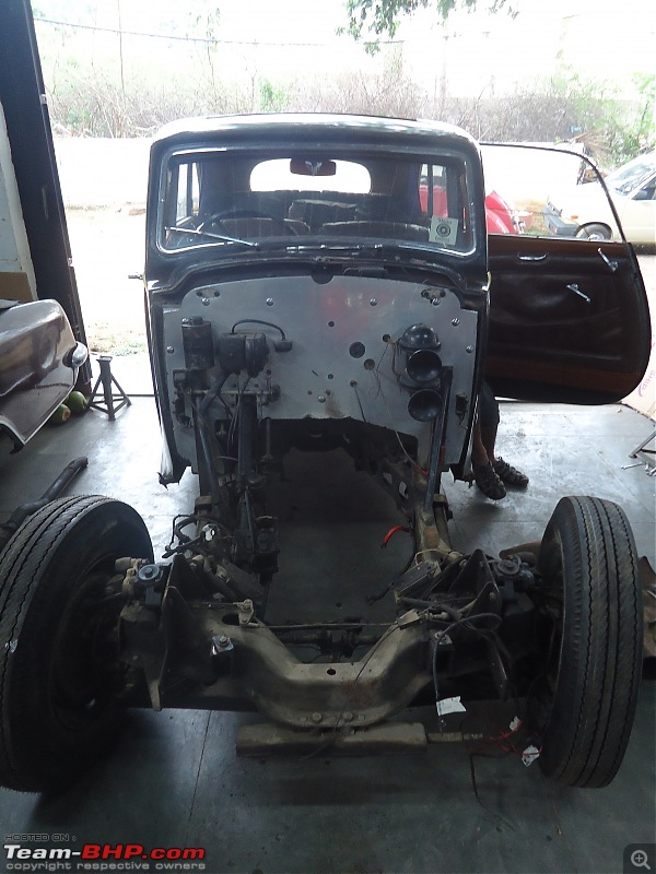

Engine bay sans the engine
Daimler Tales - 1947 Daimler DB18 Luxury Saloon-5-engine-bay-sans-engine.jpg

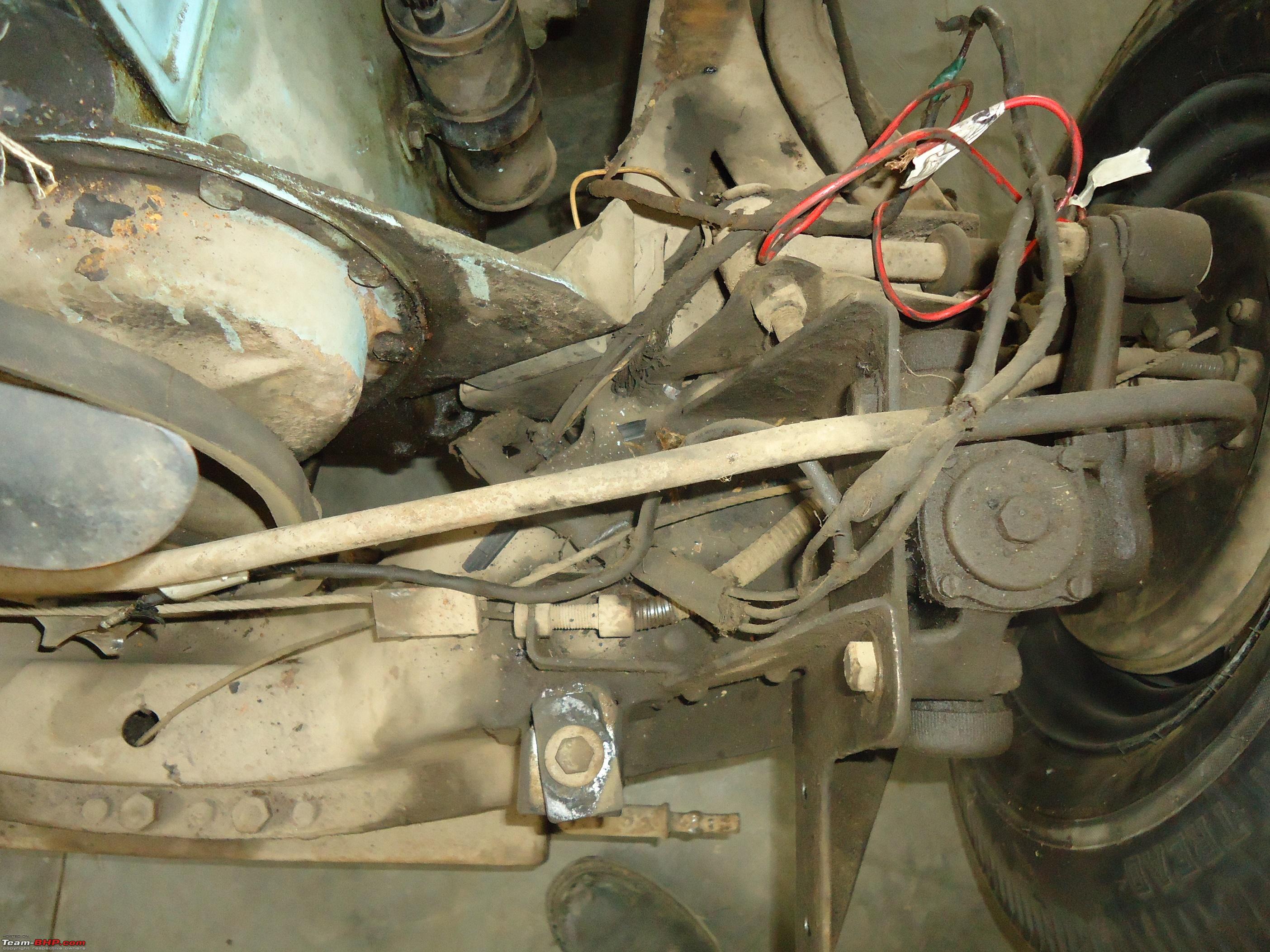

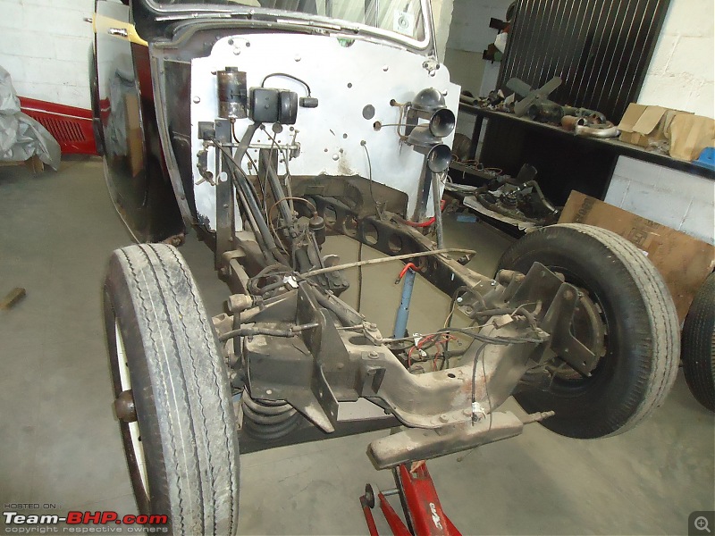

Front suspension with wiring seen
Daimler Tales - 1947 Daimler DB18 Luxury Saloon-7-front-chassis-wiring-suspension.jpg

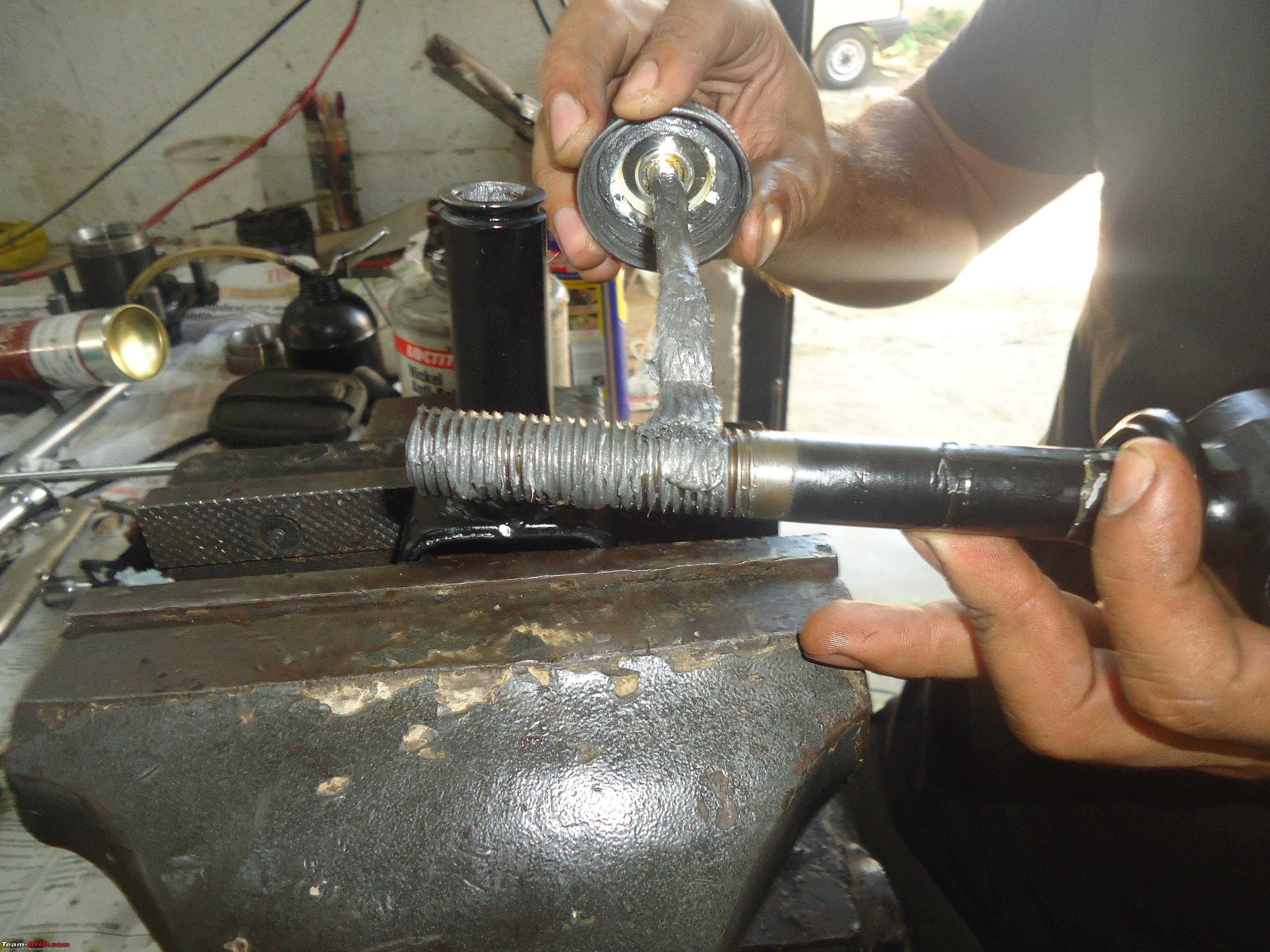

The Luvax Shockabsorber

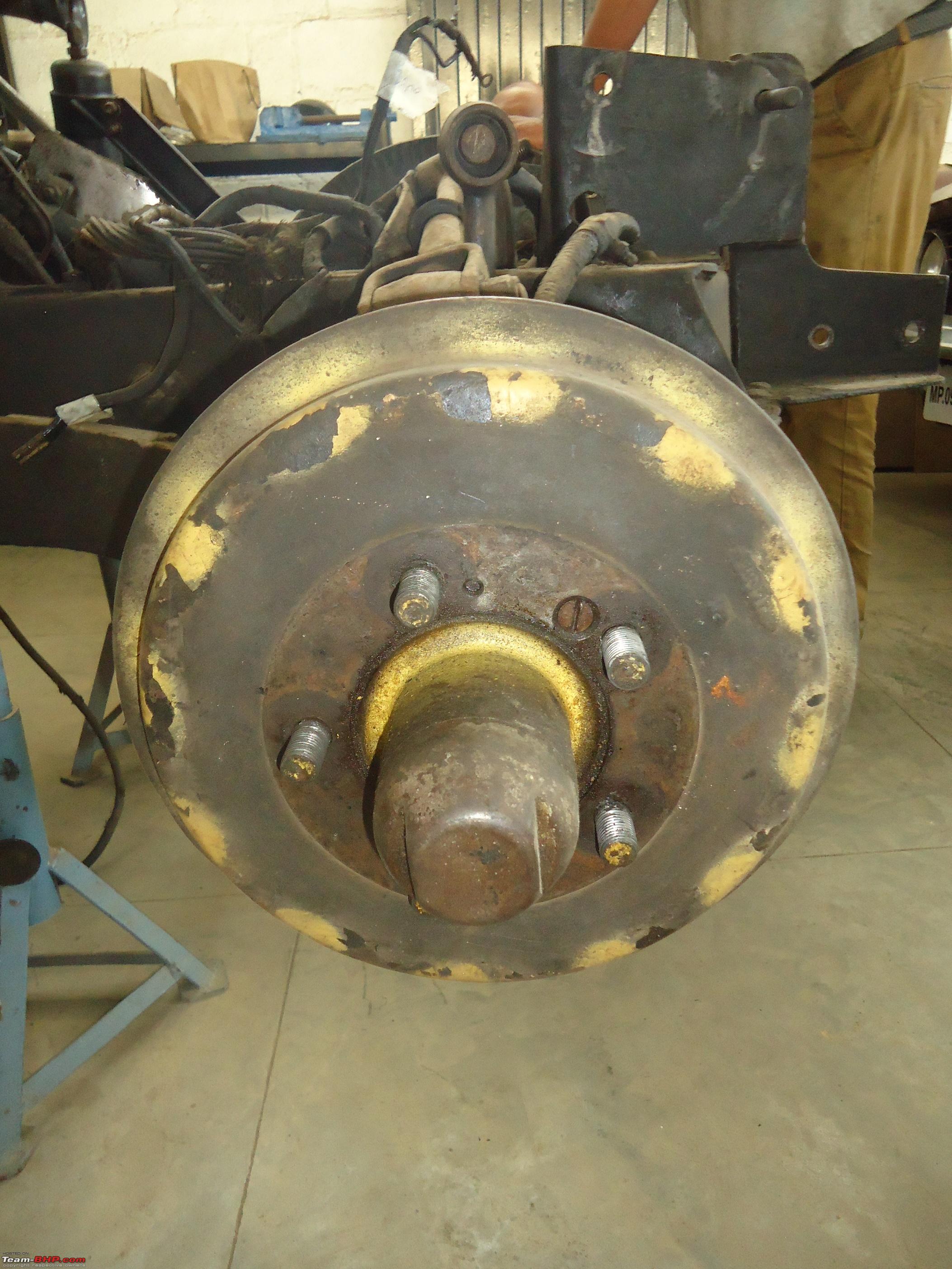

Brake drum. Shows signs that the wheel was painted yellow, without taking it off.

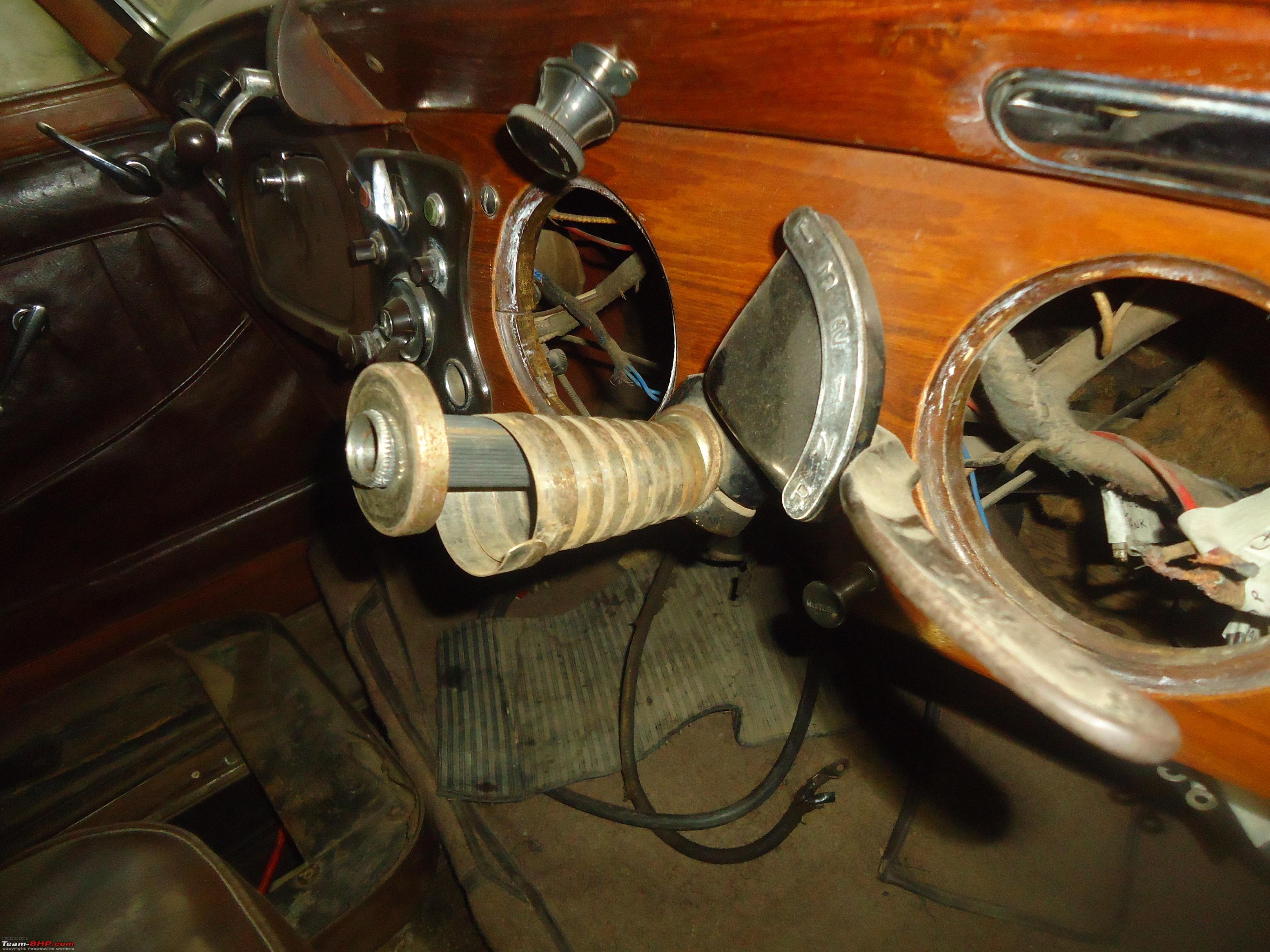

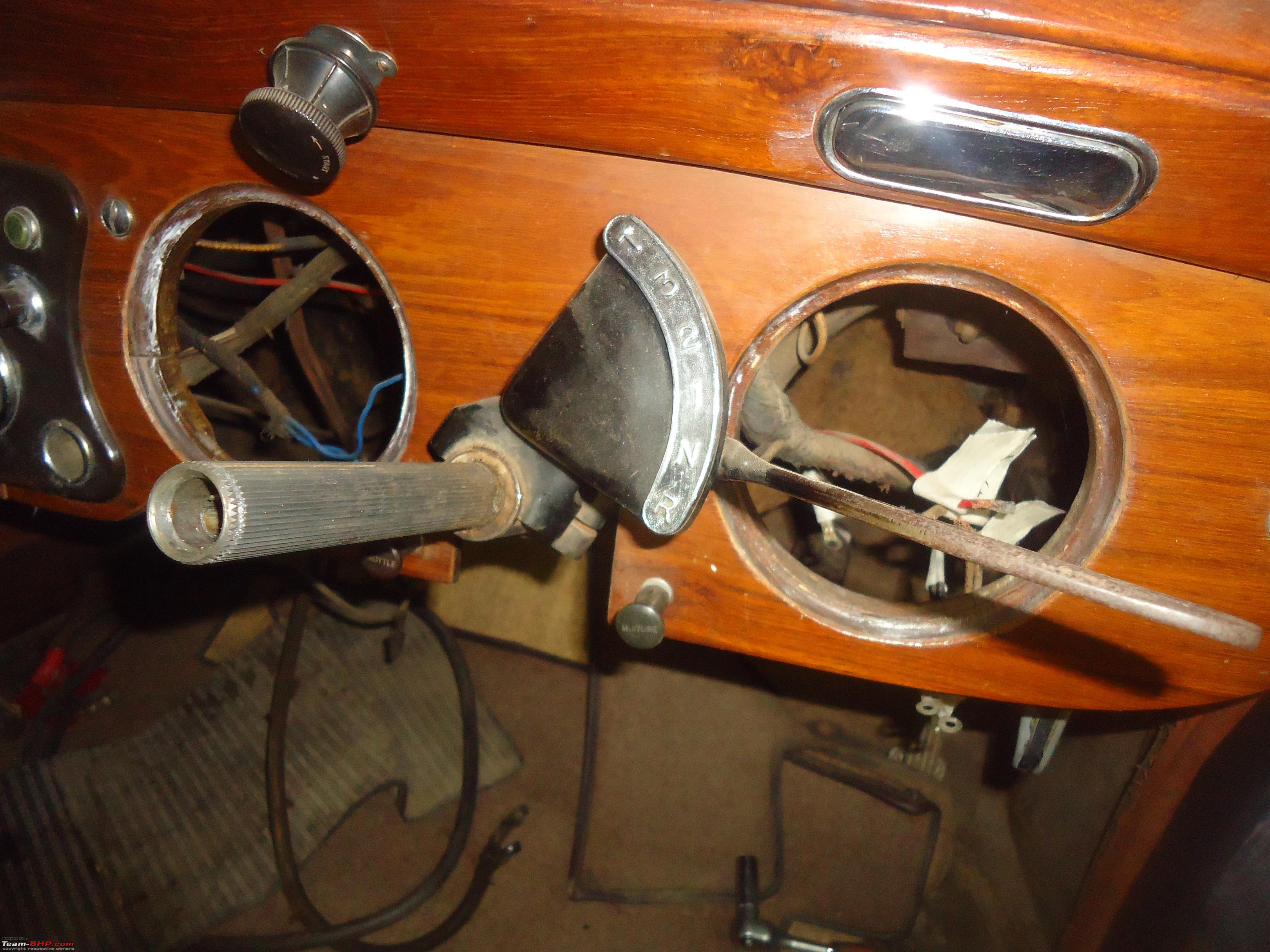

Steering and meters were removed

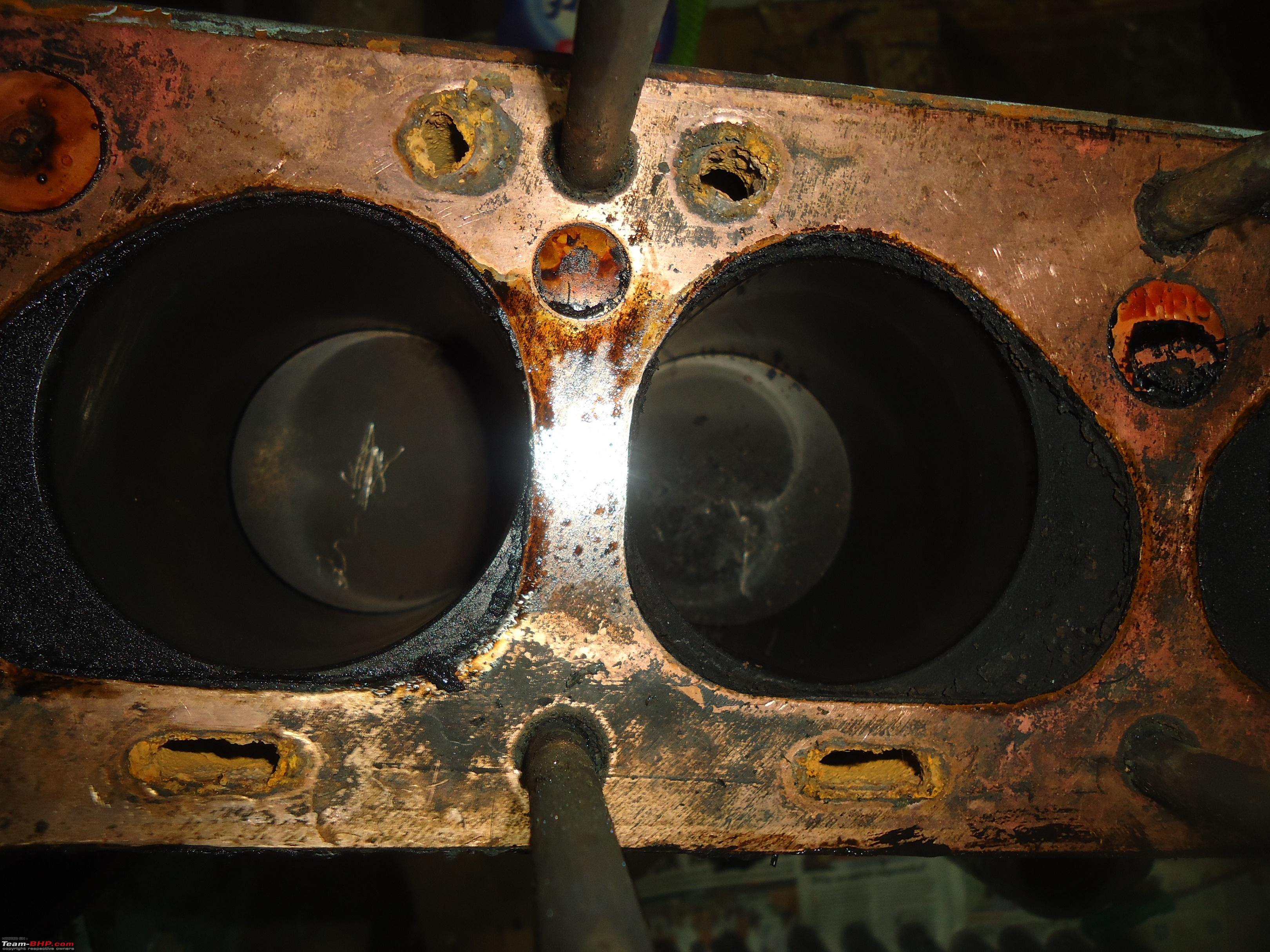

The Head Gasket is blown
The leak between the cylinders due to the blown head gasket is seen
Daimler Tales - 1947 Daimler DB18 Luxury Saloon-6-headgasket-leak-between-cylinders.jpg

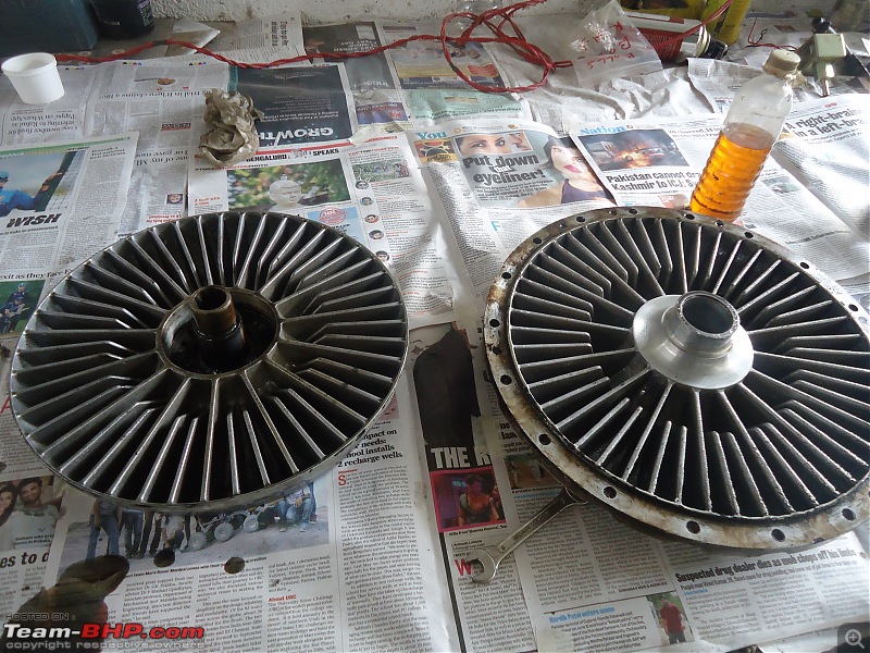

The Fluid Flywheel which houses the torque converters
The fluid flywheel torque converter. For a better understanding, check this link on the Fluid Coupling
Daimler Tales - 1947 Daimler DB18 Luxury Saloon-8-fluid-flywheel-torque-converter.jpg
The two parts of the fluid flywheel

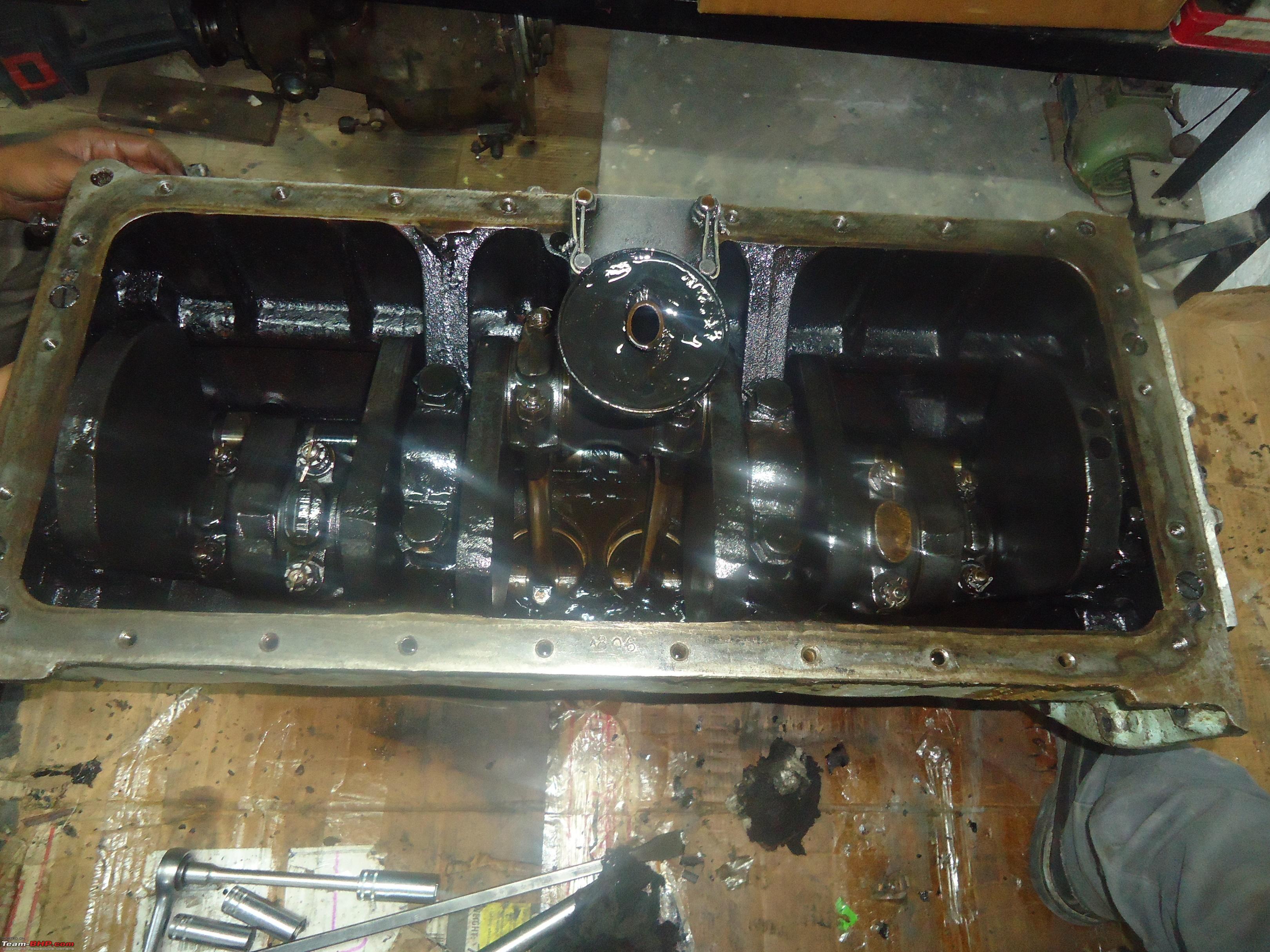

Sump cover
As expected there was sludge seen, when the sump was taken off.
Daimler Tales - 1947 Daimler DB18 Luxury Saloon-11-heavy-sludge-buildup-engine.jpg

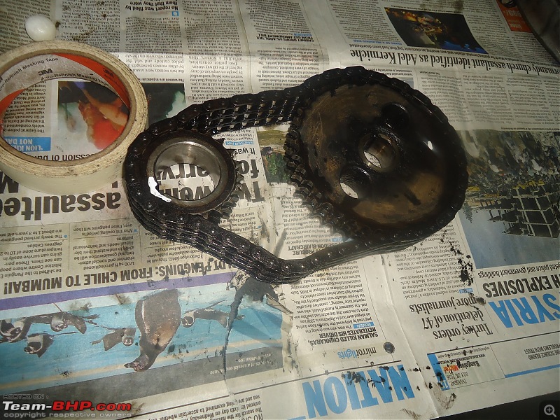

Timing chain assembly
Daimler Tales - 1947 Daimler DB18 Luxury Saloon-14-timing-chain-assembly.jpg

Also, the sprockets for the timing chain appear to be secured by key/keyway on the shaft/sprocket. Did you find signs of fretting or wear, and did you need to renew the key or build-up & machine the keyway?

The cylinder pressure leak down test - have you decided if you are going to resolve this issue in the #2, 3 &4? The head gasket would, in all likelihood, be changed as it’s a likely source of leakage. My respect for Chris Rodricks increases with each reading of this thread. And so also for your resolve to take no short-cuts – this grand old lady deserves no less!
What was the state of the shaft seals on the fluid flywheel / hydraulic coupling? This last is of interest, since my experience with a Caterpilar engine torque convertor ( similar principle) on the towing winch of an anchor handling vessel, resulted in moth-balling the winch altogether as repairs would be too expensive for the owners!

Originally Posted by shashanka (Post 4247575)
Just a point of clarification - you mention the suspension with wiring........
I am replying after checking with Chris.
The Luvax Girling shock absorbers are the fixed orifice type PR6, without electronic plungers, as did come on high end British cars.
For wiring we will use new fire proof insulation that is available and fenolex wiring. Looks a lot like the original finish. We will not be using cloth braided wires as that needs to be imported.

The leak down test - part was from the blown head gasket but most of the leak was from compression rings worn one way indicated by the decent compression values of 90-100 psi but horrifying leak down values of between 70-90% respectively.
Also taking into account the 20% remaining life of the main and connecting rod bearings , it only makes sense to do a complete engine rebuild thereby eliminating all issues in one shot.
Assume you are talking about the torque converter output shaft oil seal. It is still in good condition but will necessarily be replaced as it is just not worth taking a chance with due to the amount of work involved to replace it at a later stage . Only one seal is present in this type of converter.
The timing chain sprocket Keyway is just for initial setting and the sprocket is actually held in place by lateral torque from the main crankshaft nut and the crankshaft damper

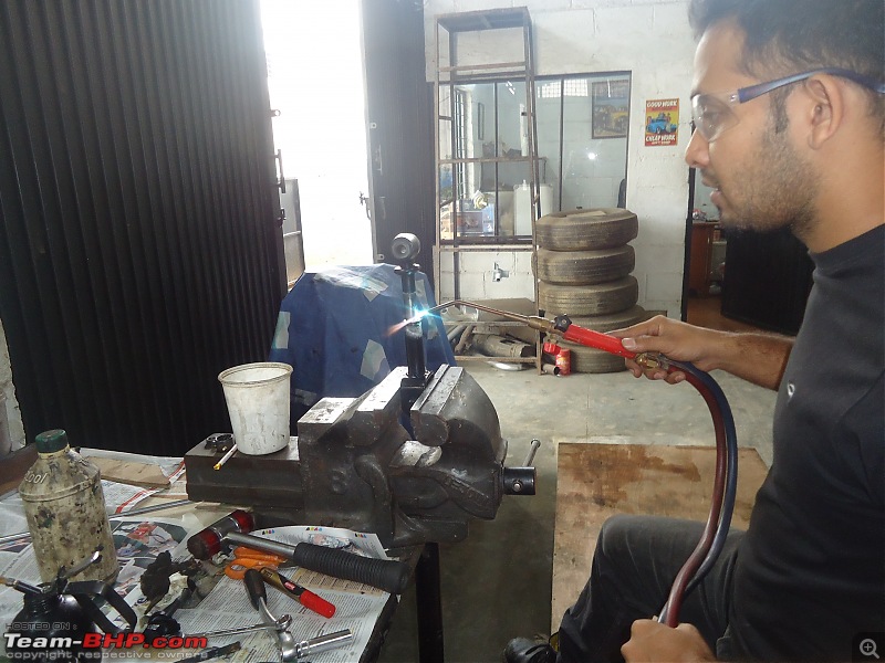

In the mean time, it is most interesting to see Chris, work on one section at a time. He details each and every part and patiently works on it. Chris mostly does the work himself.
A few examples of the detailed work be done
This is the primary transverse link (primary camber)
The ceased part is released
Daimler Tales - 1947 Daimler DB18 Luxury Saloon-1.-ceased-transfer-link-assembly.jpg
Bench setting
Daimler Tales - 1947 Daimler DB18 Luxury Saloon-2.-primary-camber-setting-bench.jpg
Link freed up
Daimler Tales - 1947 Daimler DB18 Luxury Saloon-3.-transverse-link-removed.jpg
Permanent grease is applied
Daimler Tales - 1947 Daimler DB18 Luxury Saloon-4.-transverse-link-greasing.jpg

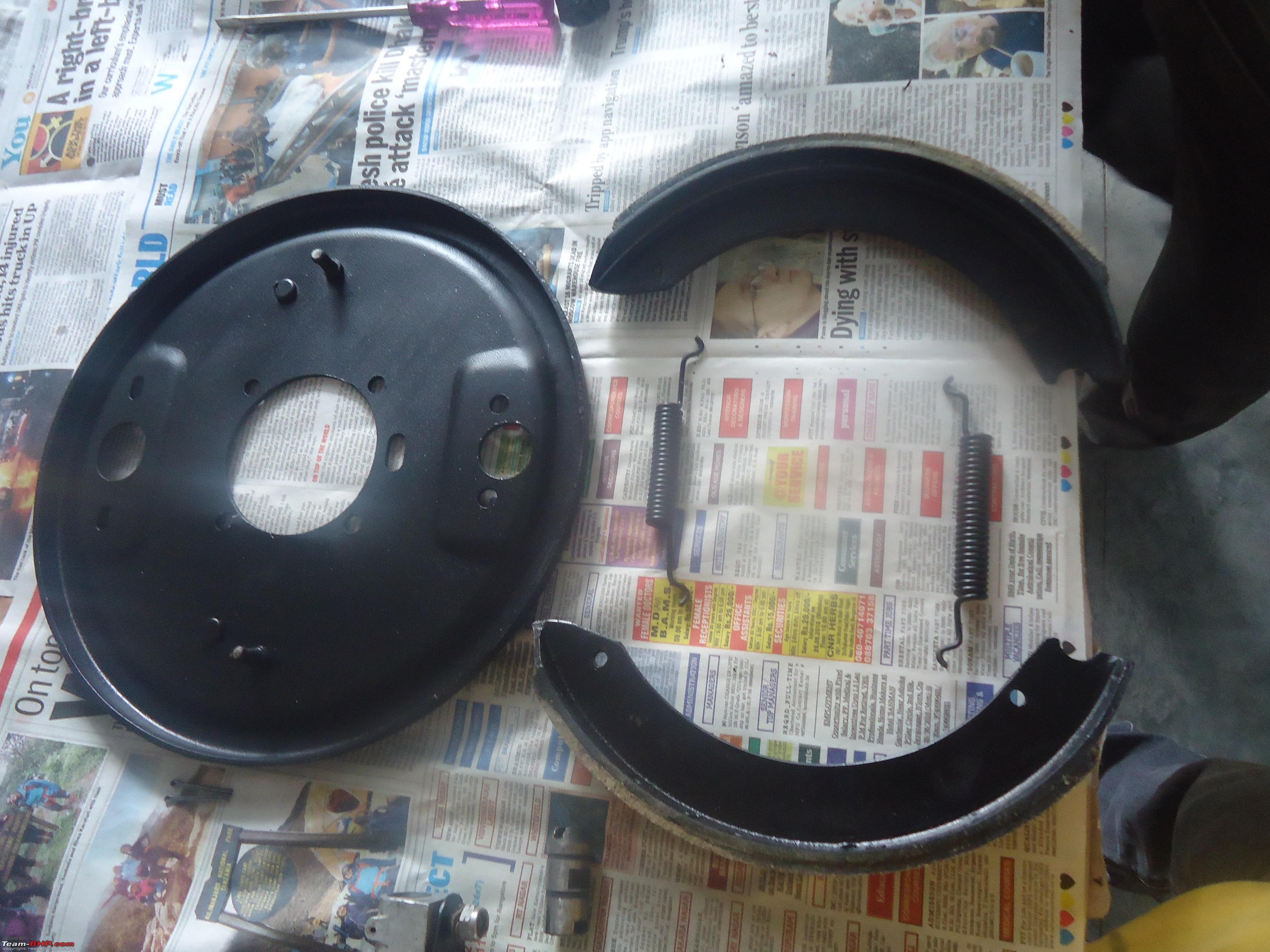

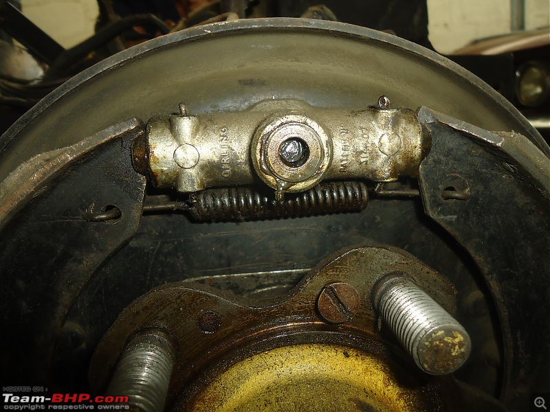

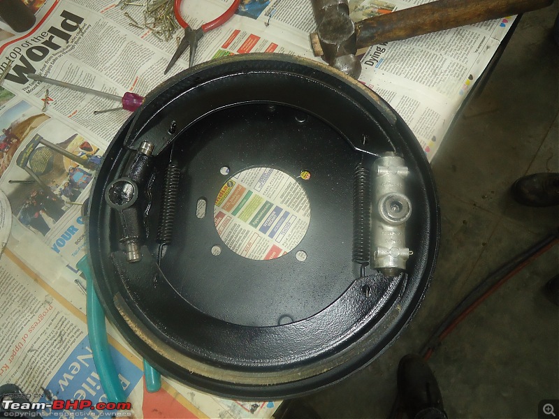

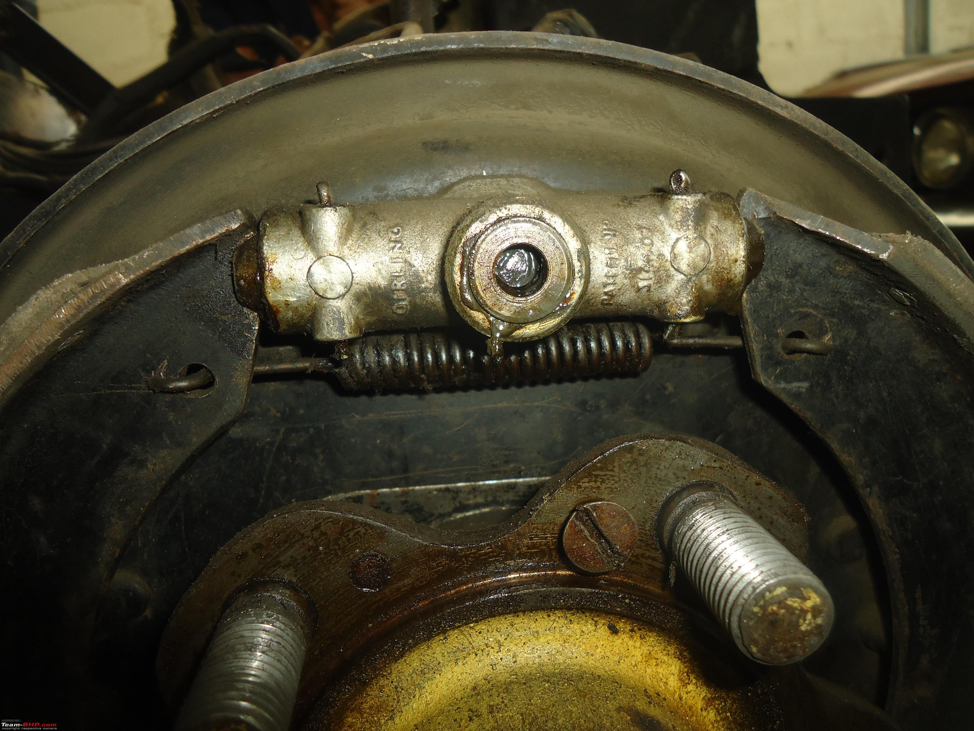

The brakes disassembly and assembly
The completed brake
