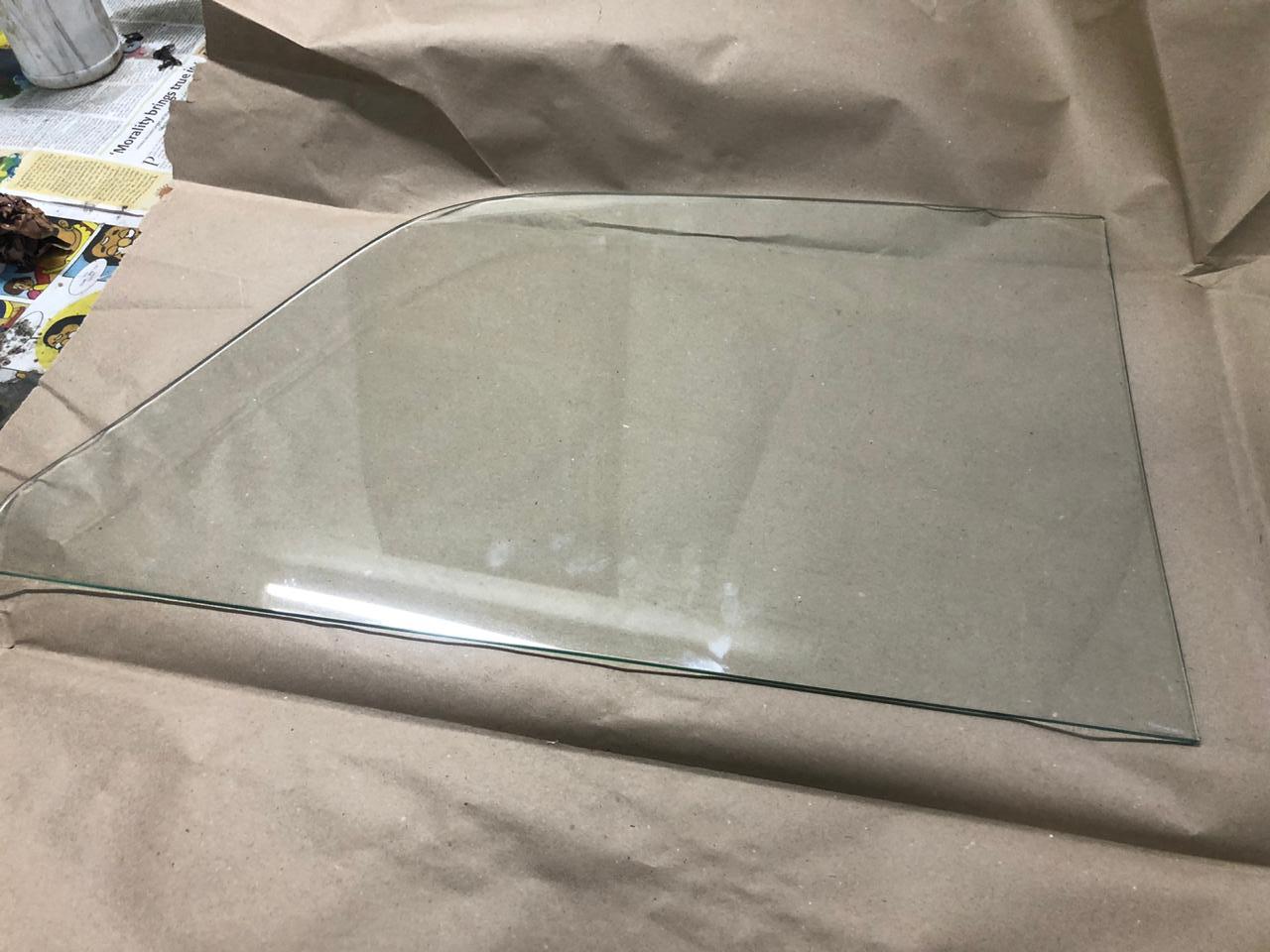

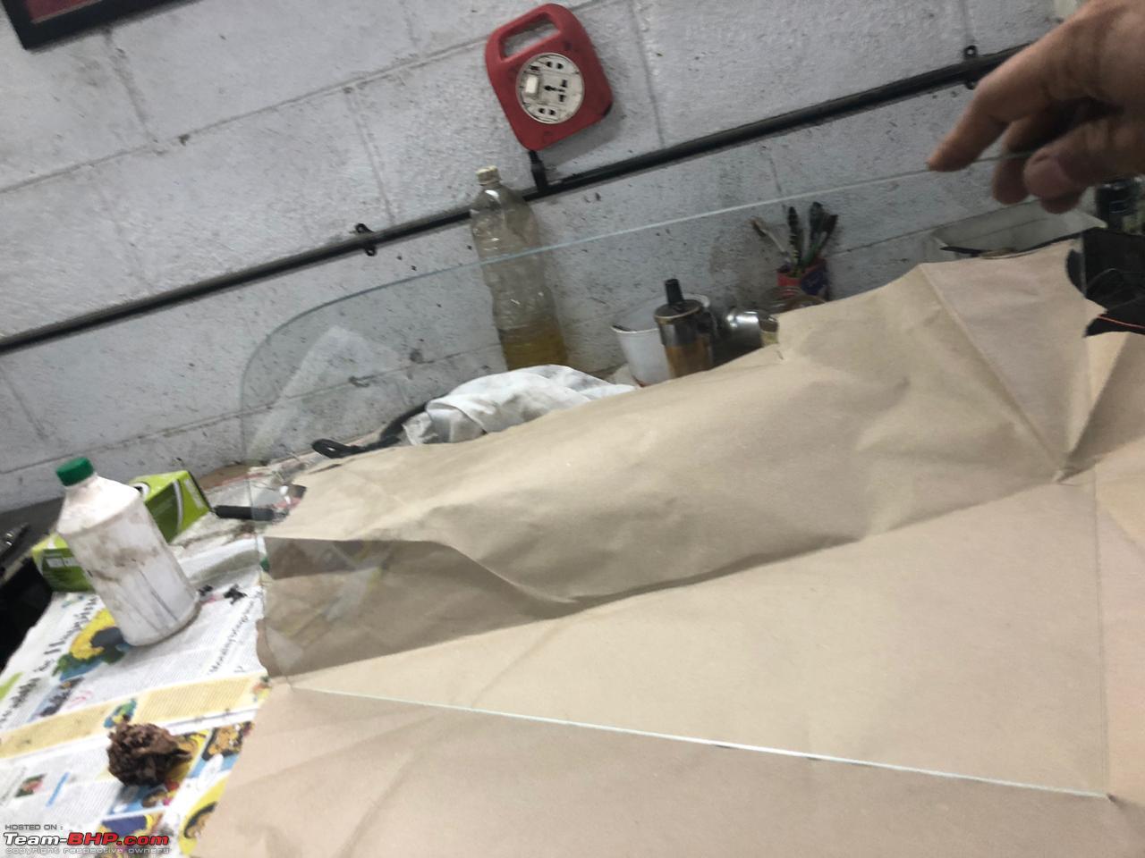

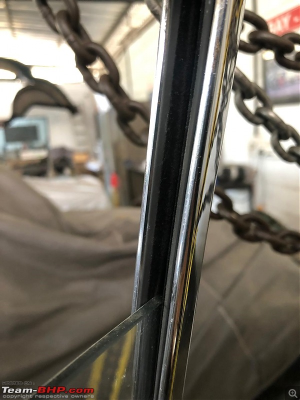

We crossed a big hurdle. The door glass. The old laminated class had turned yellow and was cracked in some places. But we had significant problems in getting new toughened glass replacements.
The problem was the glass was only 4 mm thick and had a double curvature. There was a top to bottom & left to right curve. To heat such thin glass and double curve, was a major challenge. After 3 months of trial and error, we managed to get it right, phew!
Now the tinker can now fit all the glasses and the fittings. The upholster can now complete his work.
The door glasses finally arrives!
You can get the sense of the Top to Bottom Curve. The left to right curve is very subtle
4 mm thick!

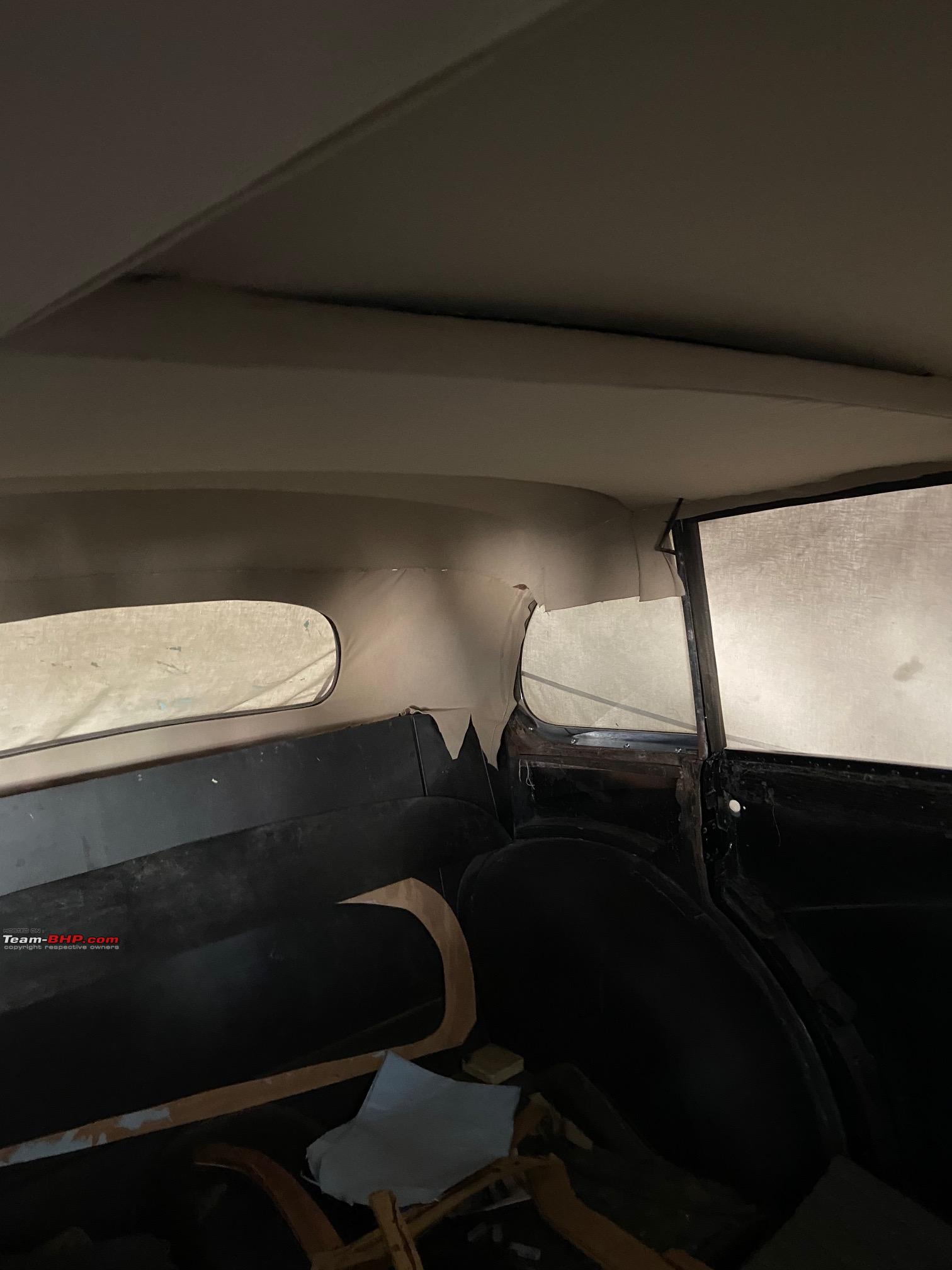

The roof has been completed, the sun roof fixed back.
Looking forward for completing the car by March'2020.

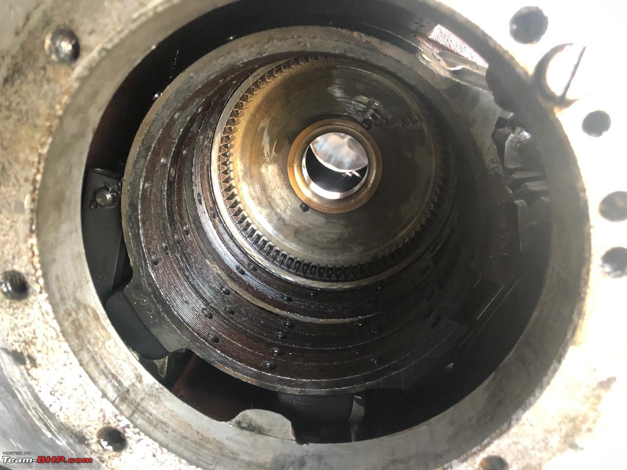

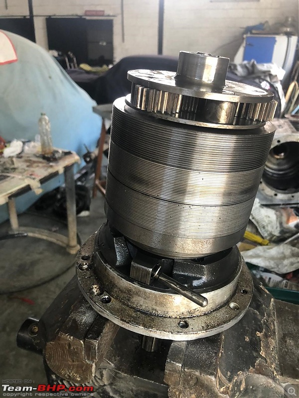

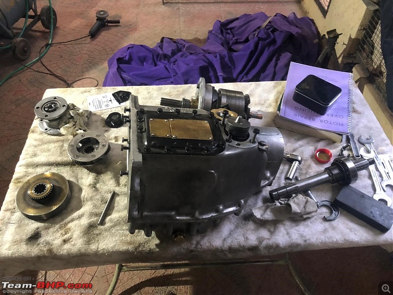

Enjoying the way Chris is restoring the car. The gearbox has been opened up for inspection and rebuild, if required
The gear box appears to be in good shape
Patented Pre-Selector gear box from Daimler

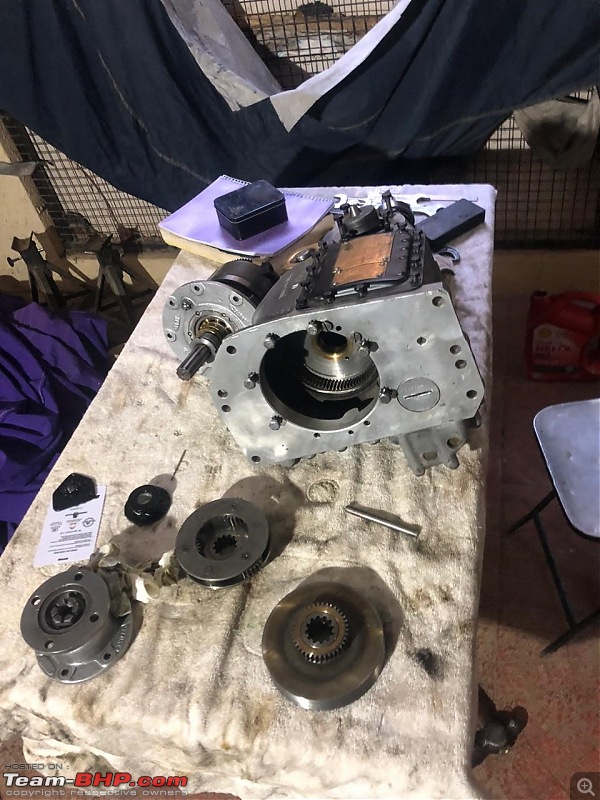

The Coupling
The drive shaft peeps out

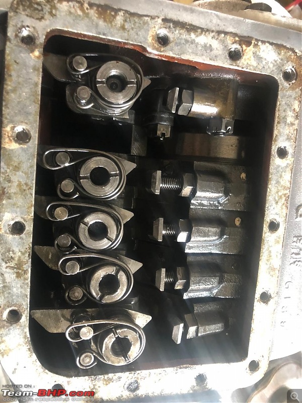

The automatic adjuster spring and nut is seen
The dismantled parts are carefully batched
The inner part of the brake band assembly. They are in great shape

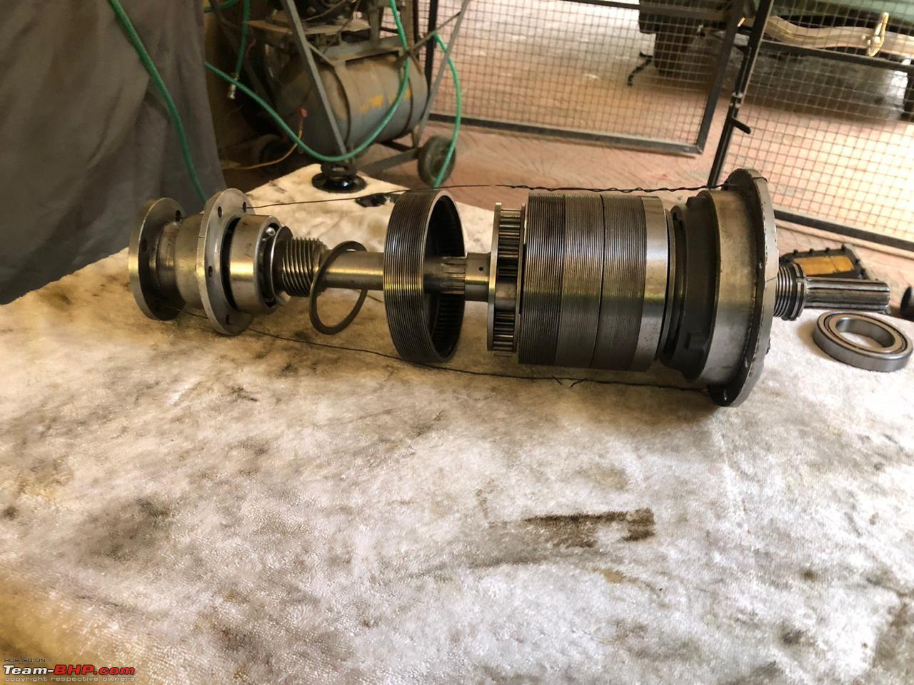

One gets to see the Reverse planets and carrier followed by the Gear Brake Drums
Every thing remains in great condition after all these year. Tribute to the English Machining
The parts are neatly laid out for inspection
The gear brake bands
Three are four forward gears and one is for the reverse gear
The whole thing would be cleaned up before the rebuild

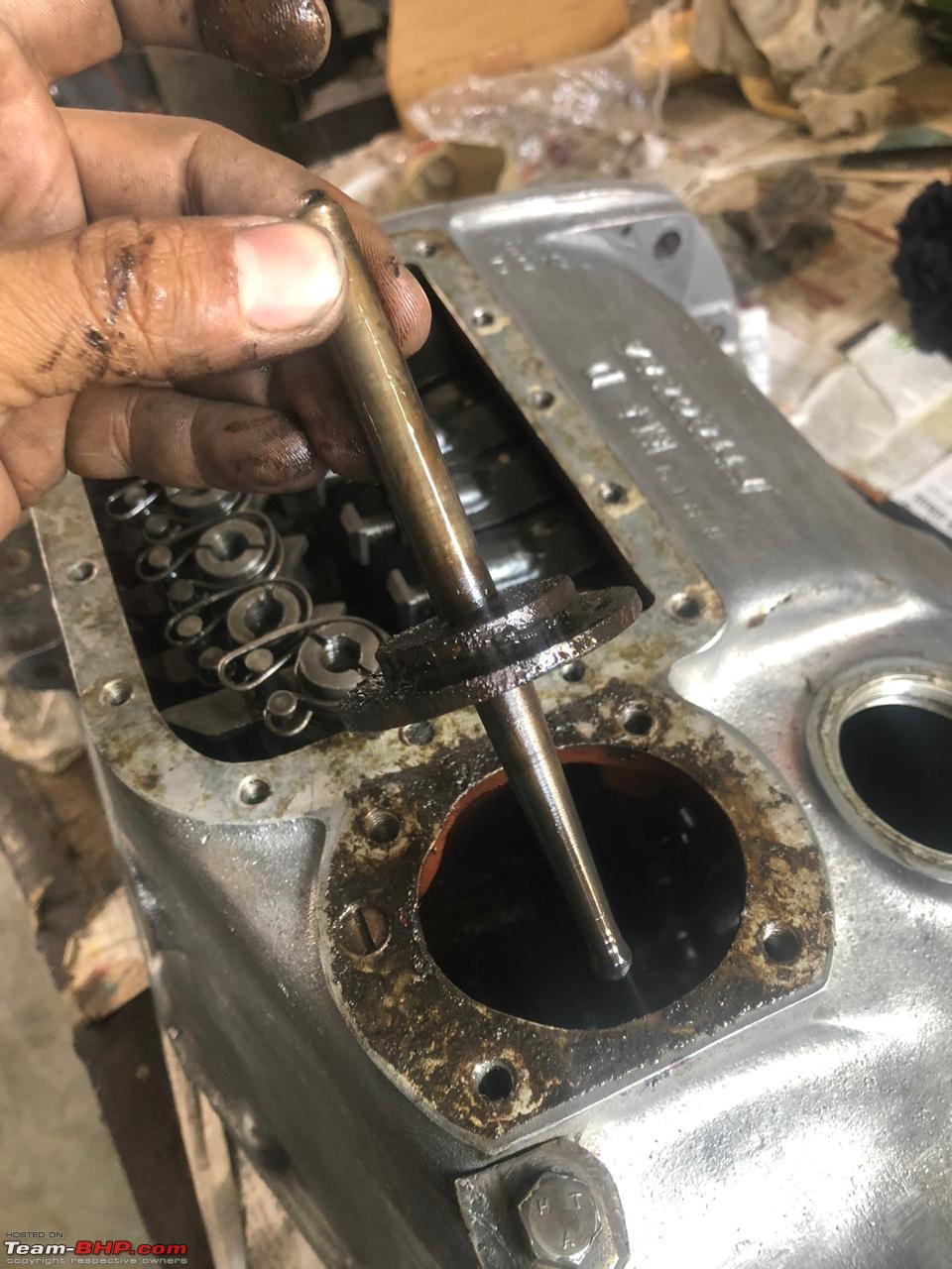

Then we hit an issue with a drive shaft
Reference # 103
There is clear evidence of a torque bend. The means the gear box had temporarily jammed, probably the torque power had freed it
The shaft having a torque bend, is a major issue
We have now have 3 options. One is to fix it back and hope for the best, but we run the risk of it getting snapped under pressure. Option two would be to try and make it in India, or lastly to import the same.
We agreed to try and import as the best option. The machining is so precise on this, it would not be great idea to try and reinvent. The search has begun! Hope the close this out fast.
Chris says the clearances on the gearbox is still very precise. He was was all praises on the build quality.

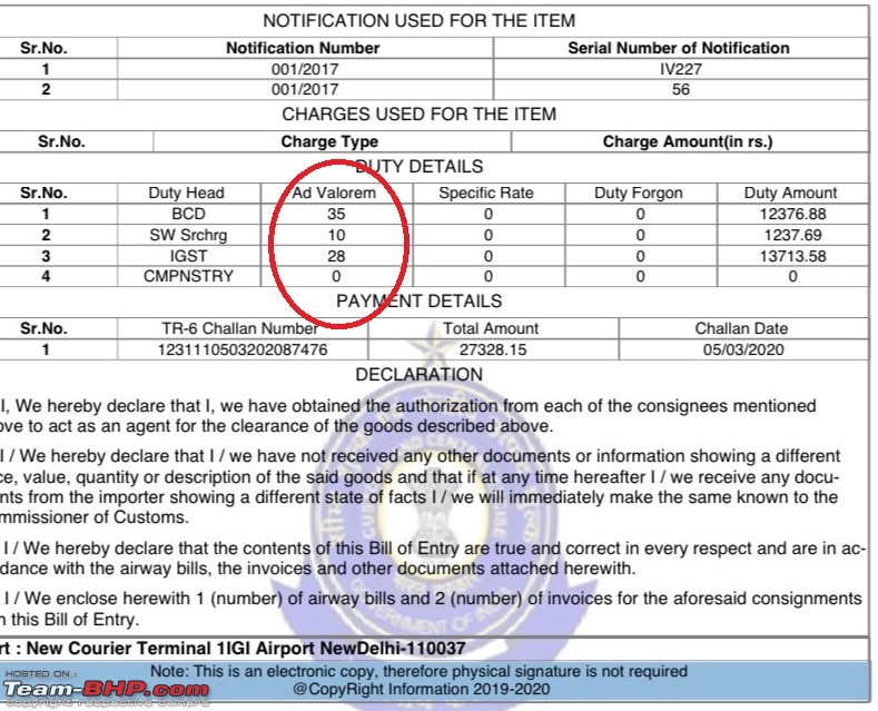

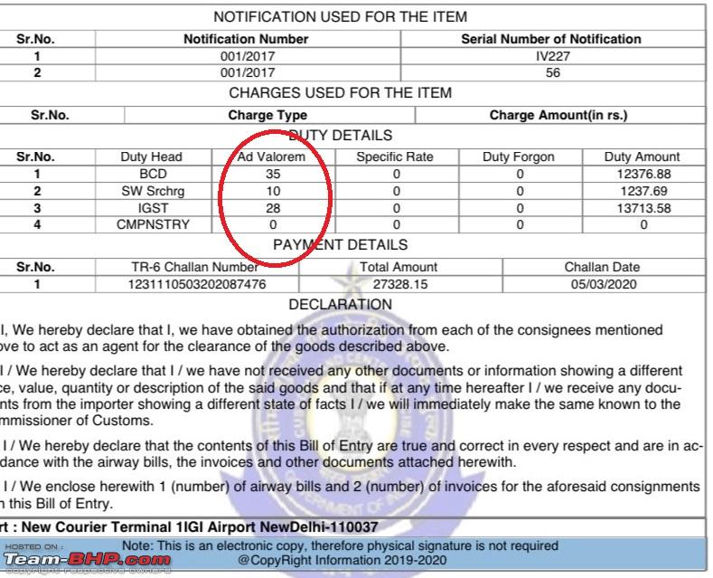

Thanks to Bhpian Mr. Ramanna, who also has a DB18, I was put across to a supplier in London for the gear shaft.
Don Whitehouse of Graham Whitehouse Autos Ltd, was super responsive and I could acquire this part without much delay. Dealing with Don was pleasure as this is a rare part and hard to come by.
This package weighted 3.5 kgs, was promptly couriered and cleared customs after paying duty and clearing charges
Customs duty was high :Frustrati , but we cannot have it our way all the time!
Now the gear box can be completed!

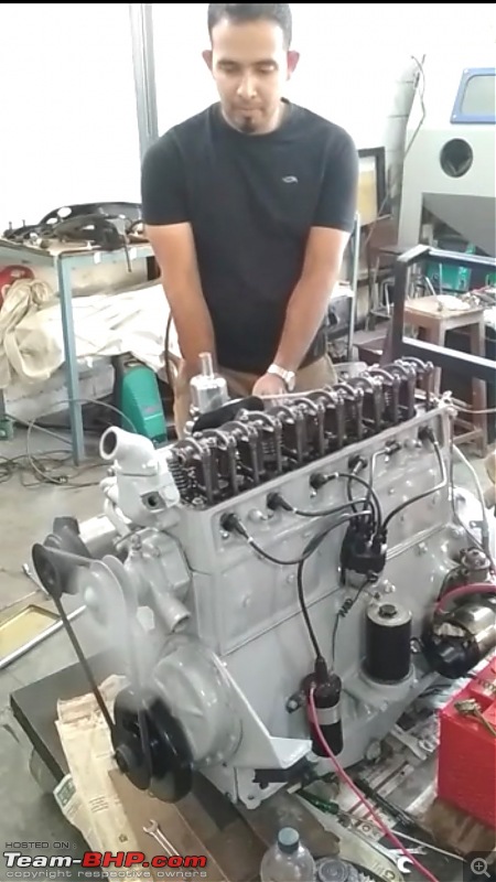

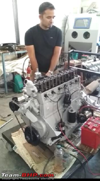

The engine was started in the Bench! Once the gearbox is completed and fitted, the engine will be run and cooled, before installing in the car.
Chris, prepares to start to engine
She starts without a hesitation!
Running well!

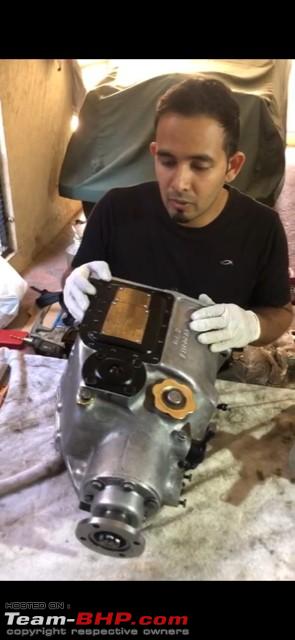

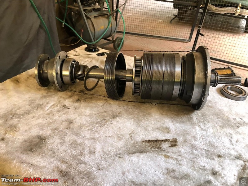

Working from home, Chris was able to complete the gearbox. Fortunately all the parts had arrived before the lock down. The Garage is shut till the lock down ends.
The Wilson Pre-Selector Gear Box coupled through the Fluid Flywheel is used in the car and is explained below
The Wilson gearbox was produced with a variety of clutches. The best-known is the fluid flywheel, used for touring cars such as the Daimler (Armstrong Siddeley used a centrifugal clutch).[2] Sports cars used a Newton centrifugal clutch.[2] This was a multiple plate dry clutch, similar to racing manual clutches of the time, but with the pressure plate centrifugally actuated to engage at around 600rpm.[18] Pure racing cars, such as the ERA, avoided a clutch altogether and relied on the progressive engagement of the gearbox's band brake on lowest gear when starting.[2] When fitted with a centrifugal clutch or fluid coupling, starting from a standstill involved simply selecting first gear, then the clutch would automatically engage once the accelerator pedal was pressed. On other cars, the gear change pedal functioned like a clutch when starting from a standstill.
The Wilson gearbox relied on a number of epicyclic gears, coupled in an ingenious manner that was also Wilson's invention. Successive gears operated by compounding or 'reducing the reduction' provided by the previous gear.[19] A separate epicyclic was required for each intermediate gear, with a cone clutch for the straight-through top gear and a further epicyclic for reverse.[20] Four gears were provided, at a time when many cars (especially American ones) usually only had a three speed gearbox. This was owing to the sporting, or indeed racing, market for the Wilson gearbox, so that the ratios could be more closely spaced. Although this same arrangement of epicyclics would become the precursor for the post-war automatic transmission,[2] the automatic transmission's use of a torque converter, together with the broad power band and excess power of US V8 engines, meant that wider-spaced, thus fewer, ratios were acceptable. Unlike the "crash" gearboxes of the first half of the 20th century, the gearwheels in a preselector box are permanently in mesh in an epicyclic layout.
Source
The parts taken home and set up on the work bench
The assembly starts
