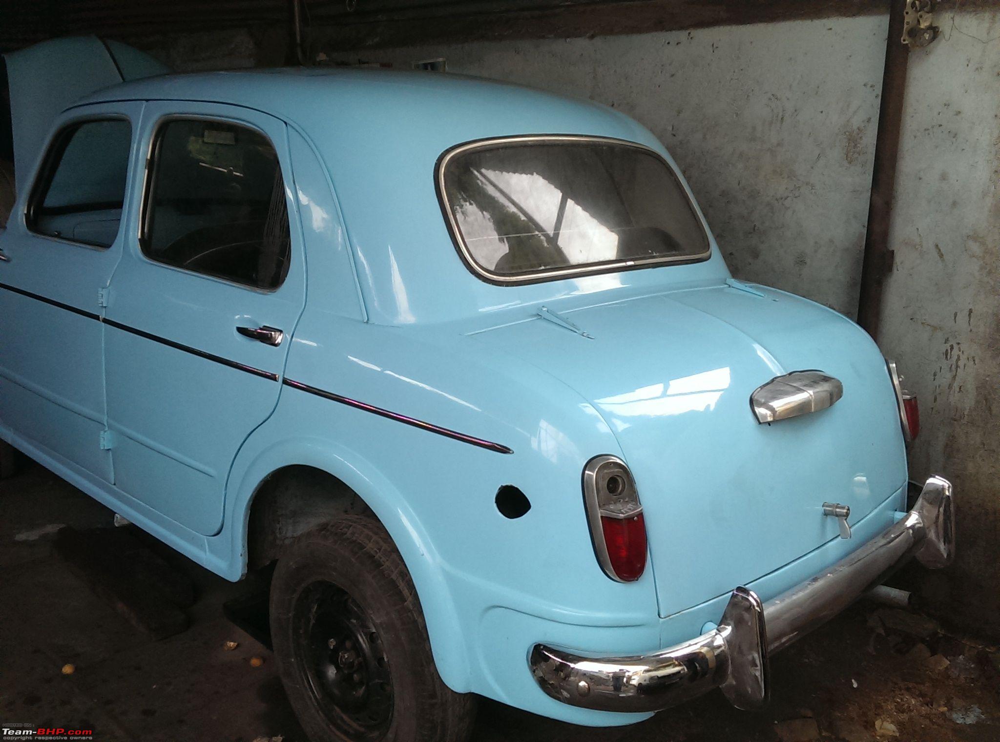

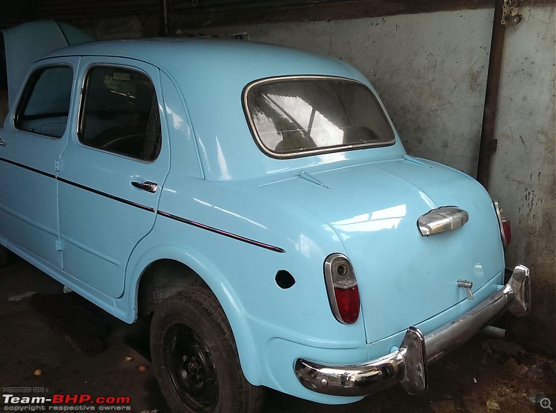

Thanks Amol. The car is with the mechanic for brakes adjustment and tune-up. Meanwhile here are a couple of snaps taken at his workshop. There are still a few things that are supposed to be done on the car and I shall be getting them done one at a time as getting the car back home is my utmost priority. The denters here weren't able to successfully convert Bigger HL to a Smaller One, so without undoing what ever they have done, I have put in larger HL dome's for now. Once the car comes home, we shall discuss.

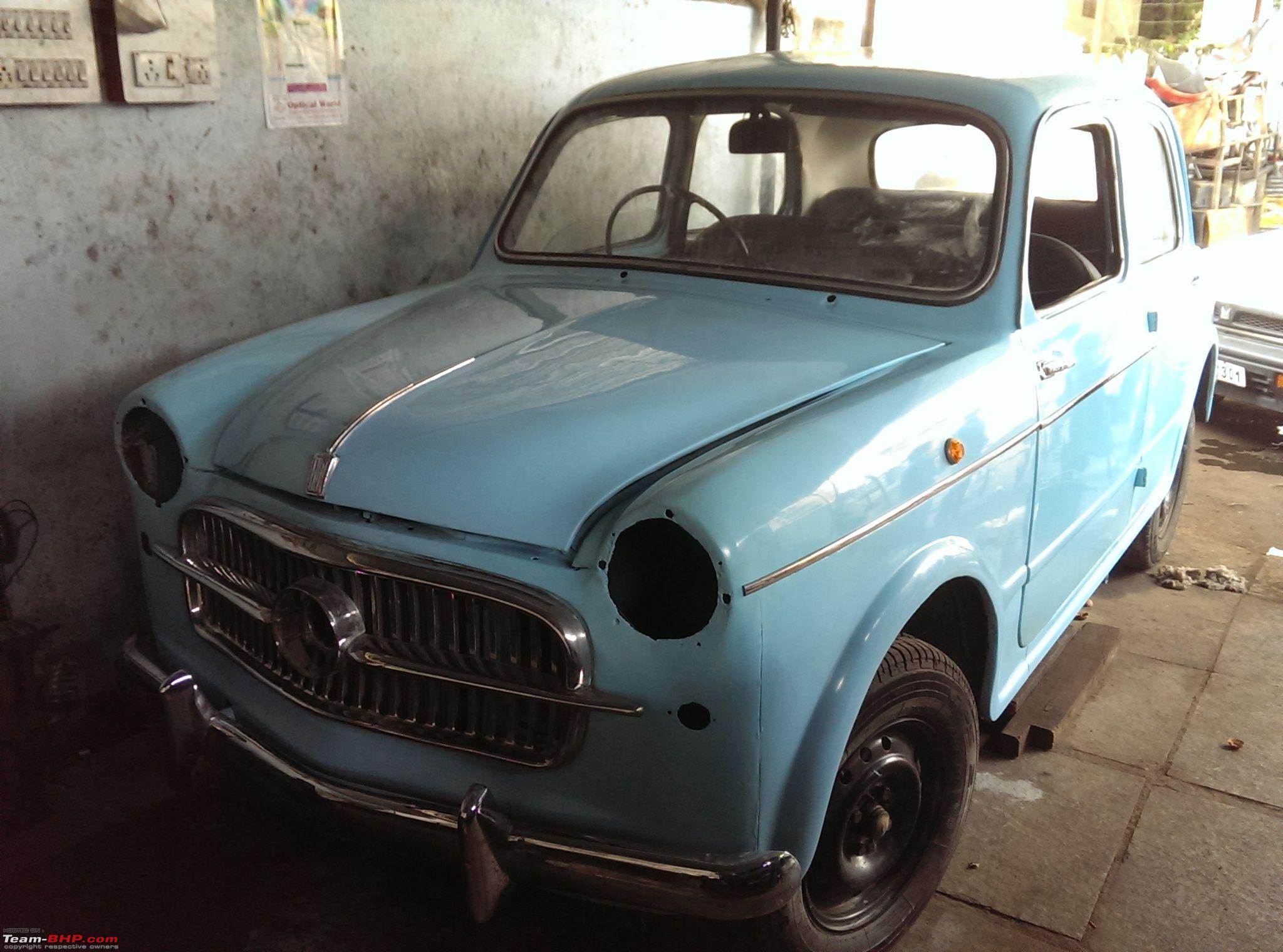

Hi Mr. Cyberdoctorind,
sorry to address you like this as I am not sure of your name. Anyway was going through your thread for the first time today. I did read it from page one through to the 13th. Only Realized the the gap between the 12th page & the 13th page was 3 yrs!! That is called dedication & perseverance. Realized the pain you took to get the headlight corrected from the bigger ones to the smaller ones. I Have gone through this myself, check out my thread " RESTORATION OF MDN 6494 - IN REMEMBRANCE OF MY FATHER ".
Finally I did get it corrected to the smaller ones, with the help and suggestions from fellow Team-BHP'ians like Prashanth, Mole, Manish, Sonu etc.
But the correction was painful, I had to redo the tinkering work on the headlights nearly 3 times. Twice I had to cut the whole metal sheet off and get the whole process to start from square one.
Being a doctor I had to do lot of home work on this as engineering and mechanical work was Greek & Latin to me. To start with I got the head light rings fabricated in aluminium through VMC. Even though I did not get them 100% correct, I got at least 95% correct, except for some irregular finish on the surface of the rings which was unavoidable as per the engineering lathe work guys. Then got the fenders converging onto the rings, initially the edges were to sloppy had to tap them up then had tap them down and so on!!
Even when i did not get it correct the 2nd time was wondering what to do, that was when my medical knowledge came of help to me. Remember when you break your bones we put a plaster of paris cast, i used the POP cast material to make a mould from mid way of the fenders to the edge of the headlight rings from one of my friends millecento here ( I thank him whole heartedly ) & gave it to my tinker to tap it according to the shape of the mould. so finally got to the present shape.
Even now i was told that the right side is slightly more rounded of than the left. Thinking of getting it corrected during the putty work before the final coat of painting takes place.
So getting this head light corrected is not an easy job. If you are lucky like Sonu to get hold of the fender piece from the scrap yard, you can just cut it out and place them there and tinker it. Other wise correcting the existing body is a time consuming and tedious job and also you need a old time tinker who patiently listens to what ever you say and do it with out any fuss.
I will post some pictures of the headlight restoration after compiling the pictures together as they all scattered around in various files.
