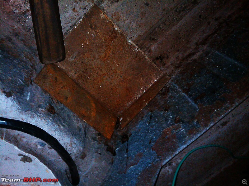

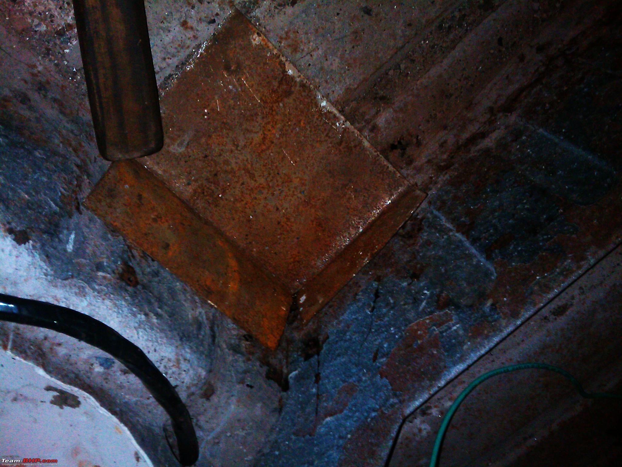

Most of the work being done over the week.
Fresh new tyres go onto the car, suddenly there is a big transformation.
Today the electrician is gonna complete his work.
We are also attending to few rust spots on the floor.

Congratulations on the good work. I just wanted to know one thing and that is was this car exposed to the rain ? Why are you having to re do a bit of the body work ?

No Indro, not exposed to rain, Its like this, initially the car was done on low budget, the car owner did not wish to spend more money and eventually few small spots of rusts on the inside floor pan was negelected, but as the restoration progressed, the guy decided to do it up completely, and started releasing funds
So when the floor panels were done before this weren't they compeletely replaced?

No the floor panels are original, never replaced
It had those tiny rust holes, which the car owner wanted to spray antirust coating and live with them.
But after looking at the progress of the car, his interest levels suddenly shot up.
I was trying for Concurs, but i dont think, with a budget of 50K - 60K for the entire restoration, there is no chance i can go beyond this level.
So will change the thread title soon.
