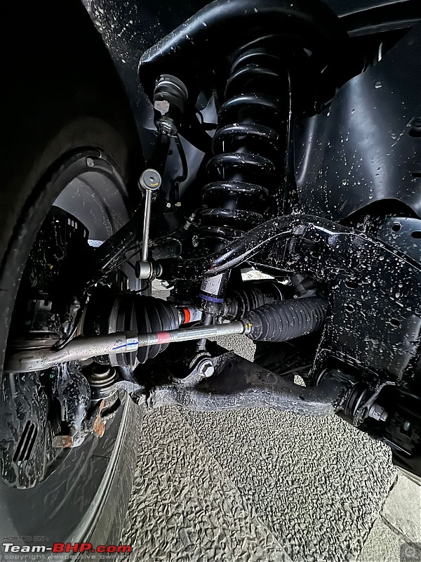

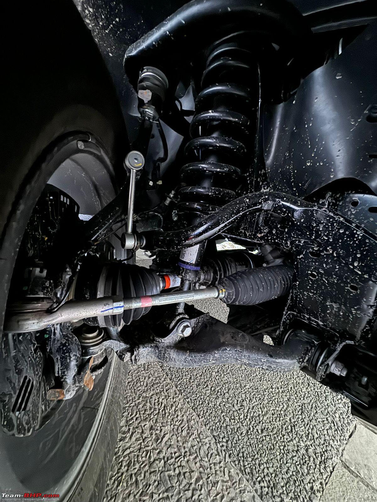

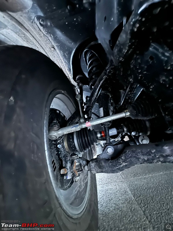

Originally Posted by manasr28 View Post
I own a 2023 June Z6 manual Diesel 2WD which has clocked 5K kms with 90% of it being highway driving.
This is how the suspension setup looks now.
The upper ball joint is what supports the whole wheel assembly, and in case this goes bad, as we have seen on other models for whatever reasons (poor quality/ different brand), there seems to be no other support to the wheel to keep it aligned. Now, I have no experience with such things, but a small ball joint at an angle (or is it the pics) with no cotter pin doesn't look like a great or foolproof design. We will see some changes here - 100% in future by Mahindra.
Though an entirely different segment, here's how it looks in Hilux (many heavy components and additional support at around the middle). Toyota, too, had its share of lower ball joint failures in the past, so this is not the first time.
Mahindra, should do a better analysis of the reported failures, where all failed components are available and issue a proper investigation.

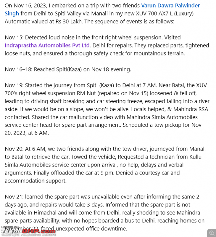

While this is not related to Scorpio N, I'm sharing this here as both Scorpio N and 700 share the same suspension setup. Admins, please delete this reply if this is not relevant to this thread.
Mr. Gurdeep tweets about his suspension nut failure during his trip in Spiti on Nov-19, which was inspected and tightened by Mahindra service on Nov-15th. Unfortunately, the details of the failure (and how Mahindra addressed it) is not publicly available.
The initial response from Mahindra/Service centre in Himachal was not up to the customer's expectations. But it looks like the company did expedite fixing the car after escalations. He recently updated his LinkedIn post, which seems like coercion from Mahindra as part of fixing the issue.
