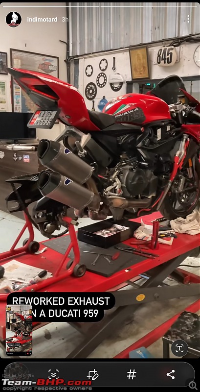

Titanium Midpipe to decat the bike and make the last time installed Slip on convert into full system.
Mark 13 | My Pre-Worshipped Ducati Panigale 959 | EDIT: Now Sold-mid-pipe.jpeg
Installation for both was done at Indimotard, though I found the cost of accessories installation at a bit higher side, I am very happy with the worksmanship and how I was kept informed during Installation. During Installation I got to know that the servo buddy that I had got from US is not going to fit as sockets are different for EU spec bike compared to US bike. Had to order Healtech servo Eliminator to take care of the check engine light.

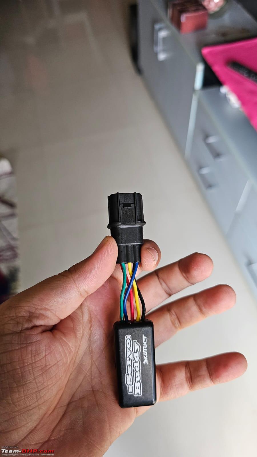

US Servo Buddy
Mark 13 | My Pre-Worshipped Ducati Panigale 959 | EDIT: Now Sold-whatsapp-image-20231129-7.25.13-pm.jpeg
Healtech Servo Buddy.
Mark 13 | My Pre-Worshipped Ducati Panigale 959 | EDIT: Now Sold-healtech.jpeg
Bike getting the midpipe installed, notice the samco pipes Installed.
Mark 13 | My Pre-Worshipped Ducati Panigale 959 | EDIT: Now Sold-indimotard.jpeg
Bike has really come in it's own after the full system Installation and now breathes fire (literally) and makes pops and crackles when you cut off the throttle at speeds, it is an Aural experience and a sure shot invitation for cops to come looking for you. The bike sounds very loud during cold starts and then settle downs in a decent Aural experience, I will be putting the DB killers back though. Below are the couple of shorts with bike literally shooting flames.
