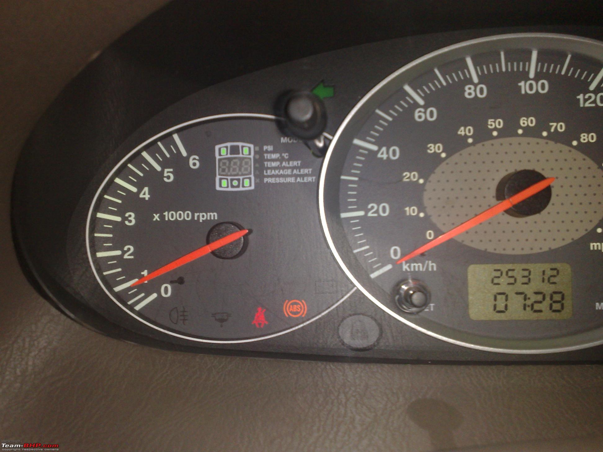

Guys, i am facing a strange problem with my scorpio. this started many days back, but these days it is more consistent.
the problem is that these days, the ABS light blinks whenever it feels like! i mean, when i start the car, the ABS light comes & goes as normal but whilst driving, sometimes it automatically turns on. this does not happen everyday but i have noticed (rather i have a feeling) that the light glows when the car suddenly accelerates/jerks or under heavy braking. on two occasions, by mistake i drove over a large pothole at high speeds & on both occasions the light blinked.
today i drove over a speedbreaker a bit fast (but not so fast that the vehicle bounced or the wheel jerked) & again the ABS light surfaced. so i took a few pics.
i have already shown this issue to the mahindra A.S.S a month back. they checked everything & claimed that everything is fine!
there is no problem with the braking of the vehicle though.
what could be the issue?

Likely causes are:
  1. An electrical connection to a sensor or the main controlling unit inside the bonnet is loose or corroded. Easy to correct, you can unplug each of the connections at the wheels and at the controlling unit, clean them up, and reinsert.
  2. One of the wheel sensors has dirt on it, or has failed. This should show up as a fault code on computer.
  3. Moisture/water got into the electrical connections. Clean them.
  4. A broken wire somewhere in the electrical circuit. Would be bothersome to identify.
Incidentally, did you drive your car in water recently?
Try to replicate the light going on with a technician with you in the car, and run the diagnostics immediately it happens.
Raj, as I'd mentioned earlier on this thread, the issue is with one of the ABS sensors.
Ask them to run a Diagnostic scan (if M&M has one) & then take appropriate action (clean or replace) with the one that shows up an error code.
The symptoms are exactly those of a faulty/dirty ABS sensor.

the last time i asked the A.S.S to check the sensors, they informed me that they checked everything & found it to be normal. unfortunately, i could not stay there & so i dont know whether they attempted a diagnostic scan.
if not, i'll get it done this time. they do have one.
Originally Posted by HappyWheels View Post
This looks more like a faulty sensor to me, especially since it is blinking intermittently.
But Raj, did you do a test of the ABS? Clear road, no traffic, jam the brakes; a suggestion just to make sure ABS is working.
Regardless, a diagnostic at the service center is best.
yes, i did a brake test from speed of 50 kmph & everything seems normal.
