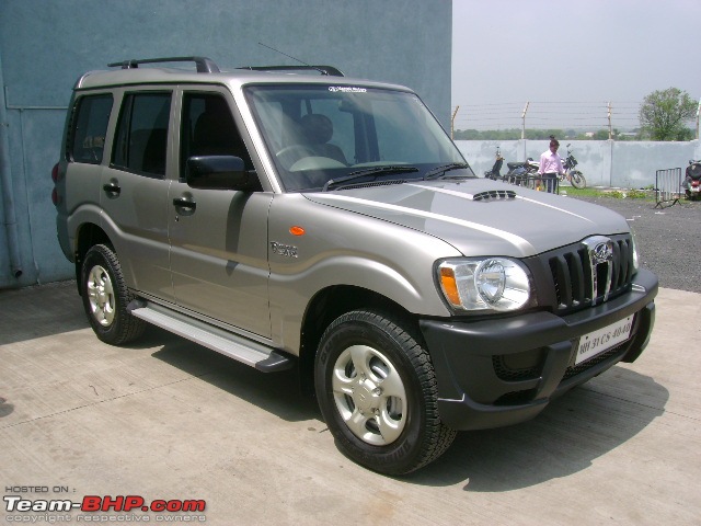

I seek your suggestions for painting the new Scorpio LX bumpers, grille, door handles that are black now.
Was contemplating body colours for the bumper, door handles but was also thinking of painting the front grille diamond white.
Seek your valuable inputs as to whether this will look cool?
Mahindra Scorpio : Issues & Solutions-dsc04260.jpg
Mahindra Scorpio : Issues & Solutions-dsc04258.jpg
This is how the Brute SUV looks now

you can colour the mirrors, handles & grill in body colour but IMO, painting grille in white will not look good. leave it black or else paint it in body colour.
thanks Raj. Will paint it in body colour otherwise.
