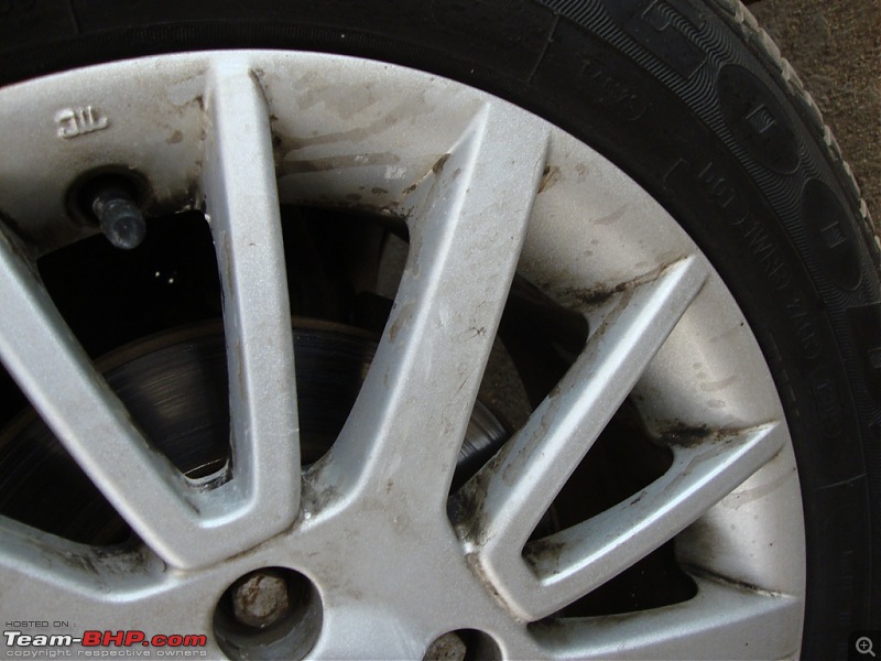

There are few stain marks in my Linea's alloy wheel. Looks like some liquid is being splashed on the alloy.
Tried removing the stain with 3M rubbing compound and later with Diesel but to no avail.
Need your expert help in removing the stain and restoring to its original glory.
Attachment 326711
rubbing compound on alloy stains??? maybe a specialized alloy cleaner like the ones sold by Turtle Wax and Meguiars can help. Maybe even the Formula 1 alloy wheel cleaner
Attachment 326711
Try NC paint thinner. Should work as it worked on my alloys. Handle with care though - that stuff is EXTREMELY inflamable.

[quote=bnzjon;1832221]There are few stain marks in my Linea's alloy wheel. Looks like some liquid is being splashed on the alloy.
Need your expert help in removing the stain and restoring to its original glory.[quote]
EEks! How did it get to this state ? You have not been kind to your wheels mate.
Your alloys are PAINTED. You should treat them like the body of your car. Do not use anything on them which you will not use on your car body. The black mouldy stuff should go away with a wheel cleaner. You can try detailing clay to get rid of the stains. Use the medium one. Rubbing compound of the correct grade should also work. As a desperte measure you can try wet sanding the surface (3000 grit to start with). And then wax and seal the paint.I will recommend take it to your dealer for inspection before sanding it. If that does not work you will have to get them repainted.
