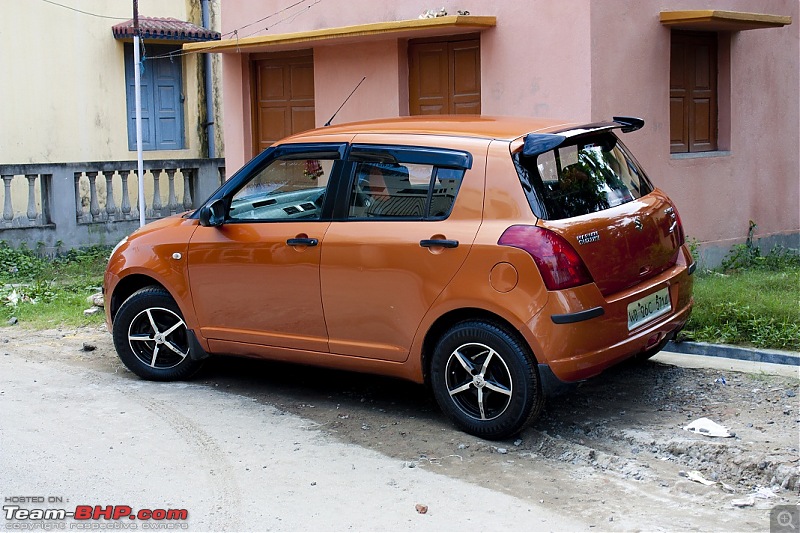

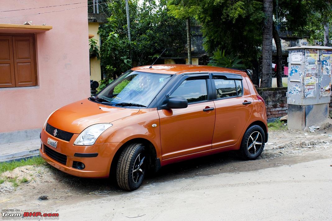

Here goes my swift 2 weeks after applying Collinite 845...

@buntydey : is your car repainted ???
Spot on! The left side rear door was repainted...
