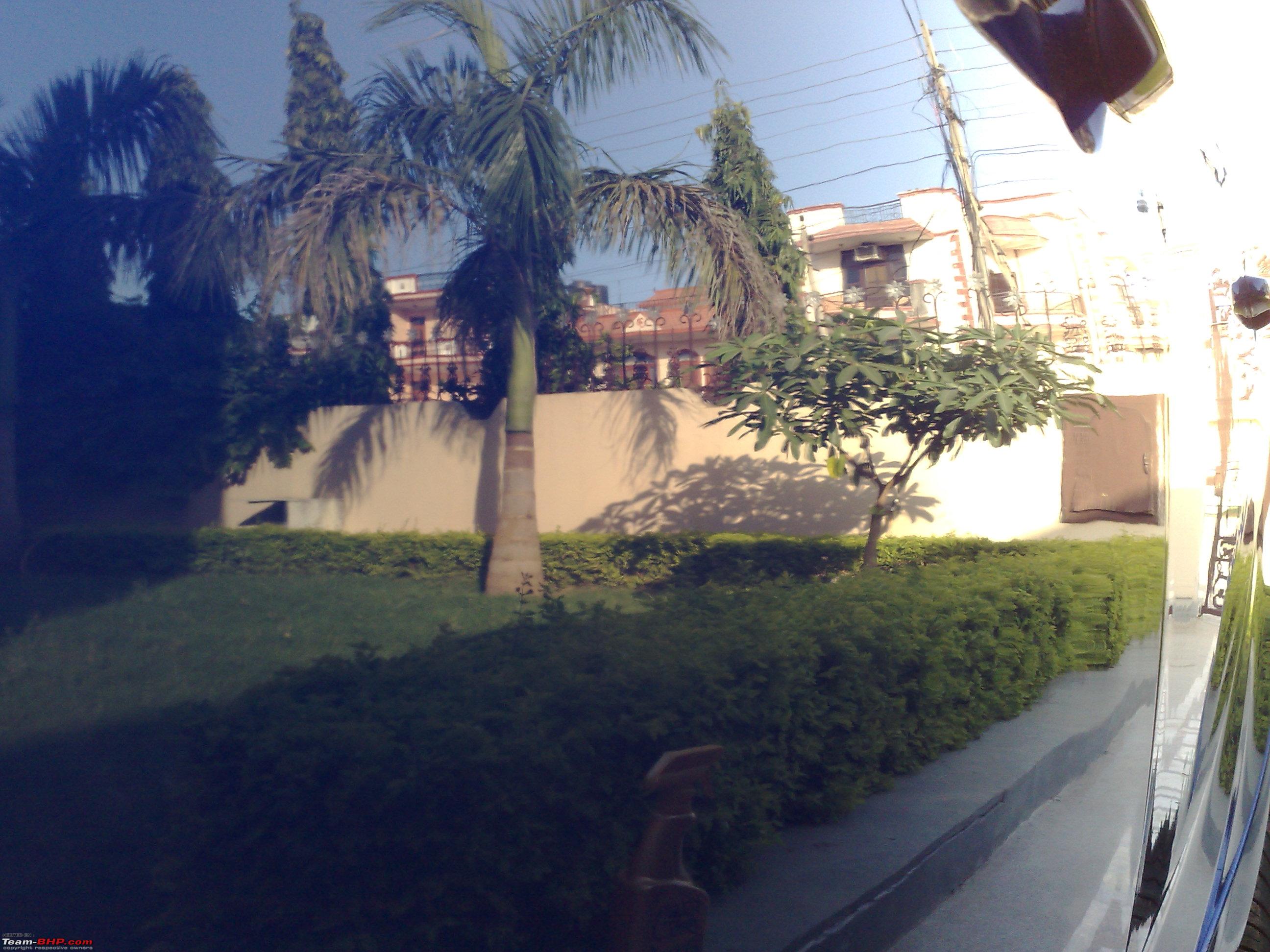

A reflection shot(previously it was totally lacking in clarity)

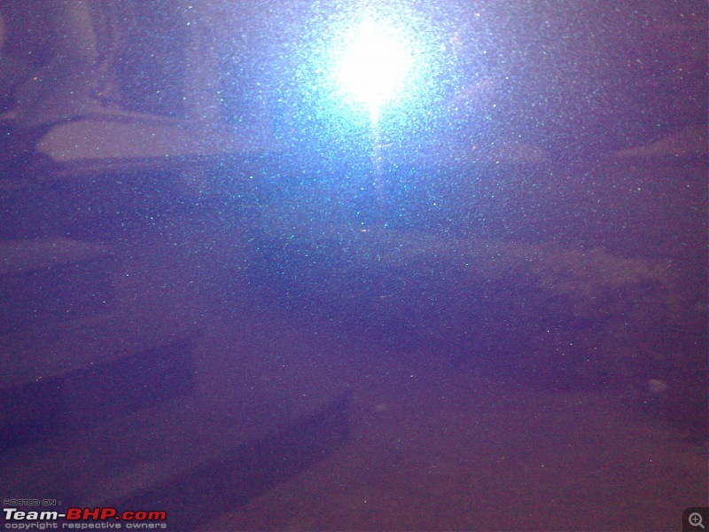

After LSP(unfortunately it was dark then! but I checked out the whole panel with my phone cam\'s flash and didn\'t find any swirl!
Still there is room for improvement!(I'm yet to find the perfect product/pad combo for this paint! I guess the search continues!)
