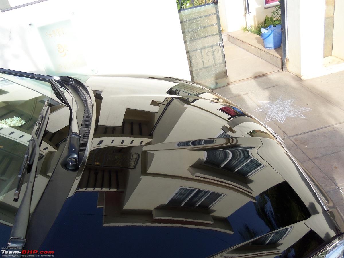

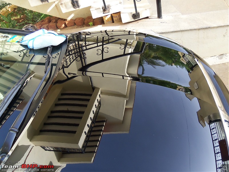

Bonnet and front bumper had taken quite a beating after two visits to Mangalore in rains. The bonnet had lot of swirls too, thanks to the security guard of the office who decided to do me a favor of removing bird shit from the bonnet last week. He decided to clean the entire bonnet after that. I guess he used some kind of rag. The end result was loads of small scratches. So decided to detail the bonnet.
First removed all the contaminants using Elastrafoam sponge. Removed swirls and scratches as much as possible using Megs UC. I used lake Country Orange hand pad for UC. Polished with Megs UP using Scholls white hand puck. Sealed with Fourstar UPP. Left it to cure for 12 hours and finally topped with Poorboy's Natty Blue Paste Wax. The Natty Blue wax gave really deep looks. Excuse the stone chipping marks appearing as white dots on the bonnet.

Fantastic! I should probably be tired of this word now. lol: Those reflections are mind blowing as usual.
