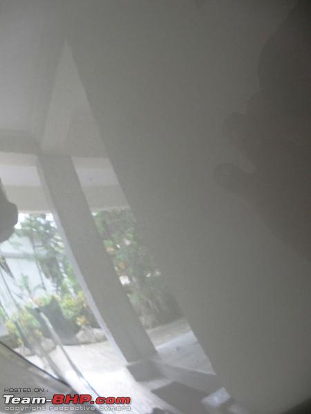

I started exploring the possibilities of machine polishing on my Pearl White Duster.
More details on the products used are in the following post : http://www.team-bhp.com/forum/test-d...ml#post3472687
Following is the procedure followed:
- Washed with Megs shampoo using 2 bucket method
- Used Proklear in 1:1 ratio for tough tarspots, not all were gone,but cleared ~90%
- Clayed, used Amway shampoo in medium mix ratio as clay lubricant. The surface became butter smooth w/o any spots (assured using the plastic foil method)
- Megs 105 compound + LC Cyan cutting pad. Didnt require any scratch removal except 2 by a moron on bike couple of weeks back. Moreover I never allow any service center "detailer" to touch my car not even the washing guys, usually donates the washing amount during every service:)
- Megs Ultimate polish + LC Tangerine finishing pad. Later I will replace this with CarPro Reflect.
- 2 coats of Megs Nxt Gen Wax with a time interval of 12hrs. Later I will be using CarPro ReLoad + a Carnauba wax.
Following are some of the pics during the process:
Before Beading shots : Beading was not sharp at the edges.

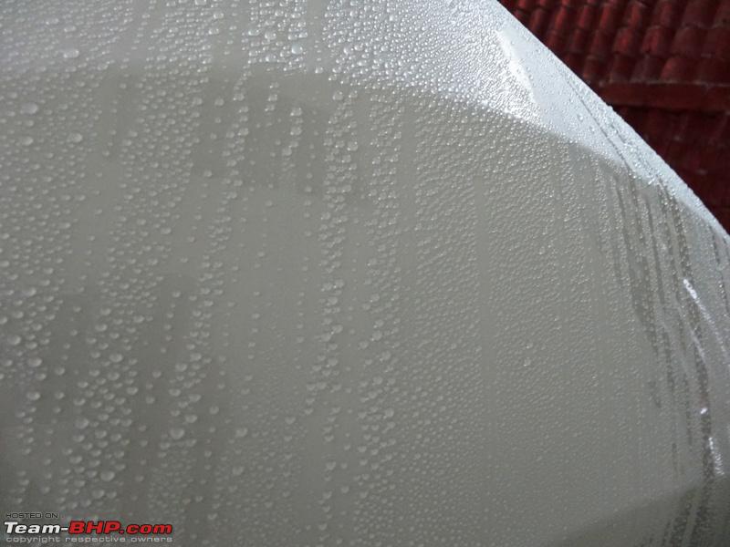

Clayed to butter smooth:

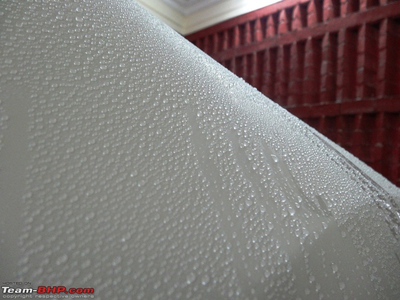

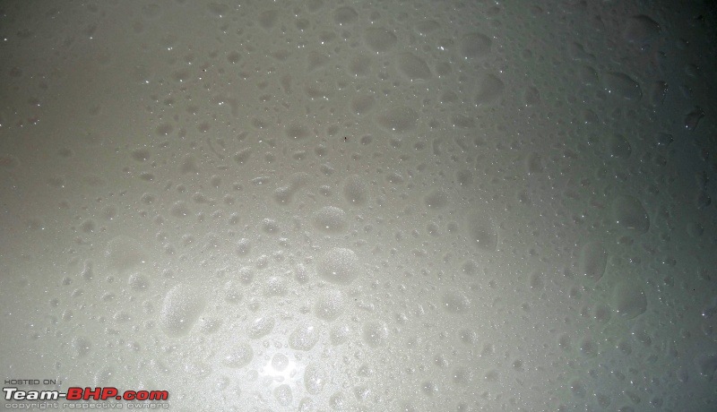

Effect of Megs Ultimate Polish:

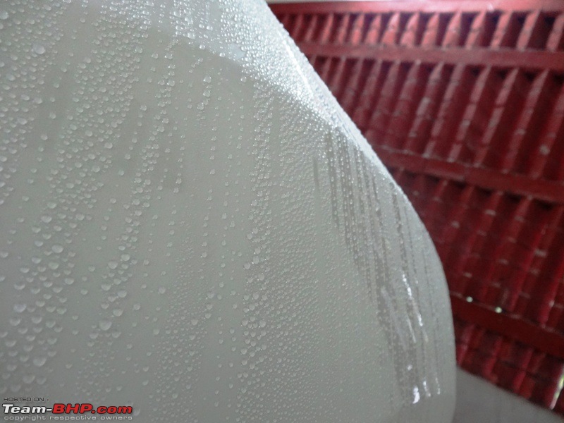

Crazy beading (small and sharp edged) after Megs UP and the Megs Nxt Gen Wax:
