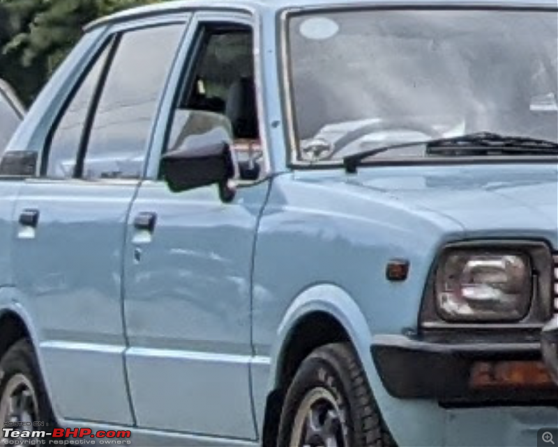

Wanted to know if the shade of blue that it wore before was OEM, cause the Baby Blue one that I bought last year is not the same, and I've seen more of the Baby Blue ones on the road!
Edmund : My car's Rebuild Maruti 800-20230531_200511.jpg
