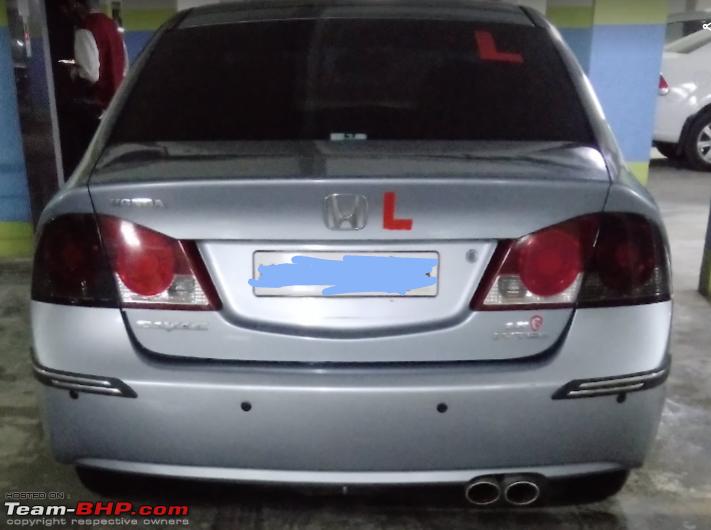

Could see that the cruise control and cruise main lights were blinking. And our car is a manual.
That's promising to hear! Could you confirm whether your car is a pre-facelift or a post-facelift one? To be blunt, the pre-facelifts have round elements in the tail lamps while the post-facelifts have octagonal elements in the tail lamps.

Our car is a pre facelift, I have sent a picture of the tail lamps below:Name:  Screenshot 20211226 7.58.57 PM.png
I think I may get the audio controls fixed as well because we're already diving into so much here, might as well finish everything off
Although I do have to tell you that the facelifted ones came only with the cruise control switches and not the audio control ones.
