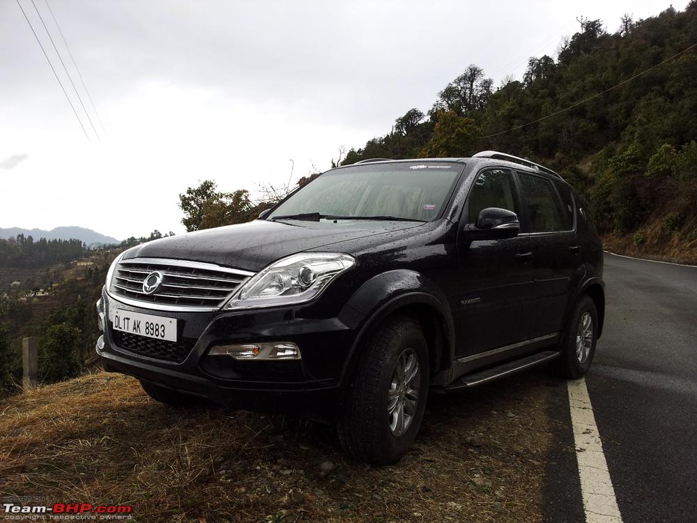

This is about my friend's Rexton MT, i already have mentioned in my XUV ownership thread.
Engine trouble in Mahindra Ssangyong Rexton EDIT: Turbo replaced under warranty-20130314_115646.jpg

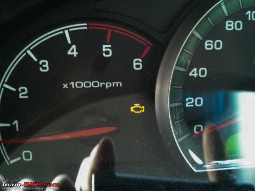

Around some 15 days back, on a highway drive this Rexton lost the engine power(got in safe mode) with the emissions error light. My friend called me to check if i had any clue in regards to this problem, majority of times i had heard of similar instances in a turbo diesel in midst of a high speed drive was due to Turbo hose slipping off /torn.
Engine trouble in Mahindra Ssangyong Rexton EDIT: Turbo replaced under warranty-img20130320wa0000.jpg
I suggested him to switch off the car for some time, and restart it again and see if the car comes out of the safe mode. The car came out of safe for a while and was functioning normally, but went into limp/safe mode over and over again. I suggested my Friend to take the car to nearest Mahindra service center, he was in Hisar(Haryana) travelling on a highway. He took the car to Mahindra service center in Hisar, i was confident that since they sell and support XUV500 at this dealership they will atleast look in to the issue and will try to make the car fit to drive to Delhi NCR. The dealership refused to even look at the car, mentioning how they had clear instructions from Mahindra to not even touch the Rexton. Despite repeated requests stating this to be a emergency visit, they did not budge. Upon my suggestion, my friend called the Helpline, they suggested him to drive the car to Delhi/or get it towed before they can attend it.
