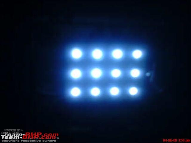

Hey guys,
Not seen the Safari thread, this is installed in my car into stock unit.
