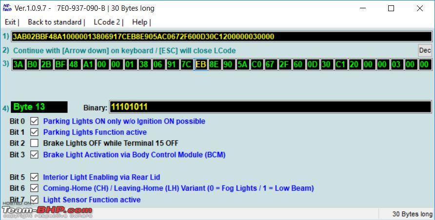

Can anyone please confirm whether the fog lamps of Polo are connected through BCM, and if yes whether the leaving/coming home feature could be activated on fog lamps? I think the cornering lamp function using fog lamp can be altered using VCDS, hence checking the possibilities of enabling others functions with fog lamps as well. I do understand that the headlamps in Polo are not connected to BCM, hence the query is specific to fog lamps.
Yes. The fog lamps are connected to BCM. But the coming/leaving home lights are based on headlights. So I don't think it is possible to use the fog lamps for coming/leaving home lights.
Thanks, Ganesh. The reason I asked this question is after seeing the following option. Guess it wouldn't work then. Also, just remembered that for cornering lamps to work, the headlight switch has to be on as well.
I have upgraded the BCM to high variant for my BiXenons. I unchecked this option in my car and I am able to see the fog lights work for the CH/LH function. Headlights work as CH/LH when this option is checked.
VCDS (Vag-Com Diagnostic System) for VW & Skoda - Discussion Thread-ch-lh-fogs.jpg
But this is possible only if you have the LH/CH functions enabled in a previous screen.
VCDS (Vag-Com Diagnostic System) for VW & Skoda - Discussion Thread-ch-lh-active.jpg
Check the previous configuration screen (for Byte 10) and see if you have the options to enable LH and CH functions. If available, enable it and see if CH/LH work with fogs.
