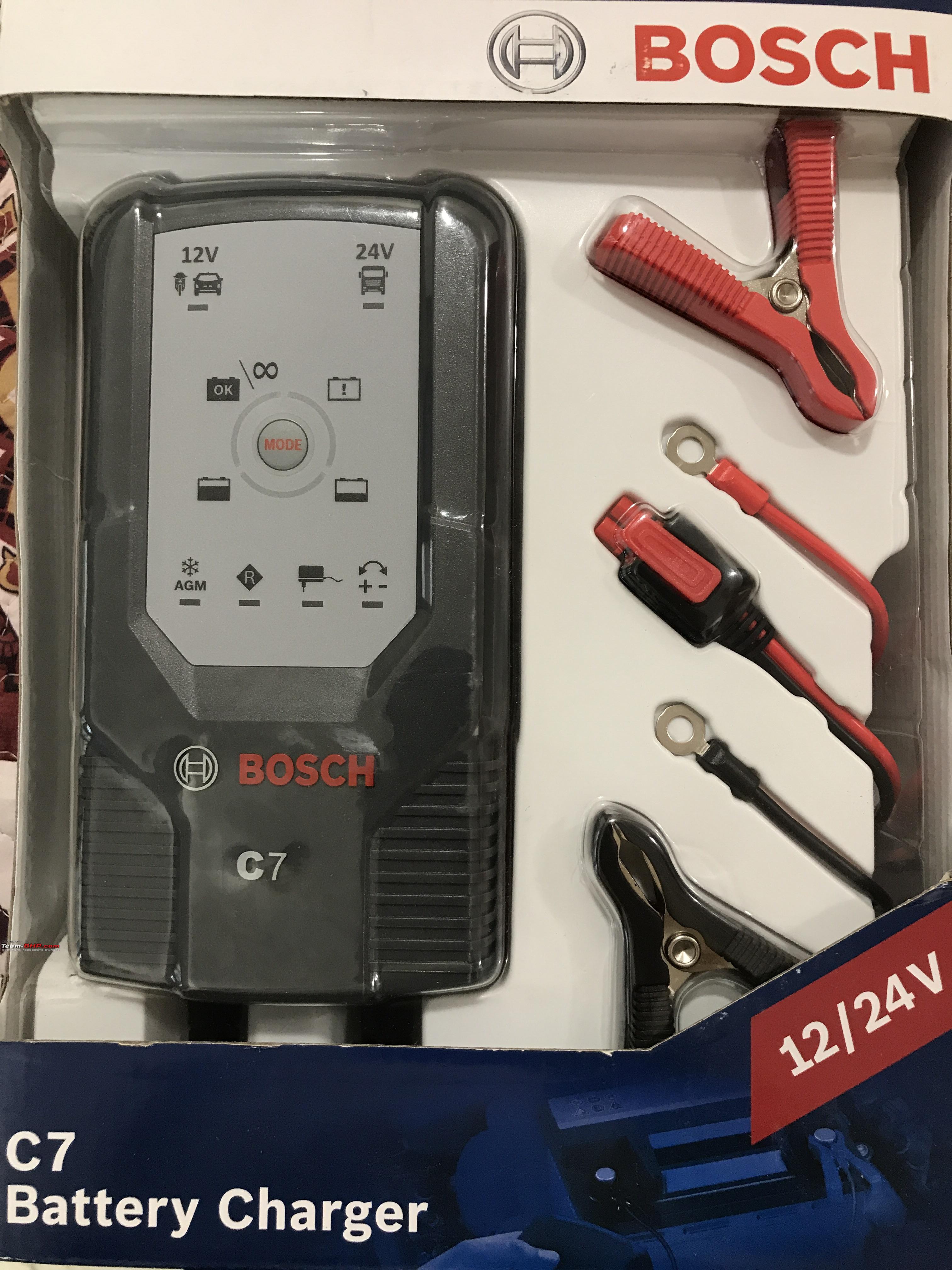

After reading this review, I finally bought the Bosch C7 Battery Charger from Amazon.
Ownership Review: Bosch C7 Battery Charger-1image.jpg
embee is offline   (2) Thanks
