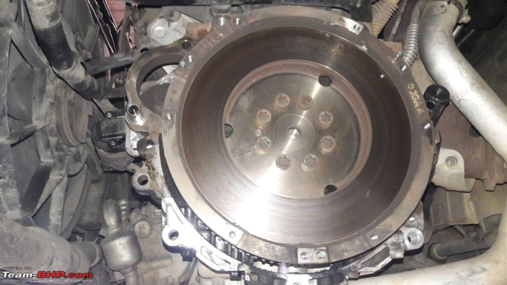

Hi Folks,
My i20 elite (Sep 2014, diesel model) has run 64000 km. It runs 90% within Bangalore, mostly in dense traffic. Since May 2020, my father's been taking it to work, with a driver-cum-attendant from his office coming to drive Dad to work and back.
The clutch used to harden up after driving for about 1.5 - 2 hours in Bangalore traffic. Not too hard, but hard enough to be exhausting. Also, slight sound would come when depressing clutch - probably a spring noise.
Visited HASS in July 2019 (ODO ~ 60,500) for regular service. He said clutch might need greasing and it would be better to do that at next service, along with clutch to be replaced.
I used WD40 near the clutch pedal and near the clutch cylinder near the engine. The noise went away after 2 days. The clutch hardening problem remained. Obviously.
On 10th December, there was tremendous juddering - mainly clutch pedal and a bit of the whole car - upon starting. The clutch pedal was not functioning properly. Engaging the gear, and every single gear change would cause the whole car to vibrate and judder. Called up the HASS and they told me to bring in the car, since the clutch needs to be replaced.
Managed to take the car to the HASS which was about 5 km from home. The moment the SA sat in the car, he knew the clutch was kaput. And told me the higher juddering might also indicate FlyWheel issue.
He quoted me about 28-30K for complete clutch replacement, including the 2 cylinders. And it would take at least 2 days for the work to be completed. He would apprise me about the FlyWheel position later. With no other choice, just left the car for the replacement and walked back home.
He sent the following images about the worn out clutch plates & other parts.
Can you please tell me what would be normal running distance before clutch replacement? And what would be cost of complete clutch replacement for a diesel i20?
Also, since I'm not well versed mechanically, can you kindly tell me what are the points to check/verify to ensure the clutch replacement is done rightly and no pending issues are there? Insofar as I know, the clutch should be much lighter, the travel should be smooth, the half-clutch point should be clean and the gear shift precise. please:

Well, if the clutch is used in stop and go traffic in Bangalore for most of the time, 65,000 km life isn't surprising though in someone else may get bit more under somewhat similar conditions.
The fact that the clutch pedal used to harden up after driving for some time indicates overheating due to slippage. The clutch had started slipping at the time.
Try to be there at the time of clutch replacement and insist them to show the new clutch and other parts before fitting. Usually the service area can be seen from the waiting area through a glass partition. So watch and make sure they fit all those new parts.
If the parts used are genuine and if all the required parts are replaced (typically the clutch plate, slave cylinder, release bearing, pressure plate, flywheel), clutch replacement does not go wrong. If you experience a spongy feel on the pedal, tell them to bleed the oil lines (once again).
