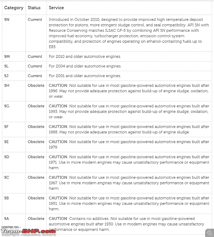

Originally Posted by puneetakhouri (Post 4601132)
........ but I am not too sure about the SL vs SN thing.
For a layman, these are grades given to various engine oils by the API(American Petroleum Institute). SN is more updated and advanced classification wise than SM or SL. Older Maruti manuals recommended as ancient as the SC grade.
Link: https://www.api.org/products-and-ser...s#tab-gasoline
Regarding the engine oil cost, this is what I've deduced after discussion with several in house oil experts. OWXX grade can only be formulated using synthetic technology. Secondly, wider the viscosity range, costlier the engine oil. For example, 0W40 will be dearer than 0W20 oil. If you check your bill, I'm sure MASS has billed you for 0W40 grade oil.
