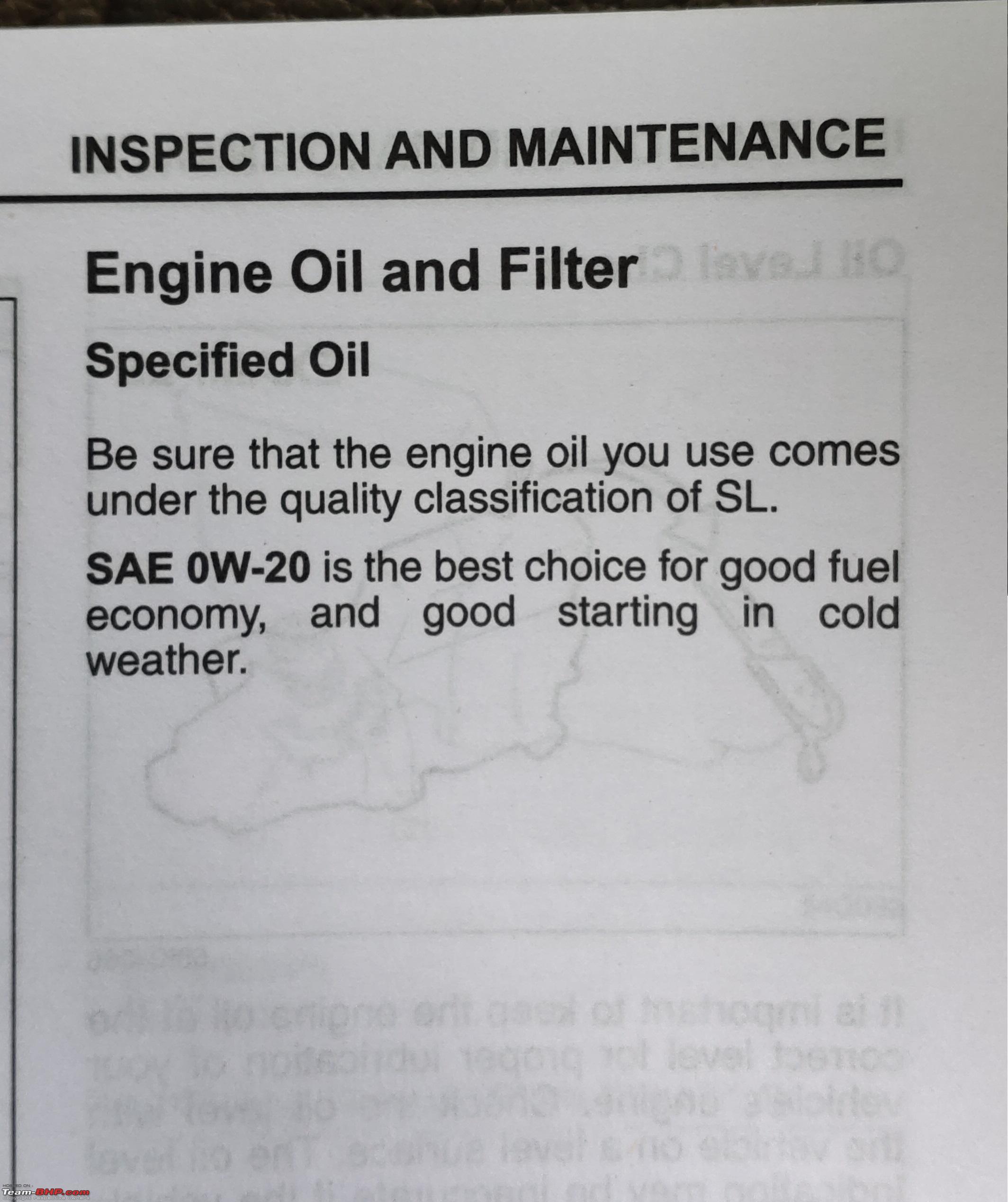

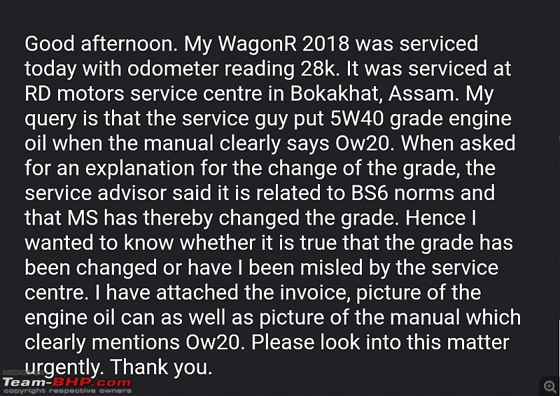

A friend of mine has a 2018 Maruti WagonR, which went for its 28k km service few days back. The service was done in a dealer run service center. They used 5W40 grade engine oil, whereas the manual recommends to use 0W20 engine oil. My friend did ask for an explanation. The SA told him that for BS6 norms, Maruti has changed the engine oil grade :uncontrol.
I of course didn't believe in what the SA told my friend, so asked him to write a mail to Maruti customer care explaining everything in detail. He wrote an e-mail to Maruti customer care. Next day he first received an e-mail (from Territory Service Manager, Guwahati region) that his matter has been forwarded to the concerned department.
After that he received a call from the same person, that guy told him that they are allowed to use 5W40 grade oil as well, despite what the manual says. I always thought Maruti customer care was best, now it seems it's not the case. A service center filling more expensive oil is common, but I was expecting a better explanation from Maruti customer care. What would you suggest we do? The car in question is still under extended warranty.

The Engine oil grade that the manual specifies:

The mail my friend sent:
The reply he got:
If you aren't happy with the oil and reply, reply to him in clear words that you aren't happy with the resolution provided, and that you see it as a clear case of inflating the bill without consumer consent. Also write in mail that you would like this to be escalated to his RSM(Regional service manager) and except putting correct grade of oil, there is no solution which will be acceptable. Be firm yet polite.
TSM is the first stage of seniority and you can always escalate it to RSM and beyond.
