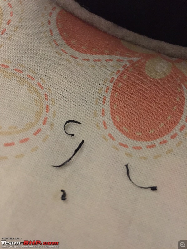

Solved: VW Polo GT TSI power drop after service! It was the air filter-img_4258.jpg
Solved: VW Polo GT TSI power drop after service! It was the air filter-img_4257.jpg
And the following pieces of plastic are dangling inside the filter. I hope such plastic pieces don't get into the engine.
Solved: VW Polo GT TSI power drop after service! It was the air filter-img_4259.jpg
That's great that you found it. From that page, I came across the filter costing a bit less and its OE too:
https://boodmo.com/catalog/part-air_filter-4427300/
Regarding the pieces of plastic you found, this is not surprising to me as I have previously experienced the substandard quality of VW India's localized parts.

Originally Posted by tilt View Post
I had brought up this issue with the service manager at Palace Cross Rajaji Nagar. He mentioned to me that the previous day they had been in a long meeting about this very thread; and that they had tested two cars, one with the new filter and one with the original; and that they had found absolutely no difference in the performance or anything else.
He also said that the matter had been escalated to VW India and that they are awaiting their feedback.
Until now I have not heard back from them. However, I am not placing much hope on their agreeing with the opinions expressed in this thread because it is advantageous for them to not do so.
I called him just now. He said VW got back to him a few days ago saying categorically that there was absolutely no difference at all on any measured parameter between the two filters. He also told me that the TBHP member who made them escalate this and tested it with them has been apprised of this information.
Well, this is precisely what I expected them to say.
