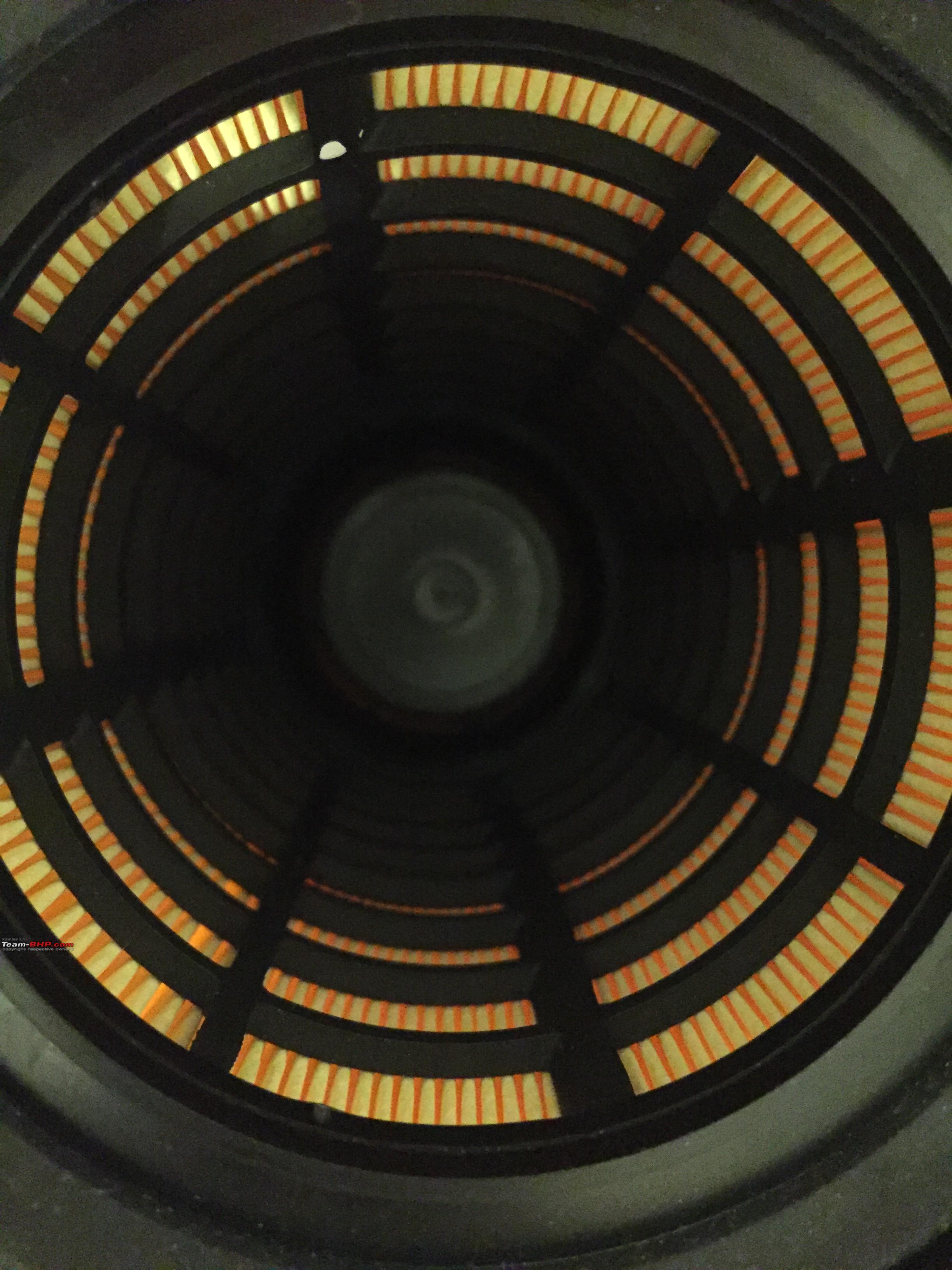

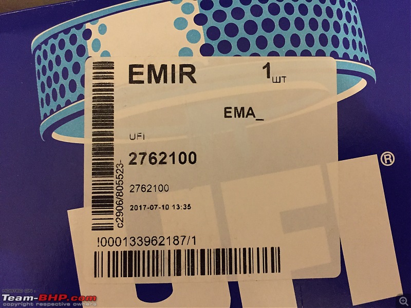

The Boodmo shipment has arrived. Its the original UFI filter made in Tunisia.
This long weekend of Independence day is testing time for the new filter.
Some pictures below.
Solved: VW Polo GT TSI power drop after service! It was the air filter-img_4455.jpg
The Tesseract

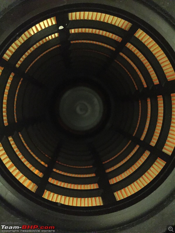

Solved: VW Polo GT TSI power drop after service! It was the air filter-img_4454.jpg
Solved: VW Polo GT TSI power drop after service! It was the air filter-img_4452.jpg
The UFI equivalent part number + Made in Feb 2017

Notice the little notch on the fibre material. The fibre material on this new UFI is softer(same as one that came with the car) and when you blow on it, you can feel the easy flow of air on the other side.

Yes finally I did. Installed the UFI filter that arrived from boodmo. The car performance is back as ever. THE-TSi-GT. Same power, thrust and torquey feel which I had when I bought the car. The fuel used to test was normal shell petrol. Not V-power. Took it to NICE road in Bangalore and drove a long stretch to convince and conclude myself. No more antics of filter changing and comparison. I'm glad that the effort bore fruit.
