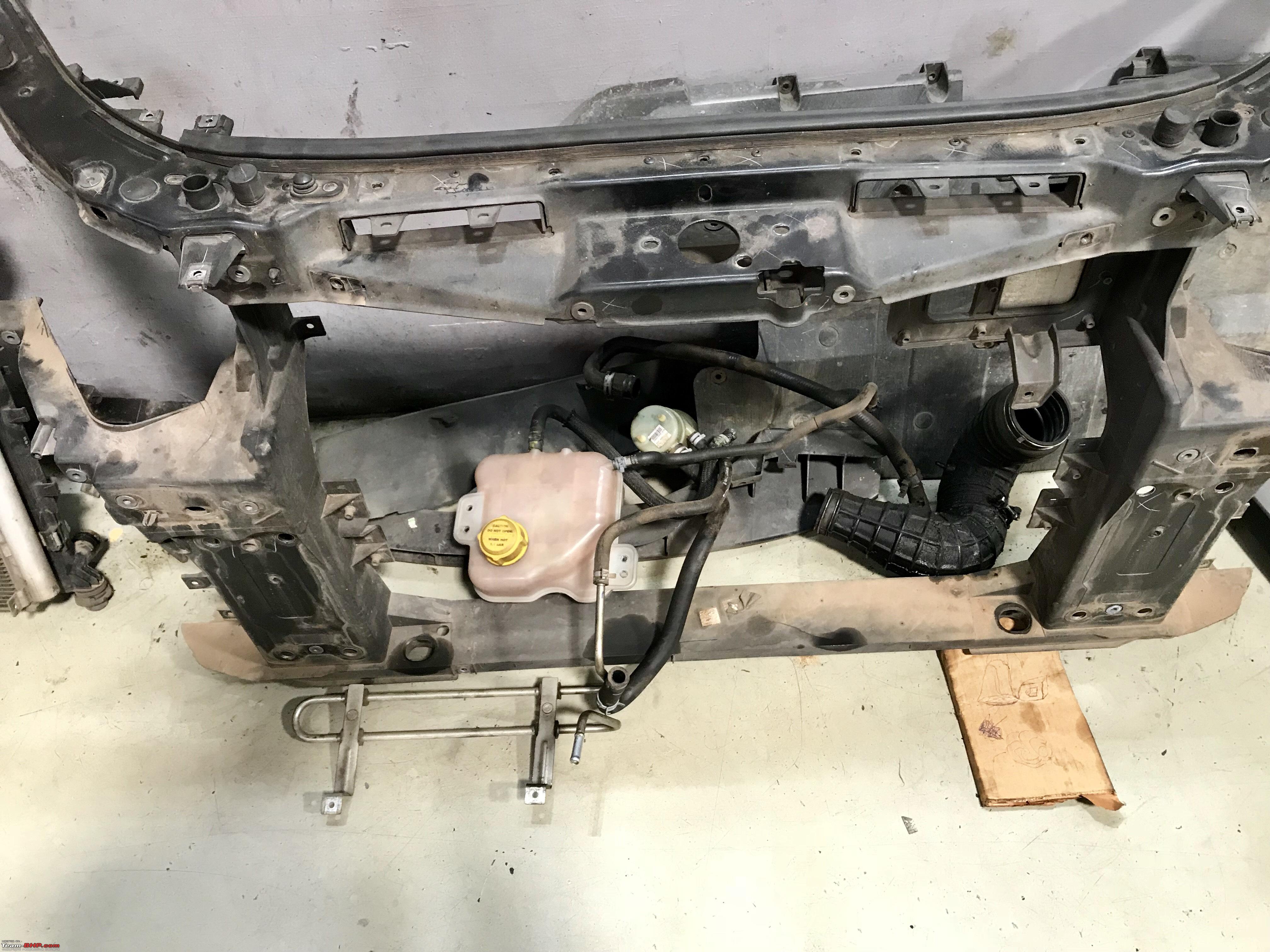

Without delay I drove down to the Service Center to see that
My Mahindra XUV500: Engine overhaul required-7.jpeg
Yes the engine has been removed.
My Mahindra XUV500: Engine overhaul required-8.jpeg
The parts of my car around their garage.
My Mahindra XUV500: Engine overhaul required-9.jpeg

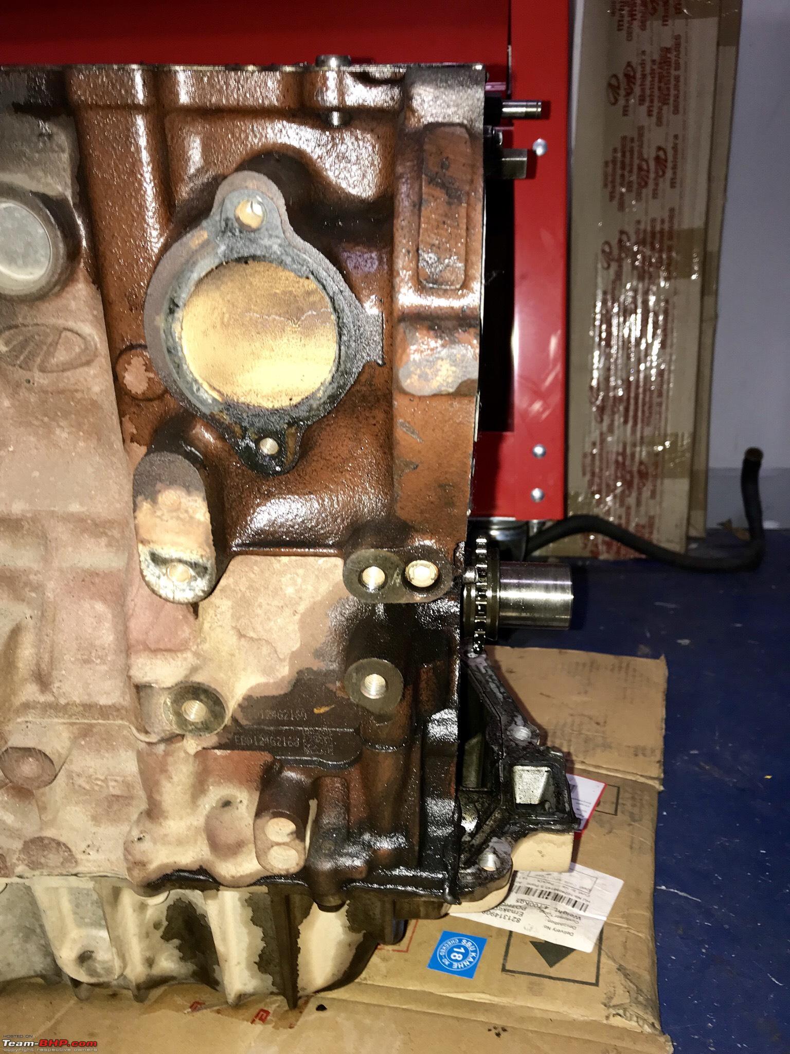

And of course to my shock, the have removed the head from the block. On detailed interaction with the Mechanic, he told me that the Gasket will anyway have to be replaced and told me that we might need to look at the piston rings given that we have removed this up-till here.
My Mahindra XUV500: Engine overhaul required-10.jpeg
I do not have any other option that to get my car mobile the soonest, and now since they have dug it this deep - I assume the piston ring replacement should do the job. However, I assume they may not need the whole 4 sets to be replaced which should be around 18K in total.
But on a detailed interview with the Mechanic - he said there were only 2 areas for the leak - 1 TurboCharger and 2 from the Chains.
My Mahindra XUV500: Engine overhaul required-11.jpeg
You could see the wetness in this area where the leak was. As suggested by Dhanush - still not convincing for a 4.5 litre leak.
The dealer looks like is playing me to make the money out by getting the work done. While I try to convince that I may not have the financial capacity to pay for the bills.
I hope the work would only include the Gaskets, and a pair of Piston Rings.
There was another XUV5OO which is getting an examination done since there was leak from the Chains.
My Mahindra XUV500: Engine overhaul required-other-car.jpeg
