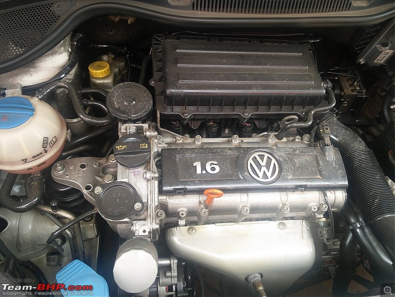

After 2 months of 3M rat repellent treatment:
Call it sheer luck or the effect of 3M, here are the results. Would give the benefit of doubt to 3M as footprints seen on the engine bay but no damage done yet.
It is the same situation with mine.
Got the coating done almost 2 months ago, but the rats still enter and leave their eatables around, but nothing damaged. I hope it remains like that since the car will be idle for 3 weeks next month.
