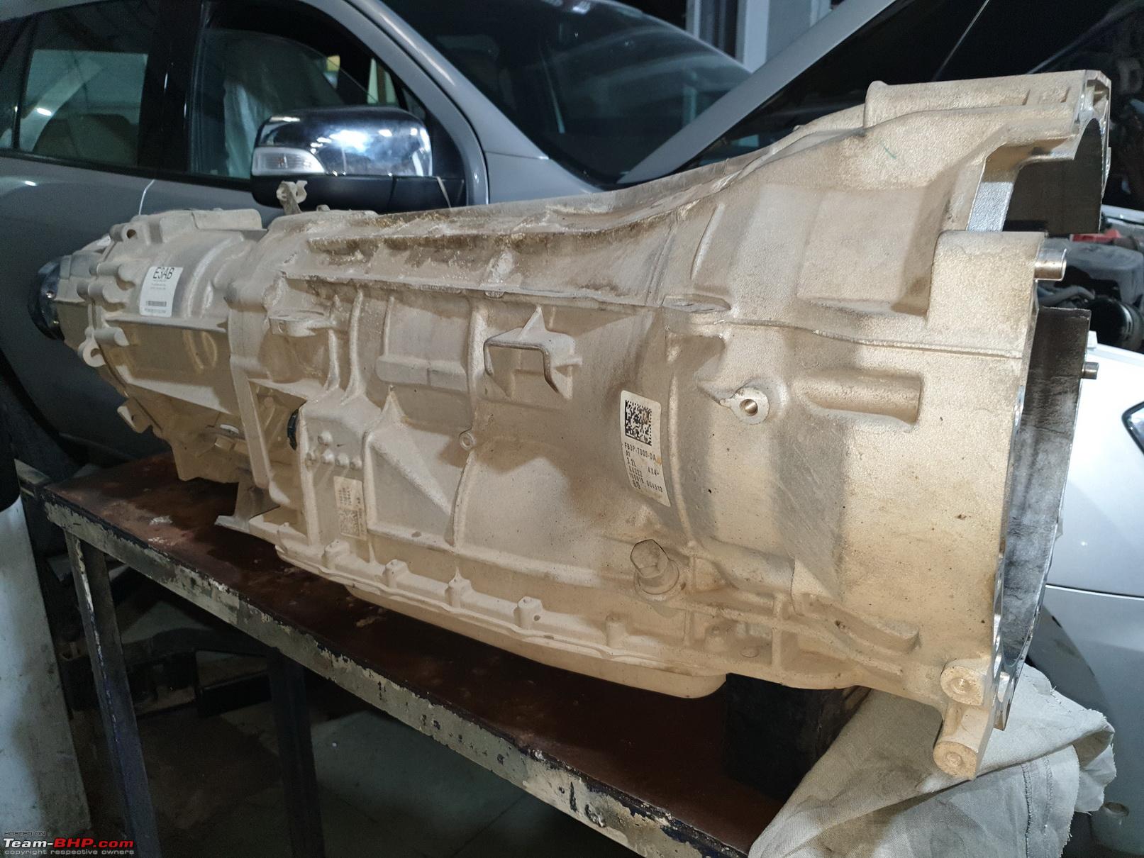

Ford Endeavour 3.2 AT - Gearbox failure. Recalled in other countries, but not in India!
Thanks to BHPian Mad Monkey who sent these images in. Heartfelt gratitude for sharing them with other enthusiasts.
BHPian Mad Monkey owns a Ford Endeavour 3.2. The SUV has suffered a failure of the torque converter automatic transmission according to Ford. The welds of the flex plates have broken off. The plate that connects the transmission to the flywheel. The vehicle has covered approximately 70,000 km and is under warranty.
Ford Endeavour 3.2 AT - Gearbox failure. Recalled in other countries, but not in India!-img20190812wa0002.jpg
Ford Endeavour 3.2 AT - Gearbox failure. Recalled in other countries, but not in India!-img20190812wa0008.jpg
Ford Endeavour 3.2 AT - Gearbox failure. Recalled in other countries, but not in India!-img20190812wa0013.jpg
Ford Endeavour 3.2 AT - Gearbox failure. Recalled in other countries, but not in India!-img20190812wa0015.jpg
Ford Endeavour 3.2 AT - Gearbox failure. Recalled in other countries, but not in India!-img20190812wa0017.jpg

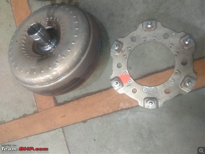

The flex plate:
Ford Endeavour 3.2 AT - Gearbox failure. Recalled in other countries, but not in India!-img20190812wa0004.jpg
The same problem has been reported on 3 cars previously at Bhavna Ford itself.

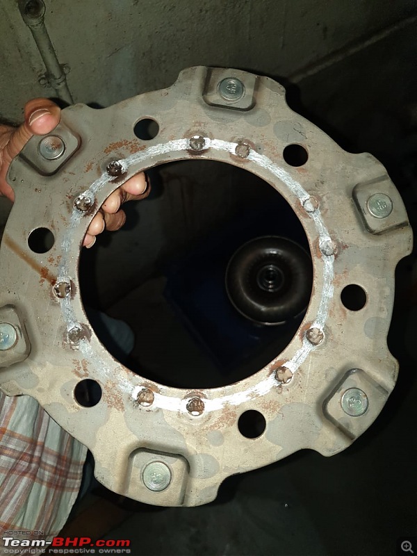

Another Endeavour in the workshop with the same problem. This has 50,000 km on the clock:
Ford Endeavour 3.2 AT - Gearbox failure. Recalled in other countries, but not in India!-img20190812wa0018.jpg

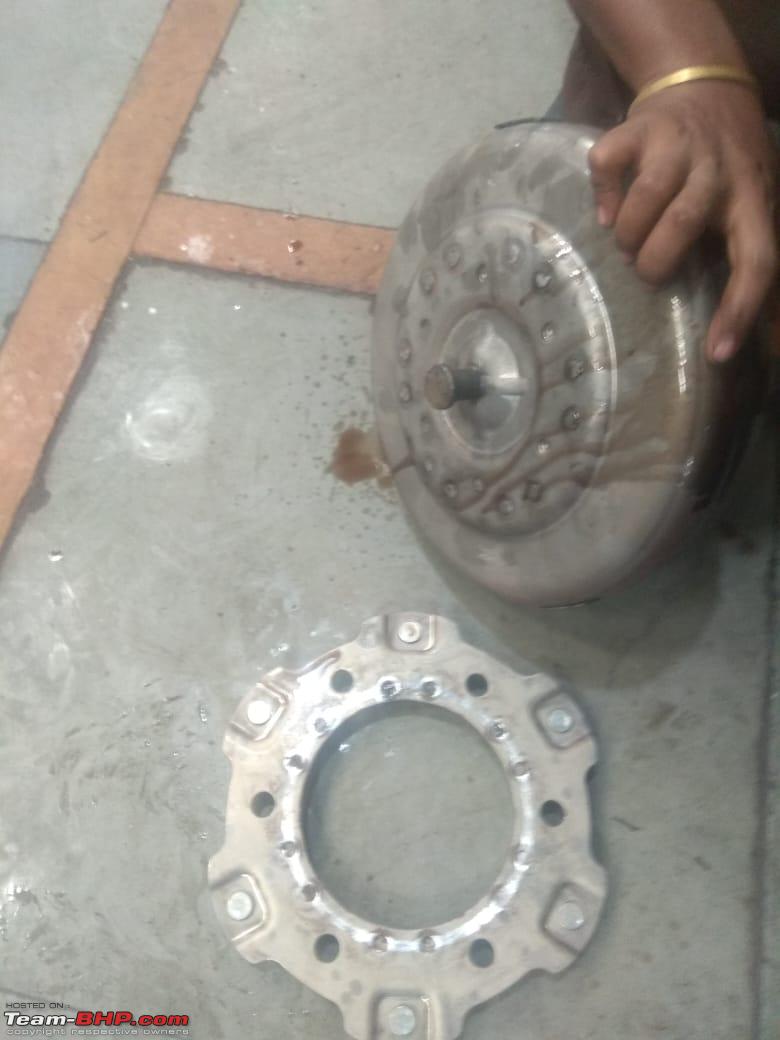

Torque converter removed:
Ford Endeavour 3.2 AT - Gearbox failure. Recalled in other countries, but not in India!-img20190812wa0005.jpg
Ford has offered Mad Monkey Rs. 2,000 as daily taxi fare. He has to submit bills for the same for claiming the amount.

Just google torque converter maintenance, and flex plate issues are commonly discussed on many forums, not just Ford but even Toyota.
In case of an accidental momentary mis-alignment, or a condition where a vehicle is stuck, and torque converter has heavily multiplied the torque to get out.
A broken flex plate has at best saved you transmission damage, or at worst saved crankshaft oil seal from lateral stress.
Driving habits that stress the flex plate
1. Coasting to a stop in N
2. Reeving up in Neutral
3. Shifting to P before you have completely stopped.
4. Throttling hard immediately after engaging D from N common bad habit with stoplight racers.

Bhavna Ford took a day to remove the transmission.

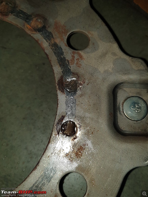

Next day i was informed that the Welds/rivets of the flex plate had broken off causing the torque converter to disconnect from the gearbox.
I paid a visit to the workshop and inspected the Flex plate.
Gearbox removed And kept besides the Endeavour and the bell-housing was covered with a piece of a an old rag.
Ford Endeavour 3.2 AT - Gearbox failure. Recalled in other countries, but not in India!-20190809_154459t.jpg
The Flex Plate with the defect
Ford Endeavour 3.2 AT - Gearbox failure. Recalled in other countries, but not in India!-20190809_155433t.jpg

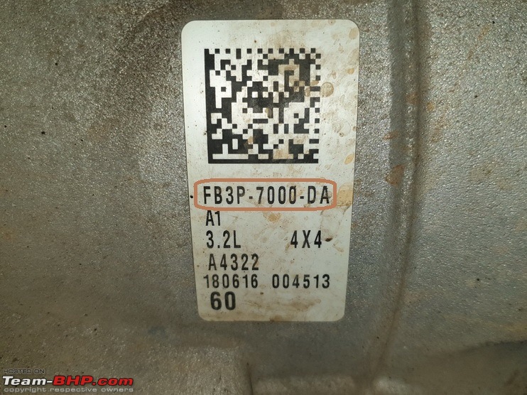

The transmission in my Ford Endeavour 3.2 AT is most probably the same transmission that Ford has recalled in the USA and stopped the sales of in Australia .
Could It be a coincidence that the transmission in my car was made and imported from the USA ?
Part number as found on my transmission.
Ford Endeavour 3.2 AT - Gearbox failure. Recalled in other countries, but not in India!-20190809_154506t.jpg
Import Details into India for same Part Number
Ford Endeavour 3.2 AT - Gearbox failure. Recalled in other countries, but not in India!-ford-endeavour-india-transmission-import-details.jpg
