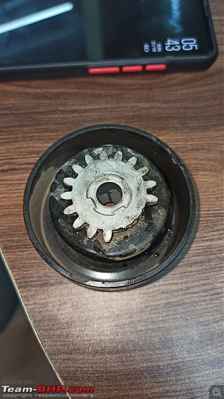

I own a SAIL UVA petrol, it's a second-hand car which I bought from an online car platform, the car came with one year warranty and it has been almost a hassle-free ownership for ~18 months
Chevrolet owners, how is the spare parts availability & service since GM left India?-borken-tensioner-pulley.jpeg
Tensioner Pulley

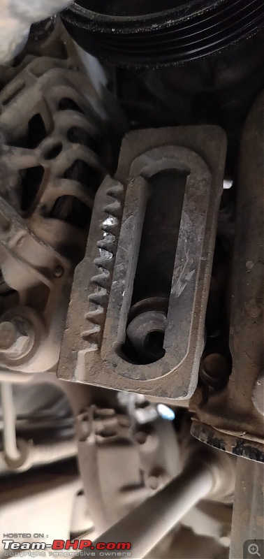

In a recent servicing, I got to know that the tensioner of the car needs to be changed, I got that order through Trident Chevrolet in Bangalore but when the car got opened for replacing the tensioner pulley it was found that the bracket also needs a replacement
Chevrolet owners, how is the spare parts availability & service since GM left India?-broken-bracket.jpeg
Broken Bracket
Now finding the bracket has become a 'finding fanny' kind of adventure:surface
The GM doesn't have it in stock, Boodmo has been sitting on the order for 15 days and says they are trying to source it
desperate me did some research ( visual ) and believe the tensioner bracket of Beat Petrol and Sail UVA petrol looks to be very same and might solve my problem because that bracket is available with GM and Boodmo
1. Listed for SAIL UVA
https://boodmo.com/catalog/part-bracket_gen-38464772/
2. Listed for Beat Petrol - 1
https://boodmo.com/catalog/part-bracket_gen-39693305/
3. Listed for Beat Petrol - 2
https://boodmo.com/catalog/part-bracket_gen-38467114/
I tried confirming it with the mechanics but they aren't very sure of it,
is there someone here who faced a similar problem and if you could pls suggest a way forward from here pls _/\_

For cars that have stopped production, your best bet is to be best friends with aftermarket parts suppliers. I have a Fiat Palio 1.6 Sports myself and love the car. I have the same issue and I have a 5-10 phone numbers to call incase I get stuck with a part issue.

Sure @dhanushs trying that too, but no luck yet - Boodmo just moved the expected delivery day again
Now I have requested Shiva @ trident Chevrolet to order the bracket of Beat Petrol and we would give it a try - wish me luck

Indeed he is a very helpful one, He did try to get for UVA but the company doesn't have inventory so he is unable to get it
To him also the bracket of Beat Petrol looks similar to UVA so he has agreed to give it a try!
I was just wondering if any other UVA owners tried using Beat spares / the bracket or Any pro on chevy spares among us who could help answer this

If you have already sourced the tensioner, you may as well fabricate the bracket in a machine shop. Will be done in one day. Worth the few hundred extra bucks.
