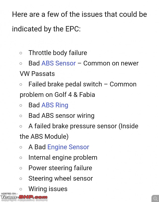

I have never even driven a VAG car till now, but from the various gremlins that are popping up like the dreaded EPC error (in a very erratic fashion), ORVMS having a mind of their own etc, I have a feeling the issue is not mechanical but electronics or electrical based. It could most probably be a critical sensor(s) that is faulty or the Car's computer overreacting to a specific combination of sensor inputs that occurred while driving or maybe even a wiring issue.
Did a basic google search and got a list of reasons that can caise EPC error.
It seems that any issue related to the Engine and specifically power delivery as well as Braking/steering can cause EPC error
